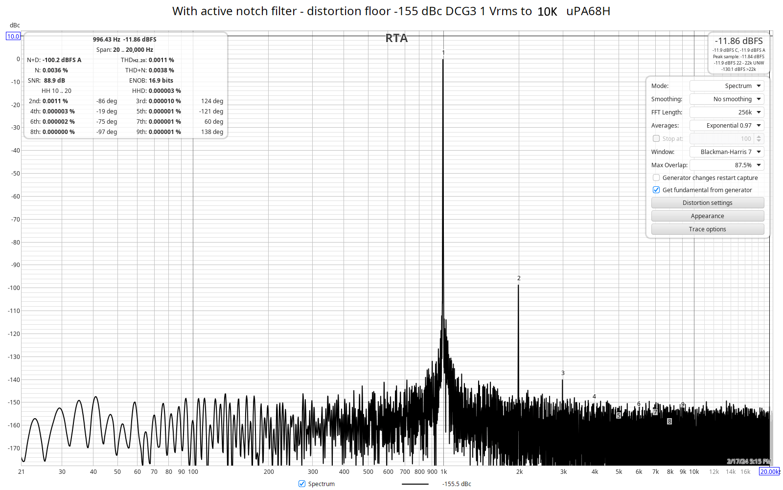

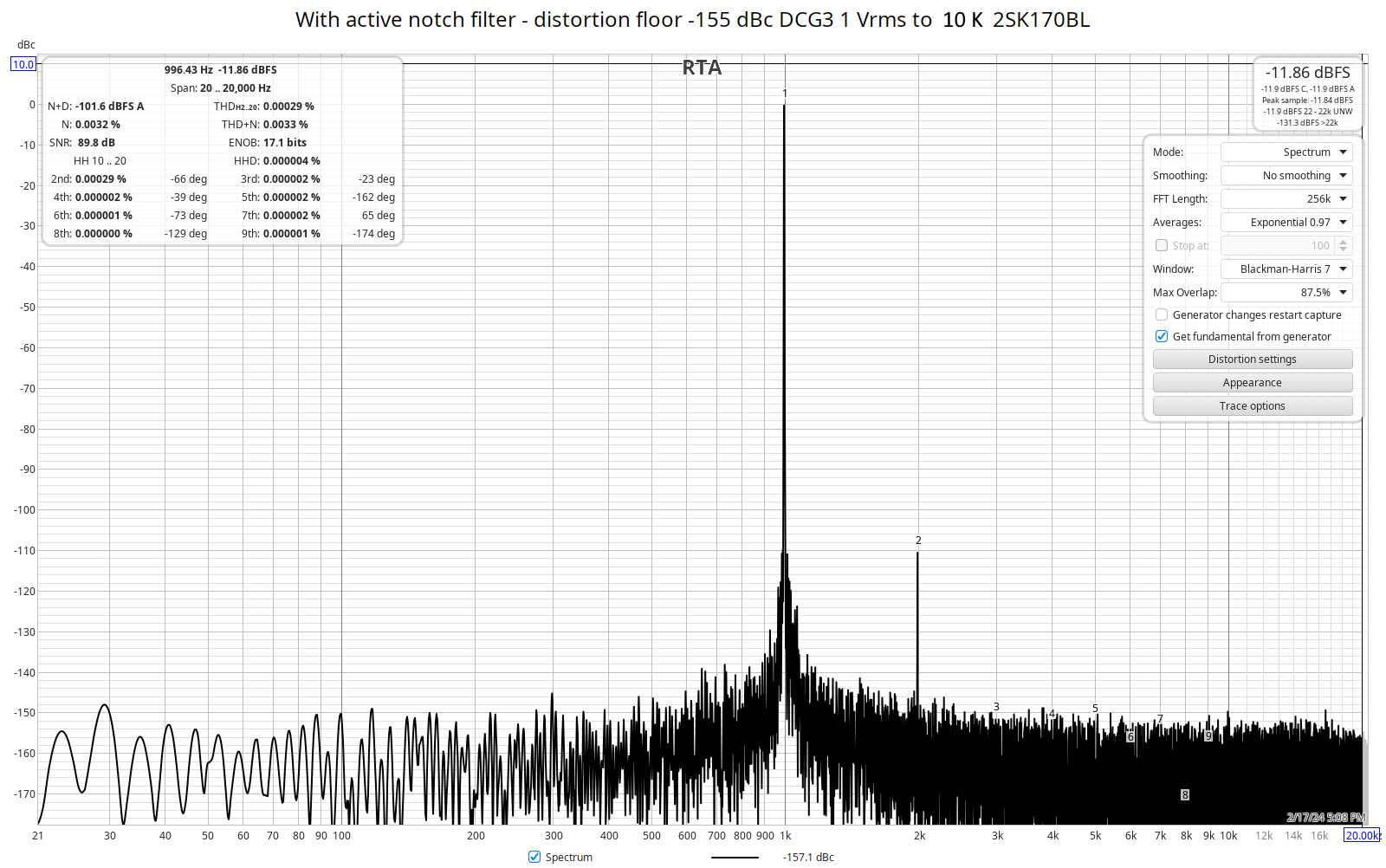

If anyone wonders why DCG3 is very high on the best preamplifiers list, look at the distortion into high impedance, like at amplifier input. At 1 Vrms, there is nothing but pure H2 at very low level and then nothing even 40 dB down at any audio frequency. If that’s not amazing, then I don’t know what is.
For this measurement, I bypassed Muses volume control at DCG input, as it also contributes some distortion.
Reactions: 10 users
I very much like the sound of this amp, and have one on my desk now as my headphone amp. I used its circuit to become familiar with using LTspice for audio circuits. At first I thought it was an artifact of Spice when I noticed that reducing the input resistance also reduced the distortion. However, Salas does note that the sound changes as one changes the value of the input potentiometer. I came to understand that what I was seeing in simulation was the Miller effect, and that is also what is being heard with changes in the effective input resistance as one changes values of the potentiometer. It would be interresting to see what distortion you measure with the Muses in circuit, not just at 1K but also 10K or 20K.

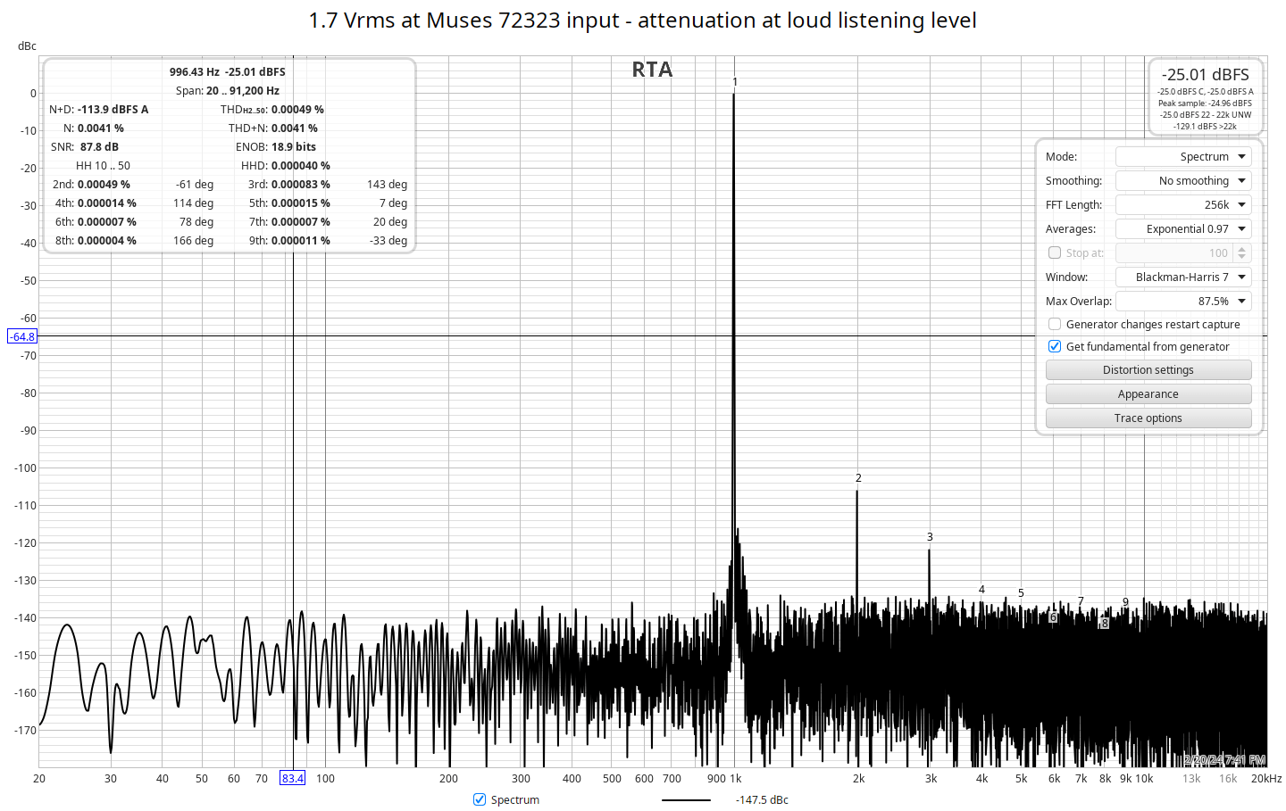

Joined 2019
I have only 1 kHz signal sources with extremely low distortion.
Measurements at post #6943 are with Muses volume control. Muses has distortion at the same level as DCG3, but with some higher order harmonics (still 30 db below H2, with exception of H3).
At normal attenuation levels, all that high order distortion is buried beneath DCG3 noise floor. Example:
There is no way I would ever return to any passive potentiometer volume control. Muses provides perfectly aligned L+R control, remote and balance control. I really appreciate that with volume change, soundstage doesn’t shift in any direction and 1 dB imbalance is easily heard.
AFAIK, potentiometers have imbalance 1-3 dB over various control range positions and they introduce comparable distortion levels as well.

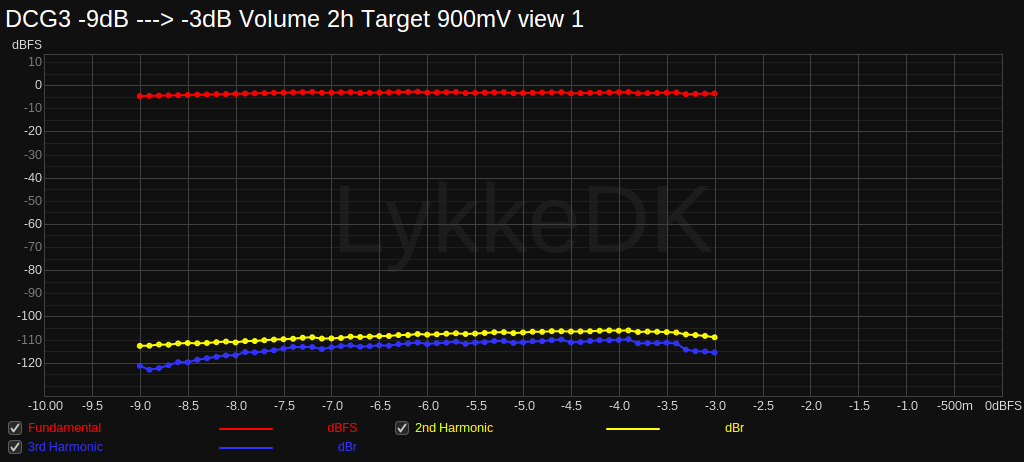

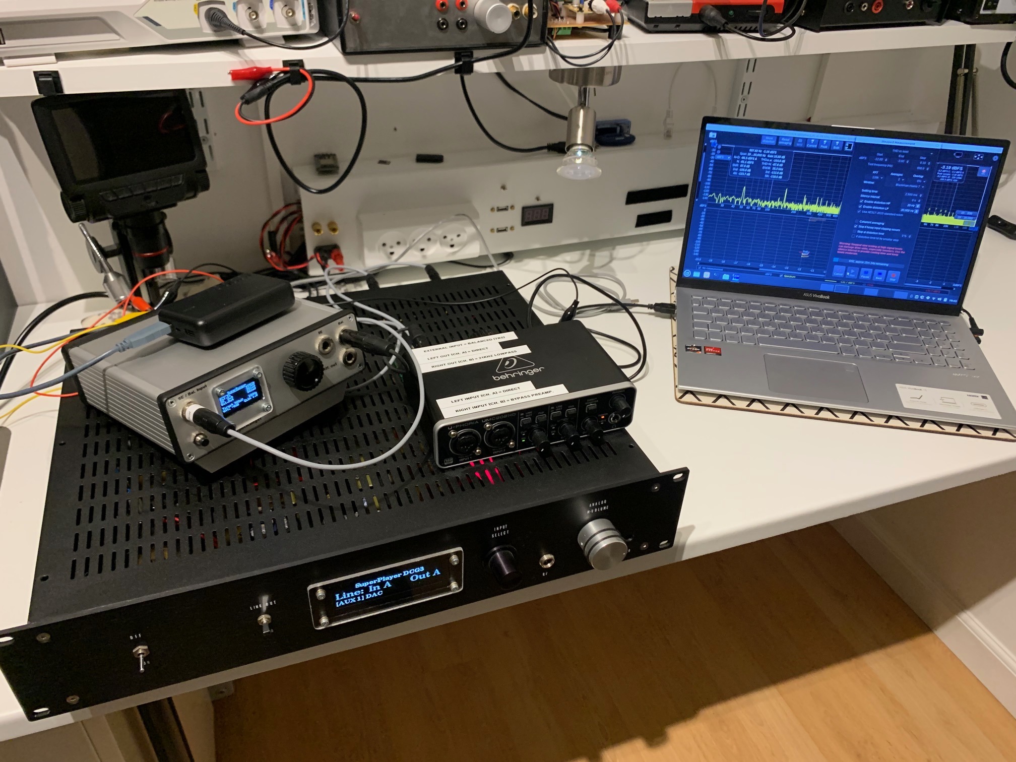

Hi here...
I saw in post Here!, that Salas posted some THD stepped measurement's...
Just today I changed some code in my DCG3 ESP32 (Arduino) controller, so to remove some nasty spike's created when the ESP32 cpu is running >40MHz or so.

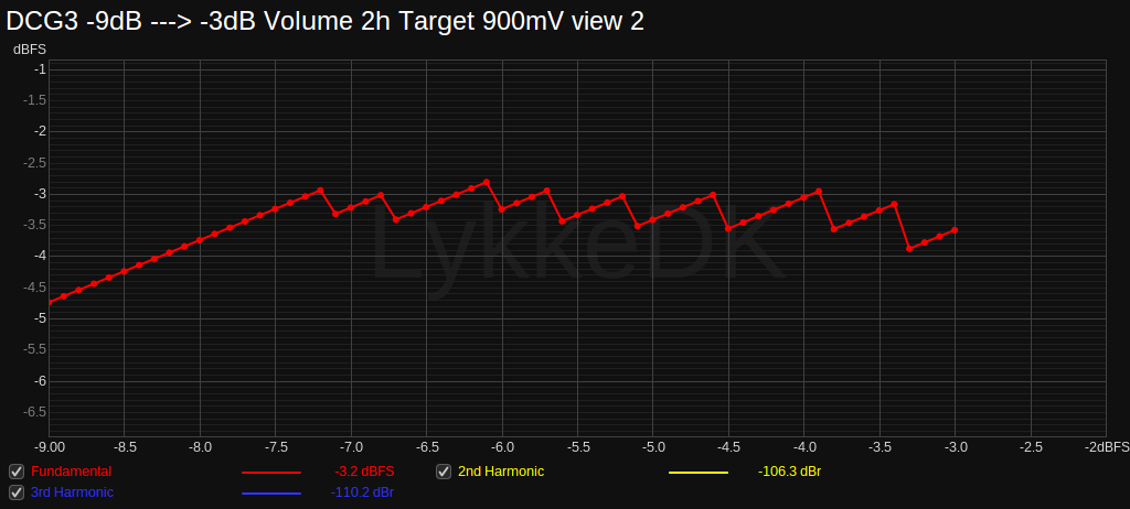

I took a THD vs. Level sweep from around 500mV to 950mV (-9dB ---> -3dB) loaded with around 20k (My diy autoranger) Volume at around 2'Oclock
My DCG3 is build in 2016, still going strong having lot's and lot's on hour's on it's back now :cool:
THD's are deepdown as can be seen - The noisefloor on my autoranger/soundcard is lower than -140dB so measurement's should be good.
Zooming in the same picture, shows the gainsteep's in my SuperRanger (Autoranger).A close -3dB match is archived (target 900mV into my hacked Magicbus Behringer)
So a good measurement with the Behringer's best level is archived.
Just a picture of my setup in this situ.
Jesper.

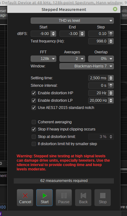

I asked John the REW owner :) to add some settling time in REW for stepped measurement's and autoranger's and other slow stuff.
And between Christmas and Newyear 2023, it was added in the build.
Before that, an autoranger had to be very very fast to archive good results...
I just adjusted it to 2,5sec. and took a shoot, and the autoranger behaved nice and easy during the test.

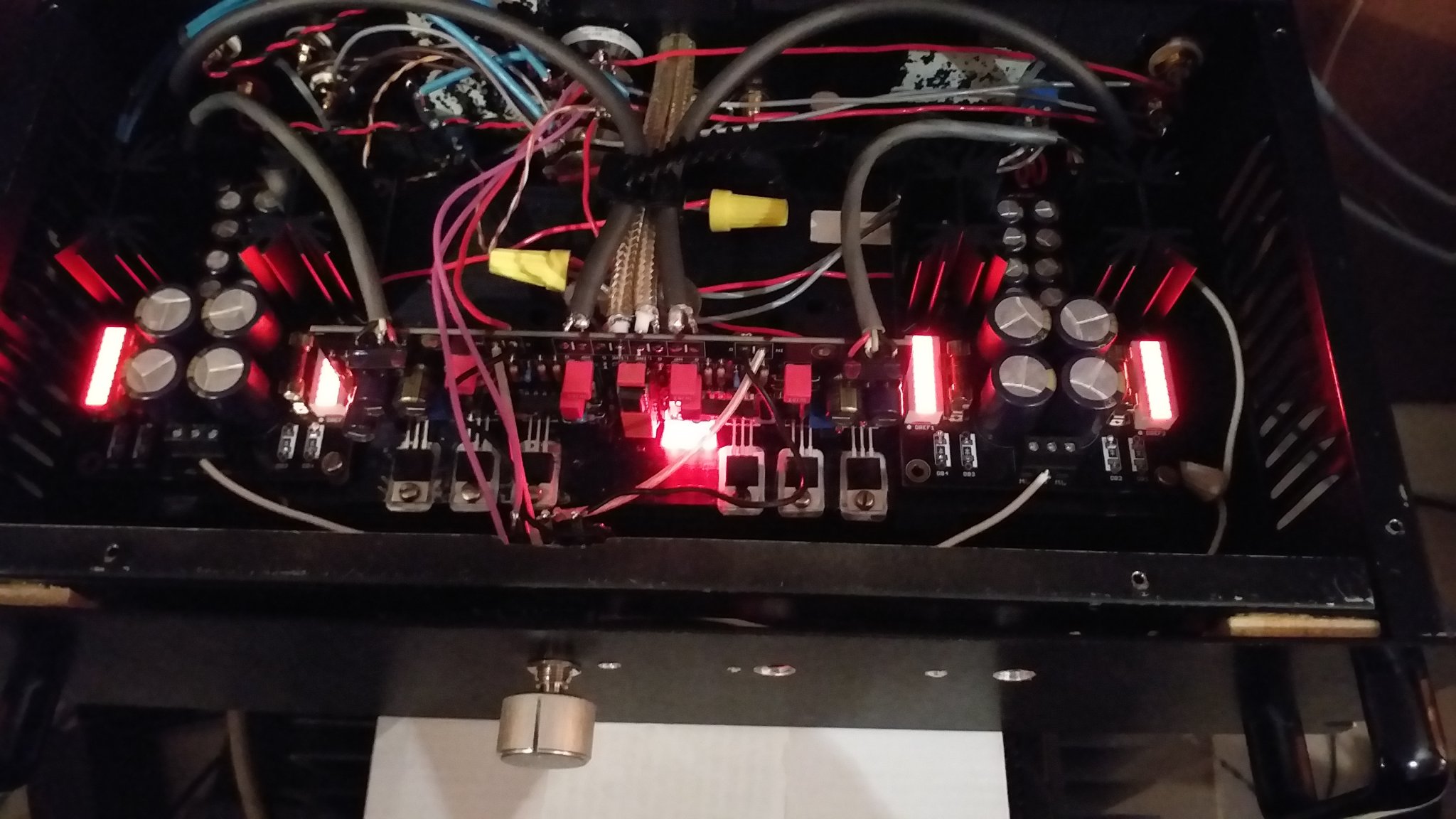

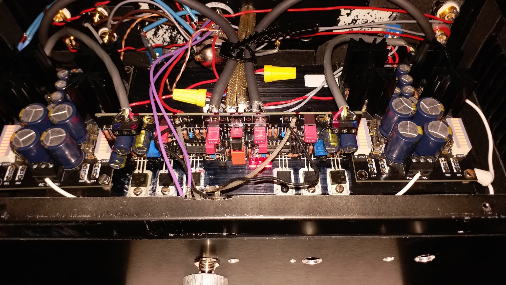

Hi Salas,
I am skittish about showing pictures of my DCG3 cause my setup is messy and I didn't use coax wire connection as per your instruction. I have a hard time sourcing Mogami wire from Canada. So instead I use Discovery and VDH hook-up wires.
Also, my PS (raw DC) is 3 ft. away from the main casing and is on 24/7. I use a toggle switch to control/switching the +/- rail. I hope you are not too upset about this improvisation. I remember you suggested using the LED relay for on/off function, but that would mean de-soldering the LED from the DCG3 board and I am worried about making mistakes during the process.
BTW The casing is a leftover from previous project and that's why you see all these extra holes and scratch marks on the front and side wall. Anyway, have a good laugh and feel free to comment.
