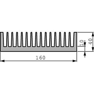

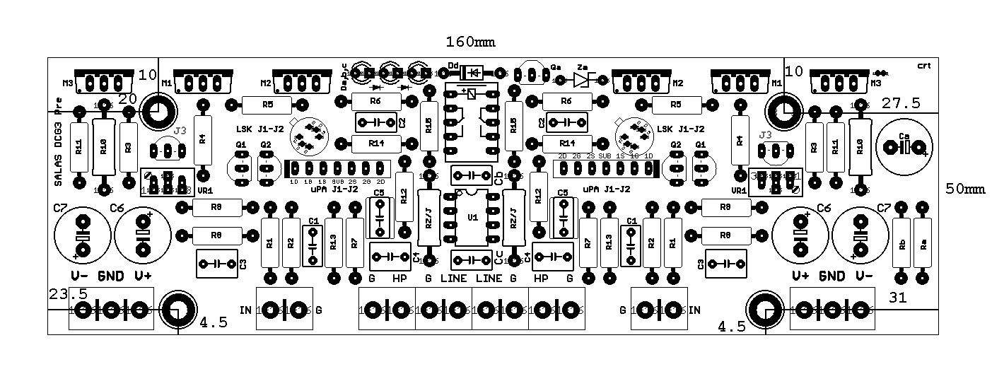

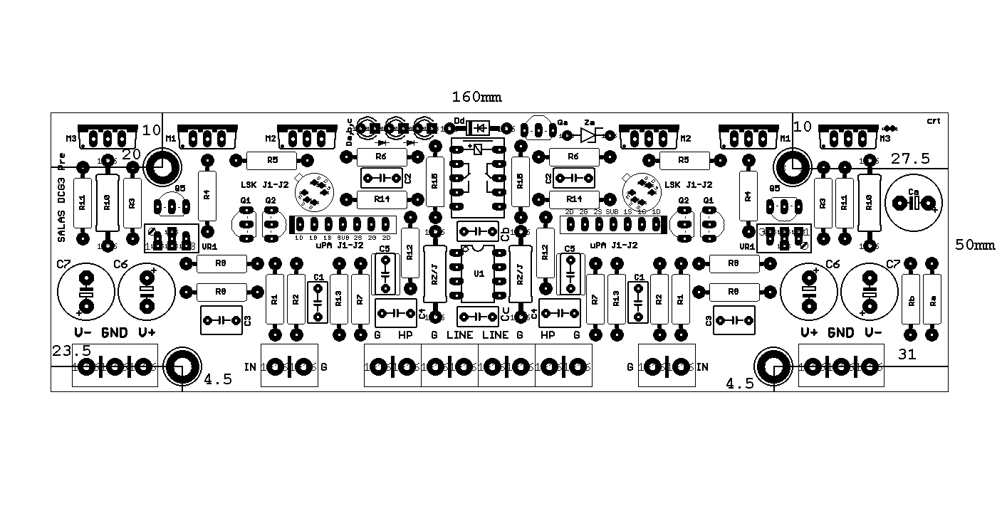

These are the dimensions:

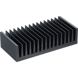

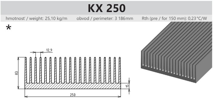

Dissipation is 10.2W at 150mA +/-17V for two channels. No worse than 1C/W (K/W) sink for 10C rise above ambient should be used. That's in free air and optimally oriented. Expect higher rise when boxed. Ventilation holes should be in vicinity. For mechanical stability & heat transfer the sink should be bolted in touch with the chassis. Apply thermal paste between their meeting metal surfaces. An adequate example sink type:
Fischer SK 85/100/SA
