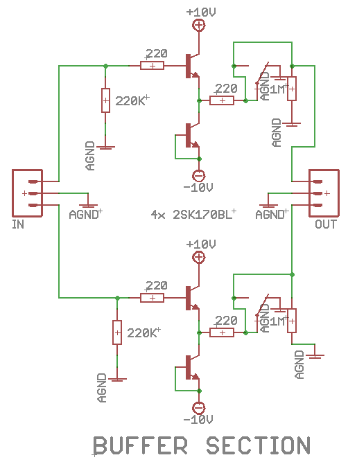

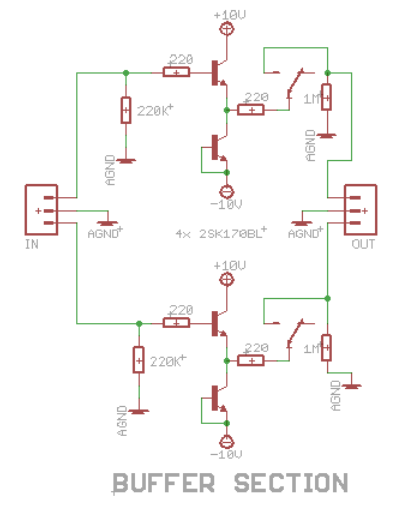

There were two output relay connection arrangements in Hypnotize. The first one or two batches used no connection during rest (power off) and further batches used ground connection. Here are both gen buffer section schematics. You can use them to verify if your relay function is in correct working order.

If I read the diagram right, there should be a dead short between output signal and ground with power off and 1M with power on when jfets are out.
I will recheck the results with the power on and the jfets out on one channel. That will verify one channel in the relay.
In post's #5887 second schematic compliant boards (majority) yes there should be a dead short across output when the power is off.
When power's on the relay clicks and the path formed when JFETS are in is as: OUT-->220R-->JFET internal resistance (RDS)-->PSU.

There is an added green trace between the 220R and AGND in version 2. In version one, the output from the jfets is connected to either the output pin or is left floating.
In version two, the output from the jfets is connected to the output pin when the power is either on or off, and is also connected to ground when the power is off, effectively shorting the input to the power amp.

When the unit is off and jfets out, I measure 0 ohm with probes on either side of the 1M resistor. That corresponds to the second drawing. When the relay is energized, the
