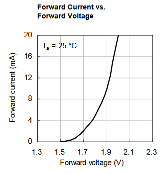

As I understand the red ones initially used had very tight forward voltage tolerance. Can someone please recommend which red leds that is most suitable?

Will the 2V compared to recommended 1,8V cause any issues?
They are 1.8V at 5mA. But the JFETs at their tail can vary per sample for IDSS current they will force through. No issues if they will give 1.9V each with stronger JFETs. Will be producing bit stronger rails overall. But still within the design's target range.

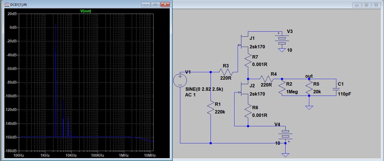

For degeneration purposes to bring down IDSS either for lowering dissipation and/or matching Id easier for a wider range of JFET samples. To tune THD also, at least when with a specific load value in mind.

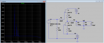

Just to further my understanding suppose in the case of the DCB1 I add two 500r resistors one at each Jfet source, I still get near zero DC offset, the Id is lowered so the Jfets run cooler, so whats the advantage here of running them at Idss?
Also, if I do not have closely matched Jfets, say Idss7ma for the follower and 7.5ma for the source I could degenerate the 7.5 to still get zero DC offset. Will this create a different THD profile as opposed to using two 7ma matched? Or is this an acceptable approach?
Thanks. nash
Running them at IDSS ensures max available current drive to the load and max transconductance. When you got the matched pair why compromise. See an example not with 0R vs 500R, which would be extreme, but with 0R vs 100R on 8mA IDSS K170s. Resulting to 18dB worse 2ndH at 2.5kHz 0dBFS CD output level on a 20kΩ input amp and some cable capacitance for the 100R degenerated version.
You could use small equalizing resistors for offset with a small hit in performance. Natural IDSS matching is best.

Salas,
I went ahead and actually tested them with and without source degeneration and I was surprised by how much higher the distortion was with vs without. Just as you said it would be.

Its not crucial to have exactly same idss pairs in channels. They can be say 9mA in L and 8mA in R. But if much different, THD measurements will noticeably change between channels. Especially at high signal levels.
There is yfs vs id chart in the Jfet datasheets. You want id pairs at a range where yfs is still comparable for use in the channels.
