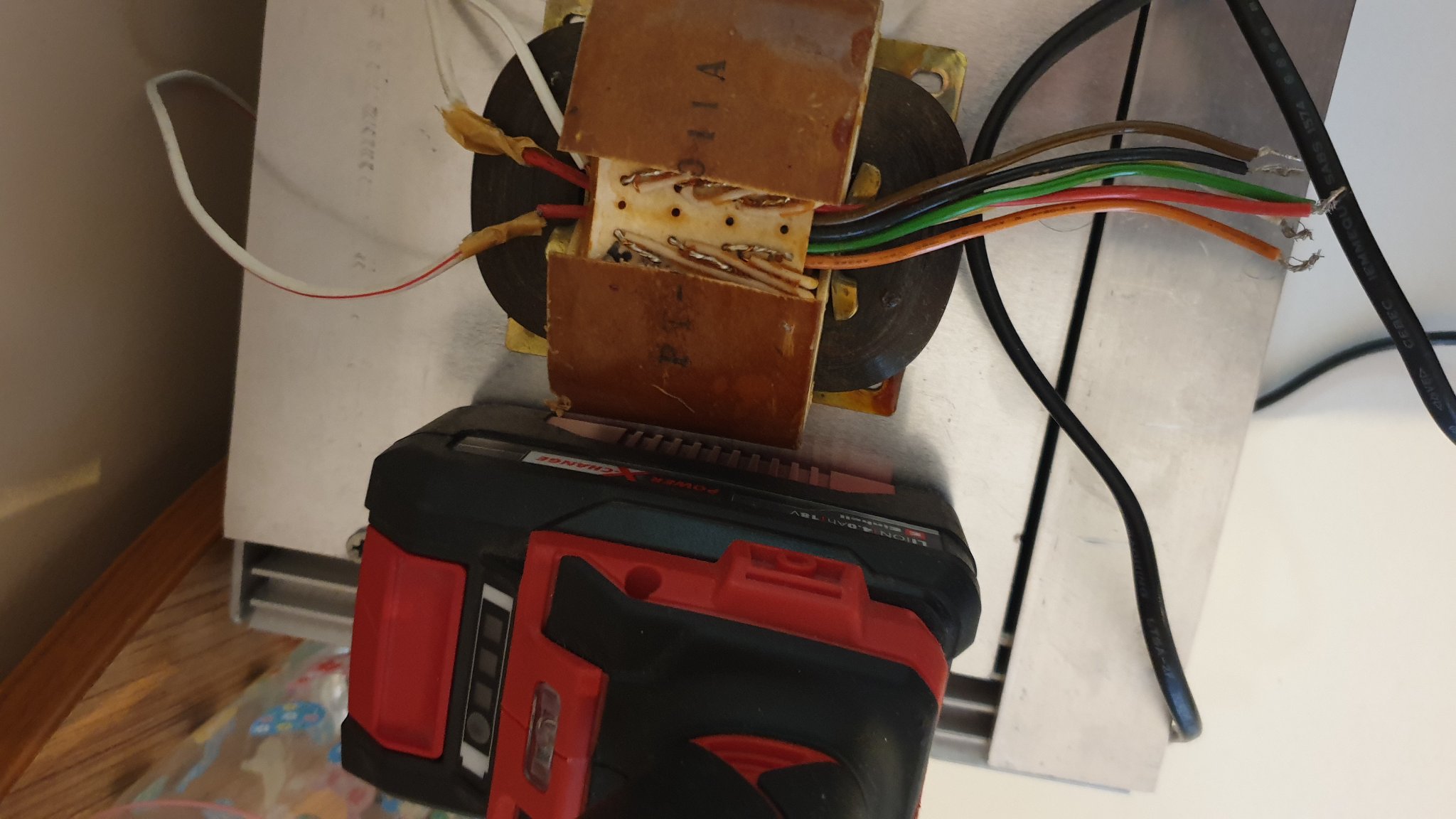

Hi. I have 6pcs of unknown R core transformers which write pt011a on them weight about 1kg and I think they are 60va. I measured them and they have about 22v CT AC on secondaries. When I connect 39r2 50w voltage drops to 42.15v from 44.74v. Can I use them as hot rod but for biamping. I want to use 4 channel. Should I connect 10R 10w non inductive resistors in series maybe it will help? And what mods should I do on standart board? Many thanks
22V-0-22V output transformers, correct?
That's unfortunately too high for DCB1. Wants 15V-0-15V at most.
Dropping with series resistors isn't as nice as having the right transformers since the resistors will dissipate heat and add impedance.
On the other hand because the DCB1 power section draws constant current its easy to predict the right secondary dropping resistors value and their power spec. PSUD2 should be very helpful to picture the situation.
AC-0-AC is the power input format of DCB1 stereo boards so you will need two CT transformers and two boards to have four channels.
Yes they are about 22v ct transformers. Sorry i do not have extra budget and want to use these transformers.I saw somebody uses 2x18v ac as transformers so i thought maybe i can also use my transformers by adding resistors in series . Is not 60va R core transformer enough to power 2 boards? 2 transformers may be better though.
