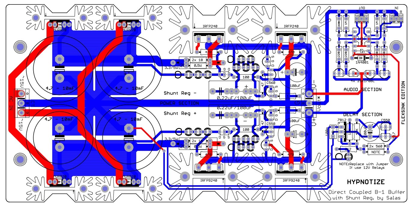

There is the Mezmerize in the DIYstore for sure. The classic Hypnotize is not available. Not sure if Tea-Bag still has few of the FlexSink Hypnotize rare beast boards available but you can PM him. That was my last edition of the Hypnotize theme. Flexible for onboard normal mode sinking or outboard heavy hot rod sinking. Here's a bird's eye view of layout so to aid your efforts.
Thanks very much Salas. The layout helps a lot. I have a pair of 2SK389BL, as well as a few 170's. Did wonder if the monolithic dual FET is preferable, as besides the closer match of the FETS, it may help with long term drift.

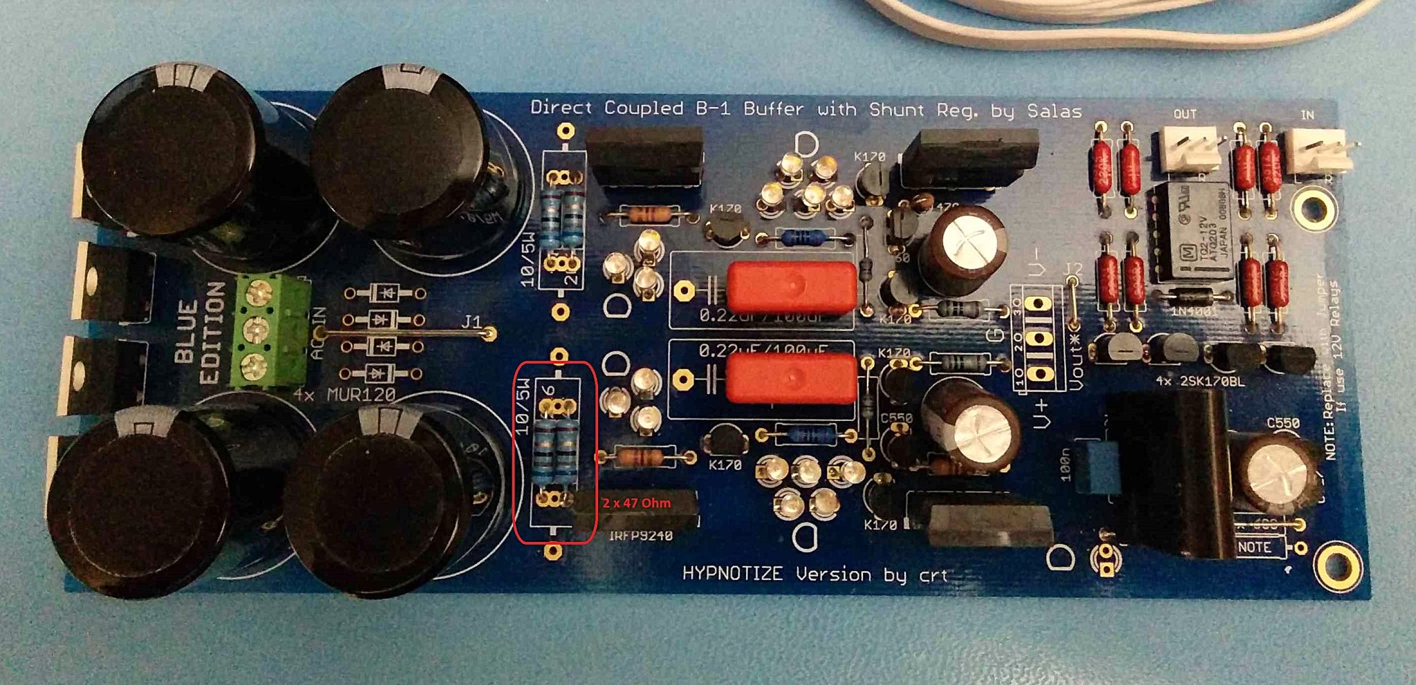

I just completed a DCB1/Hypnotize build I started many years ago (2011?). I believe it is the "Black Edition".
Unfortunately, there seems to be a problem. The LED triplets for both positive and negative voltage are not glowing (the series of 5 works).
I measured the voltage around Rset (10 Ohms/5W) them ~ 8.4V for both, which indicates a current much higher than the intended 600mA, so I have to switch off the circuit after approximately 30 seconds - before the resistors get too hot.

The main CCSs don't current limit for some reason. Since you checked its not due to the LED triplets (verify orientation against the theoretical schematic too), see if the associated nearby MOSFETs are the correct N or P type and not accidentally swapped for positive and negative side.
Also, what AC secondary value transformer you use that goes at 40V rectified? Seems high for the application if you mean one side raw DC rail measured and not across rails.
Thanks a lot. I finally found some time to check the orientation again.
The triplets were indeed not oriented correctly. I oriented all the LED according to the hole pattern (square, circle), while it seems that the "D" symbols indicate the correct orientation. The DCB1 one has been working flawlessly for some weeks now and sounds great.

I've purchased the board here from a DIY member. It seems that have 2x 47 Ohms to bias de PSU.Doesn't seem to be a problem. How many mA shunt reg psu bias you have set? Voltage drop across set resistor divided by its Ohmic value answers that.
