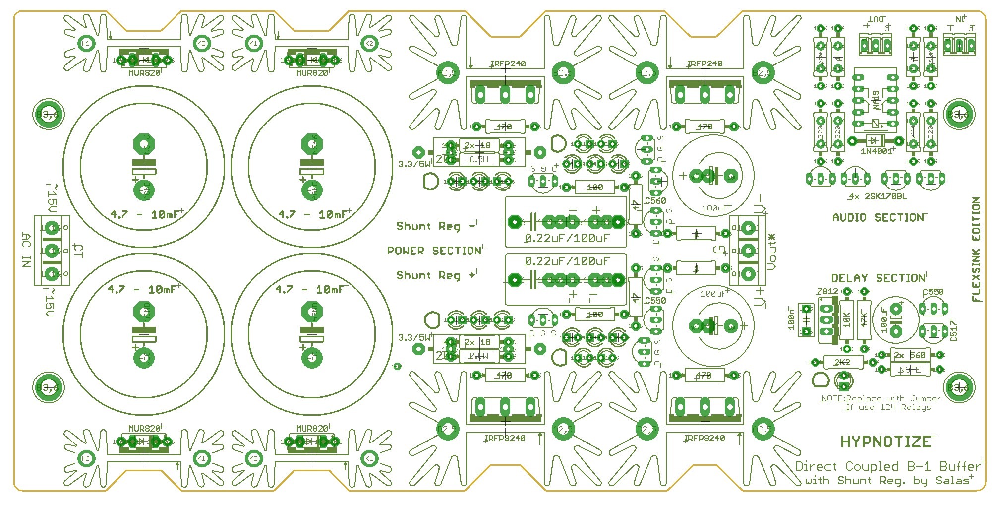

So attaching the correct ends together an connecting to the 0V/center tap position on the board and the other ends to the 15V position is just fine and the fact that the combined voltage would be 30V is good? That would be a major relief. I have all the data of the built transformer so wiring it correctly is not a problem. Toroidy has a great product and service.
It will end with ~15 0 ~15 (~30 end to end) and that is what's needed
Also good to mention that I ordered the new black board from tea-bag, but I suspect that doesn't change things in this regard.
No it doesn't change things in this regard. This new Hypno "Flexsink" board is about heavy duty hot-rod best versatile. Can be used conservatively with onboard sinks but also enhance sound quality if loaded with all four reservoir capacitors and cranked up to heavy bias with external sinks, but it doesn't differentiate AC/DC voltages spec.

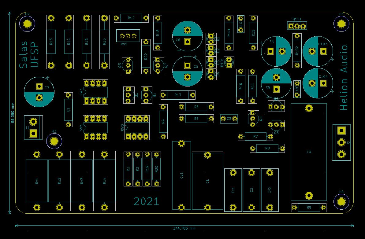

Salas, I am contemplating building the UFSP. Made the schematic and a take on a single sided PCB. But maybe I will go for 2-layer...
I have tried to follow your schematic as good as I can, but could you give it a glance to see if something is terribly wrong? Thanks!
Then about ground plane: is it to avoid on the project, or will it be a benefit?
Edit: Sorry, this came in the wrong thread!
Q3 is upside down? No, seems OK. Use of GP is alright.
Thank you!
If I decide to produce a proper PCB, how may I accnowlegde you're the author? Is there a Forum Etiquette regarding this? Here is how my PCB might look like (take 1, using big, low tolerance components I happen to have) 🙂
