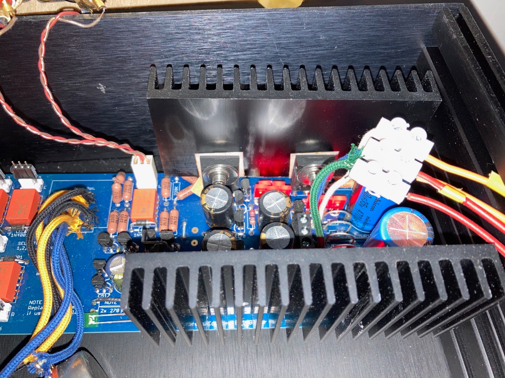

So my concern in planning my DIY chassis is the size of heatsinks.
The enclosure that I have planned is quite short ~55mm tall with the psu caps and potted toroid to come through the top panel valve amp style. The heatsinks will be 4or5 pieces the same along each side of enclosure all mounted together with angle and plate aluminium. From what I've seen it should be sufficient but I would like to see some more completed builds. I have been looking through the thread to find pics of completed builds to see specifically the kinds and sizes of heatsinks used on level 2 hotrods. I find many of the image links have expired (photobucket etc.).
Can y'all kindly point me to relevant post numbers showing pics of completed builds? 500odd pages is a lot to scan.

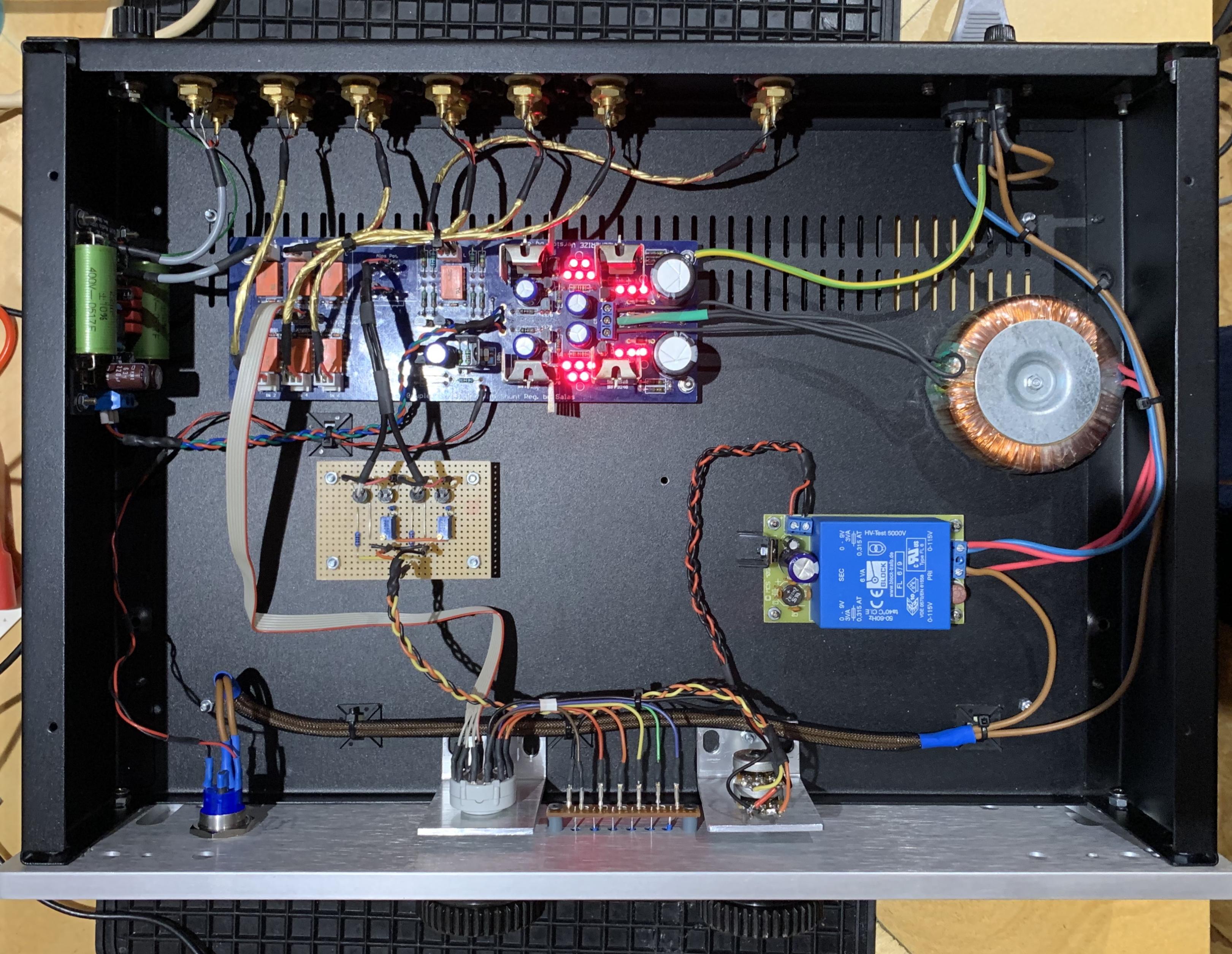

Here‘s mine, still unfinished but working perfectly.
I built a mezmerize 10 years after, but kinda hotrodded it to what I think was level 2.
BOM told me to use those sinks, most builders have just used the floor plate as heatsink (but then maybe with lower „bias“).
Heatsink is 50 high, 100 long, and warms up to around 40°C on the warmer side...
