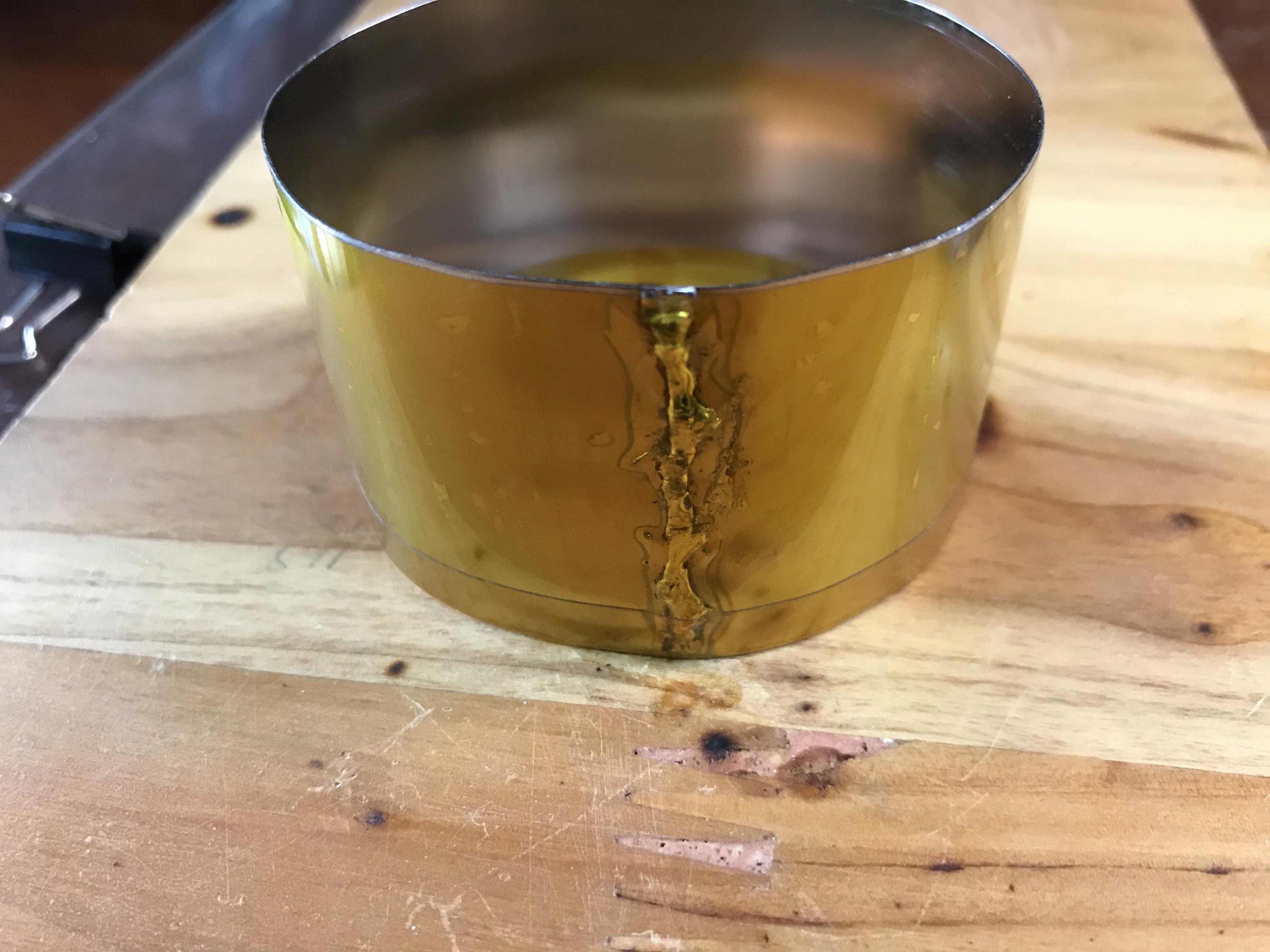

Btw, the mumetal vendor told me I should make the closed band and then give it to them for heat-treatment... But since I can't really weld at home, and solder is probably not going to hold in 1000C, I'll probably just get a pre-treated strip and use it as is, if that doesn't sound crazy... Looking forward to putting things together!

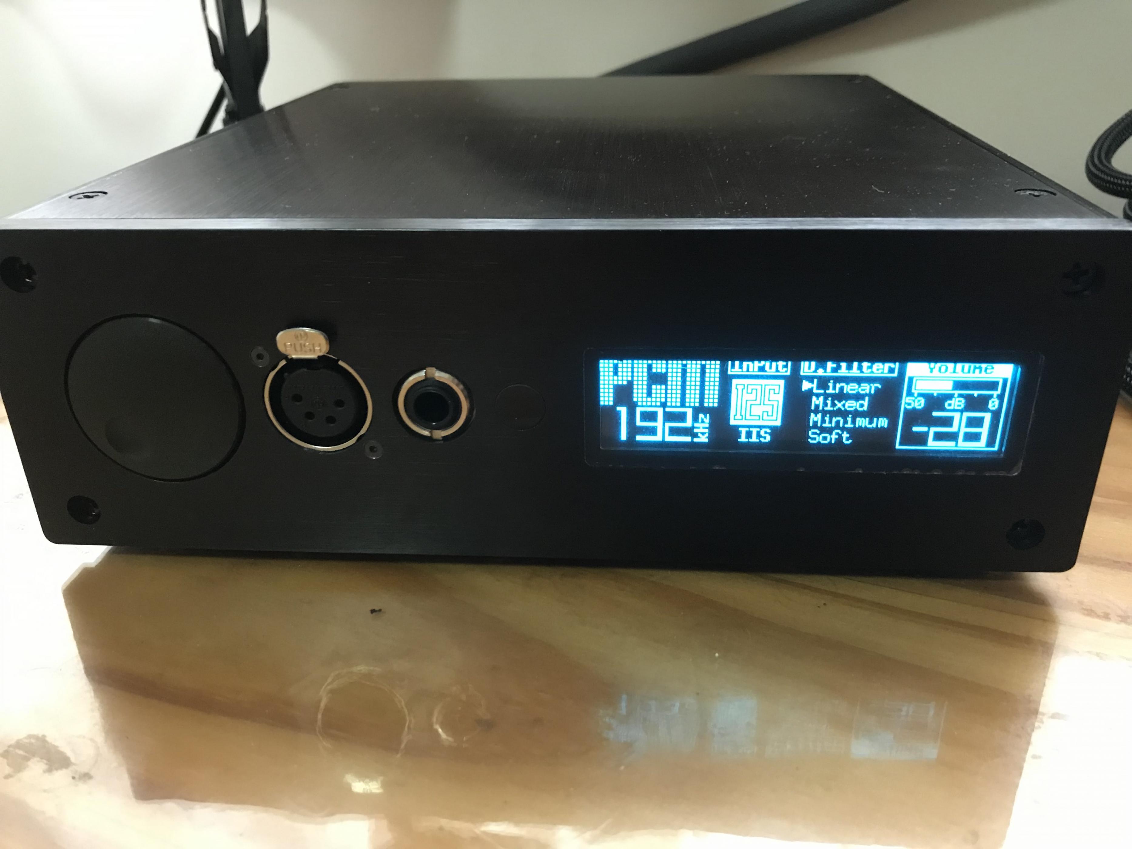

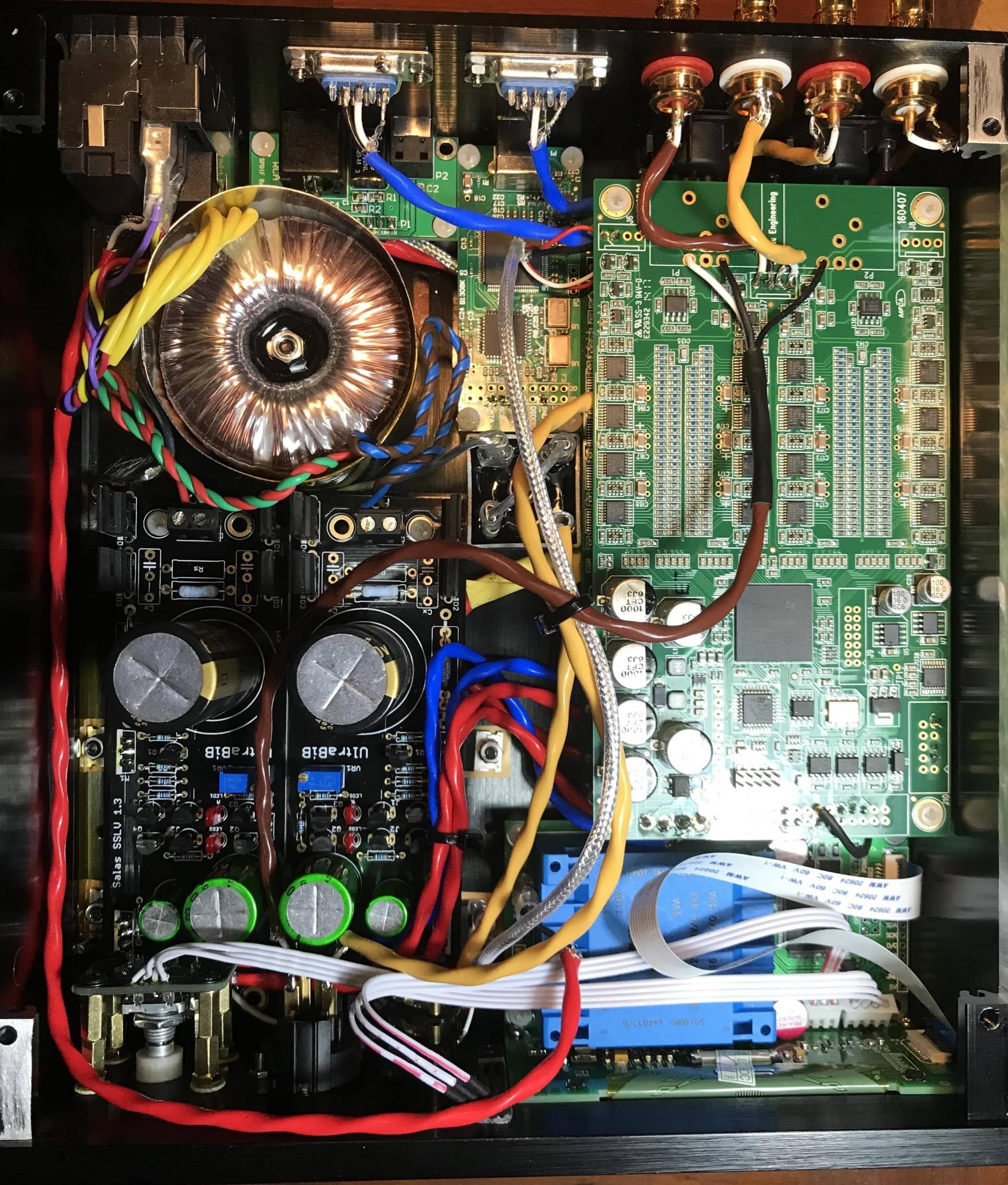

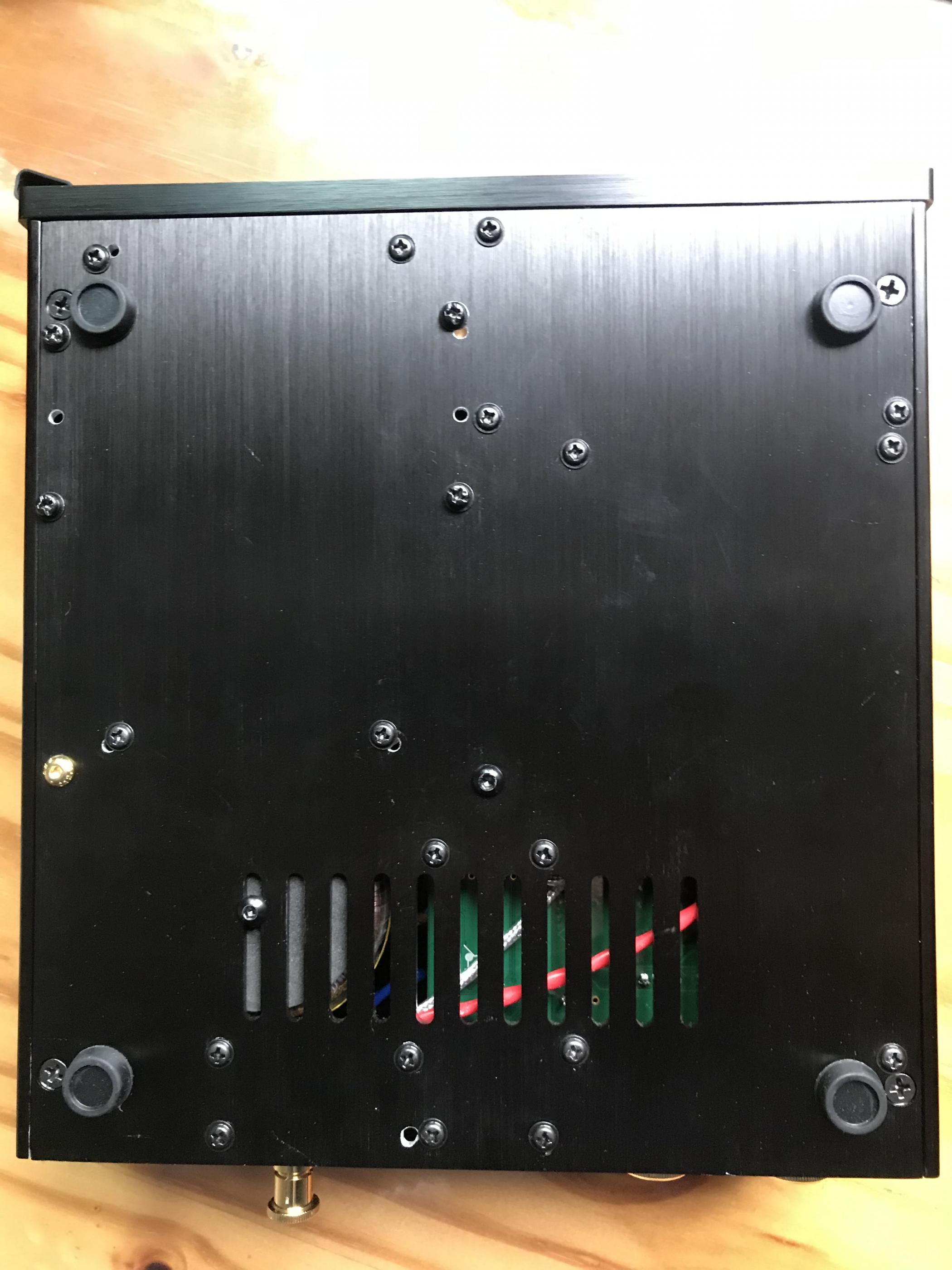

Expanded the holes and moved the PCB instead of shaving off the board and things managed to fit! Adjusted to 9V and Soekris sounds lovely :)
Still making final adjustments to the chassis, and have yet to install the mumetal shielding (0.3mm strip actually feels hard to bend, fully heat-treated one is still in the works and should be softer). Will post some pics soon.
I always spend too long on final assembly. The build is incredibly compact - virtually no space between the components, and only a few millimeters from C1 to the top cover. Probably breeding ground for trouble but looks quite nice at least... The heat-treated mu-metal strip is still processing and I won't have it till next month. I'll probably stick to the one already installed for a while - the difference is likely negligible. Hopefully I didn't make any obvious mistakes!
