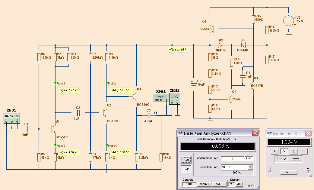

Here I have used BC550C
in a transistor line preamp with gain x10 and no global feedback.
Is fed by a discrete lowdrop regulator at 24.0 Volt.
Shows that we can get low THD (0.003% at 1Volt) using no global feedback.
The x10 is acheived by use of two gain stages.
The output is buffered into a load of 10k

Unfortunately there are (as far as I know) no easily sourced complementary parts which show, at the same time:
* low rbb' (gives low voltage noise)
* high hFE (gives low current noise)
* low excess noise (gives low low-frequency current and voltage noise)
* matching hFE for complementary pairs (gives low input bias current)
To give a specific recommendation you'll need to elaborate on your specific application. What's the source impedance, what input bias current is acceptable, is low-frequency noise a major concern?

Of course there are many discontinued devices which we'd have use for. Nonetheless I don't think it is correct to state that, as a trend, there are less low noise devices available. One problem is that there are now some many different transistors available that it's very hard to get, and keep, an overview. Also many transistors may have low noise, but are not explicitly specified for such, and thus just unearthed by accident.
With 2N4401/2N4403 and BC550C/BC560C you can cover 95% of the audio duties with excellence. Add SSM2212, SSM2220, LSK389 and BF862, and we're at 99.9%. All of these are comparably cheap (what did the LM394 cost when it came out?), and reasonably easy to source.
Much more of a problem is the lack of knowledge. You can't just pick a magic transistor and think that this will provide low noise per se. Deducing the appropriate number of paralleled devices, selecting the optimum operating current and minimising secondary noise sources is very frequently done wrong. Many more dBs of noise figure have been spoilt that way than with the unavailability of a specific transistor.
