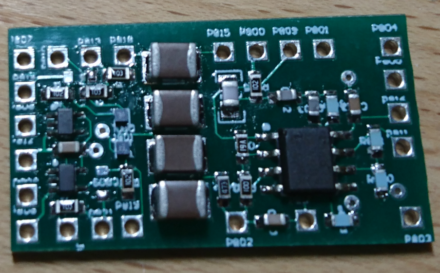

I have built the ribbon mic amplifier from AOE3, or really half of it, i.e non-differential
with ZXTN2018, and only 16 transistors instead of the 64 of the diff version.
The ZXTN2018 has SMD code 851, wich probably means that it's the same chip
as the FZT851, only sot-23. It delivered the promised 70 pV/rtHz, but needs
low input impedance because of noise current.
I wanted it for a chopper post amplifier, so the input capacitor is not an issue.
Hey, the chopper transistors are GaN, 1 square millimeter with 4 bumps, no case.
I could solder that but first must flush my pipeline of uncompleted things
b4 continuing.
The GaN-FETs are the small dots between the huge SOT-343 clock drivers on
the left and the 4 coupling caps.

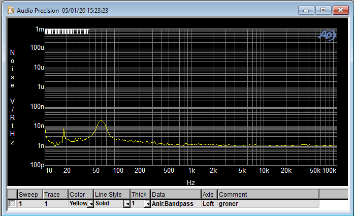

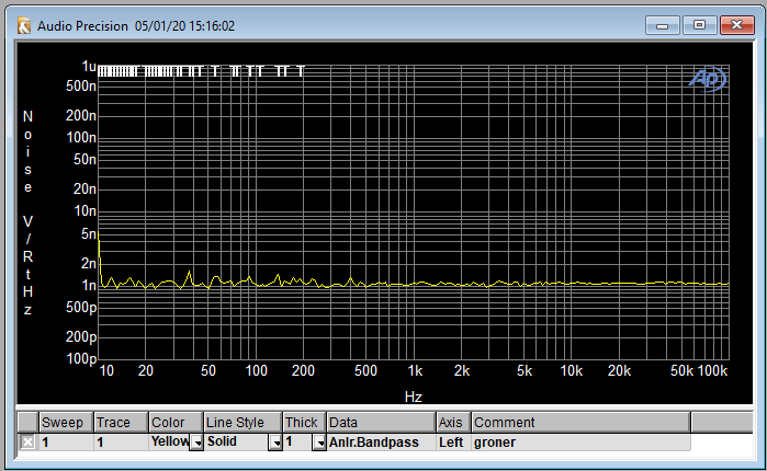

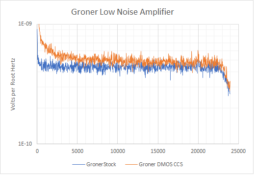

One thing I will note is that the 2.4V reference comes up a bit short -- around 2.1V -- probably not enough current to drive Vf to 0.6V
Got that fixed.

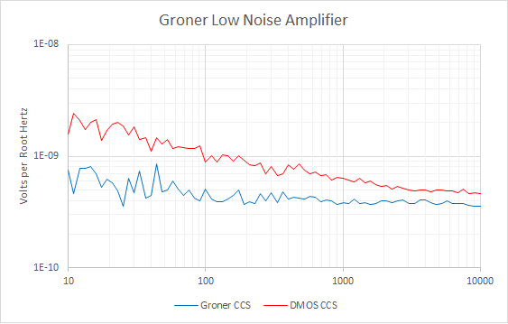

Here's an FFT -- I also experimented with a DMOS CCS -- much worse as illustrated below. Incidentally, the FFT and the Analog Bandpass method yield results within a very small percentage error.

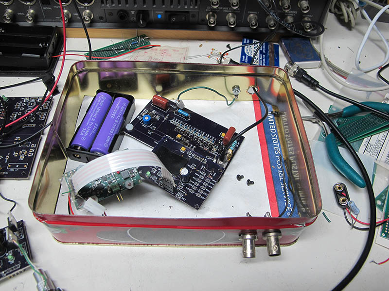

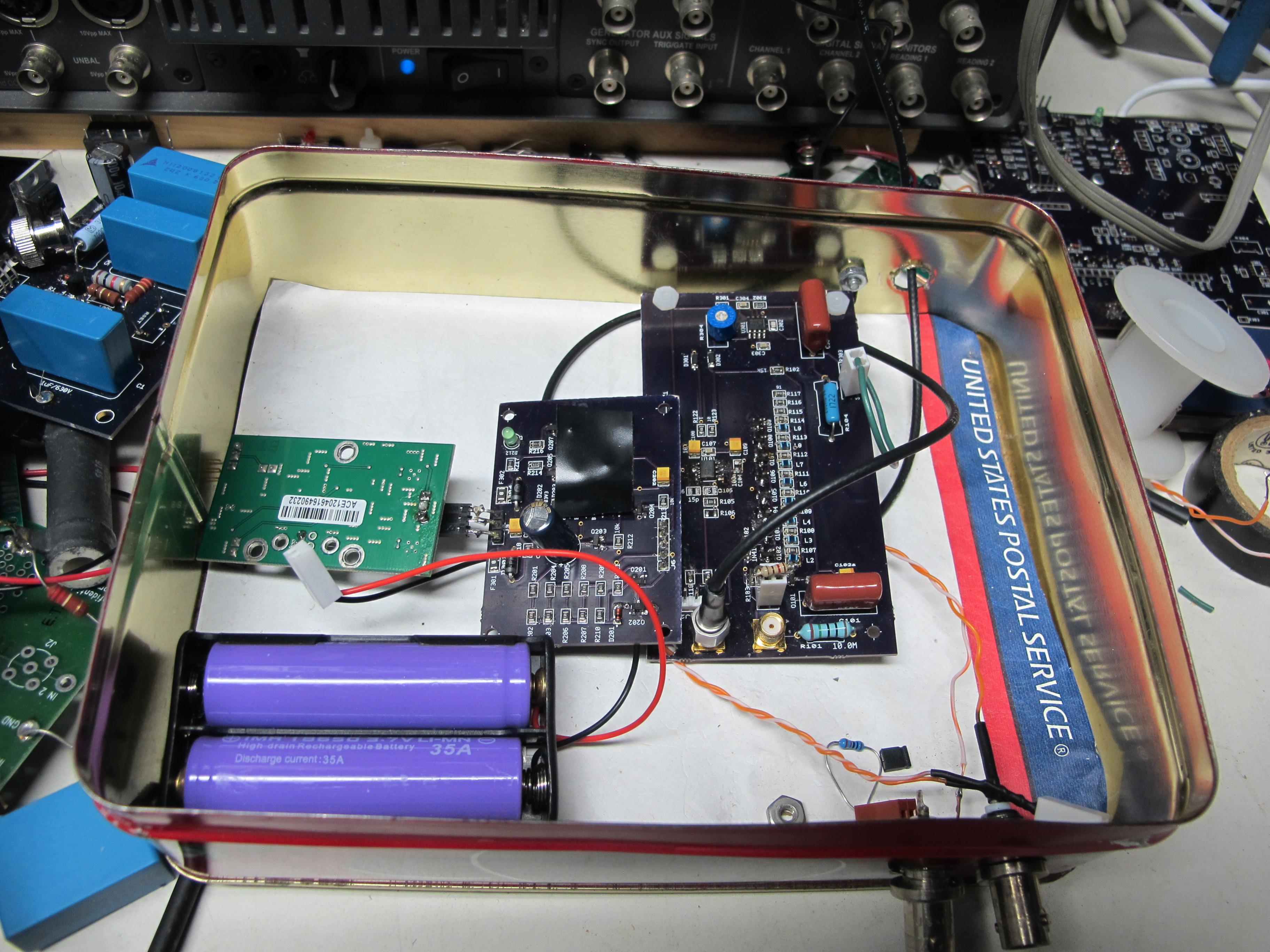

Here it is in one of the smaller cookie tins -- I have found that the heroic measures taken by Linear Tech don't seem necessary -- no need of a mu-metal canister, just the cookie tin, and the smaller tin is better for the waist-line:
I must say that Jan's "Silent Switcher" makes the Lithium batteries exhaust themselves in about an hour's worth of work.

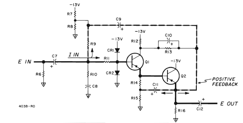

I built a version of the HP403 high impedance buffer using ZTX951. It was indeed very low noise (couldn't really come up with a number, but with the IF3602 amplifier it didn't increase the noise level more than a squiggle). Nevertheless, I couldn't get the input impedance above some 10k Ohms, whereas HP specified Zin of 2Meg.

Some fodder -- I used a 60 Ohm resistor on the input -- first image has the top on, second with the top off. amplifier housed in a Oreo cookie tin, powered by Jan's "Silent Switcher" and Sam's low noise current source and 2.4V reference:
