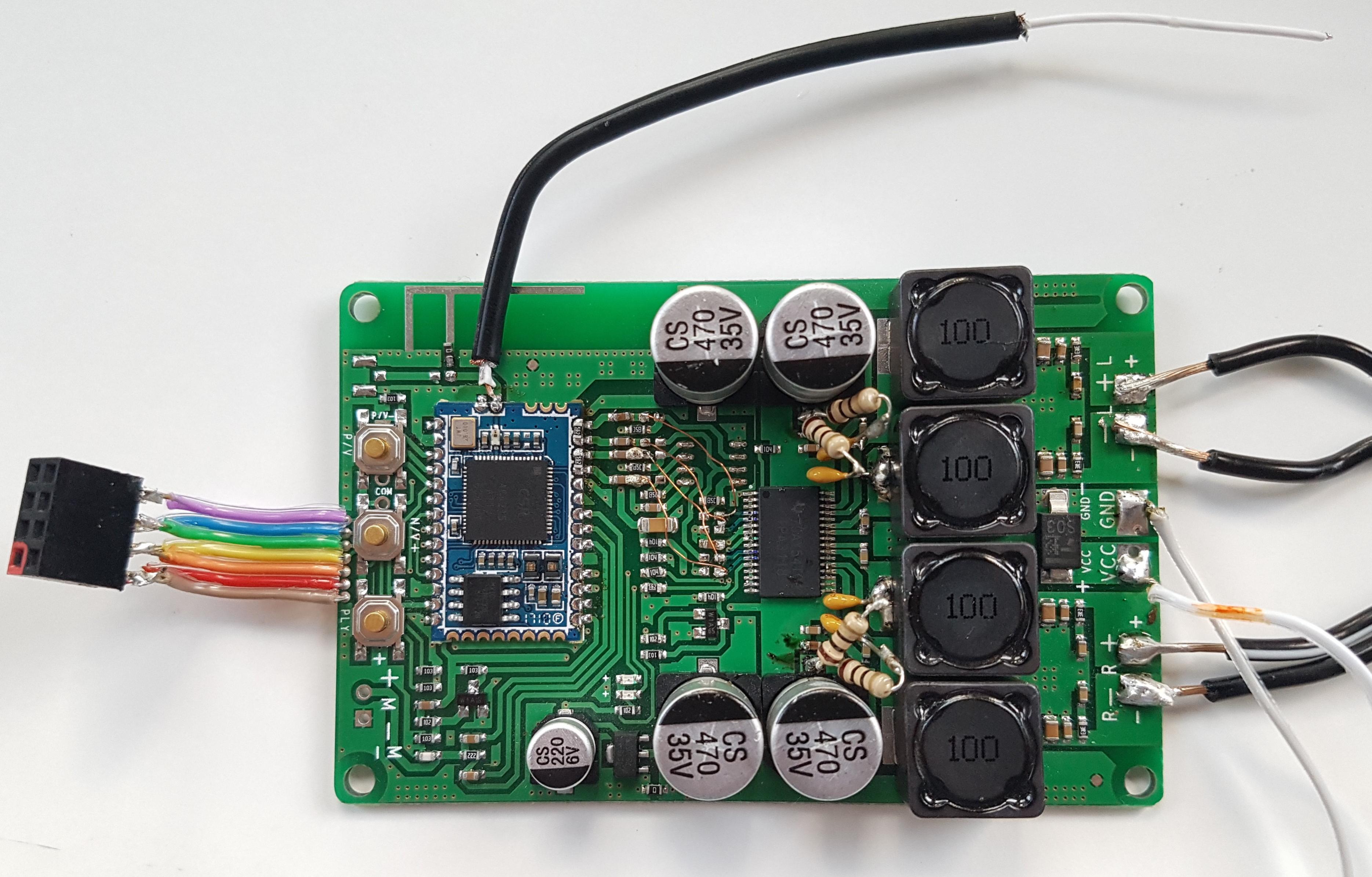

CSRA64215 + TPA3118 board
Thank you for these easy and useful mods! I have a CSRA64215 + TPA3118 board, since the modifications are the same, I post my results in this thread.

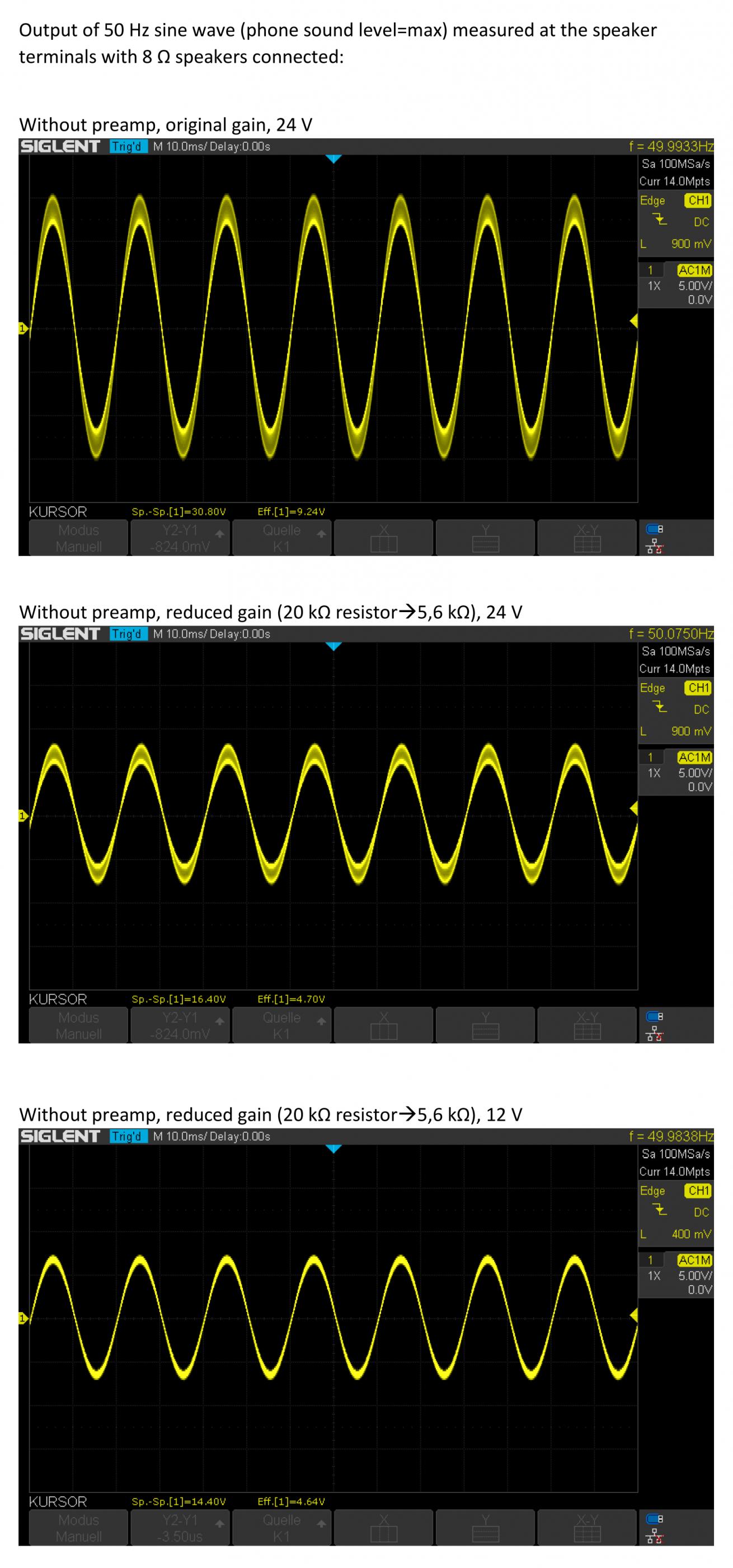

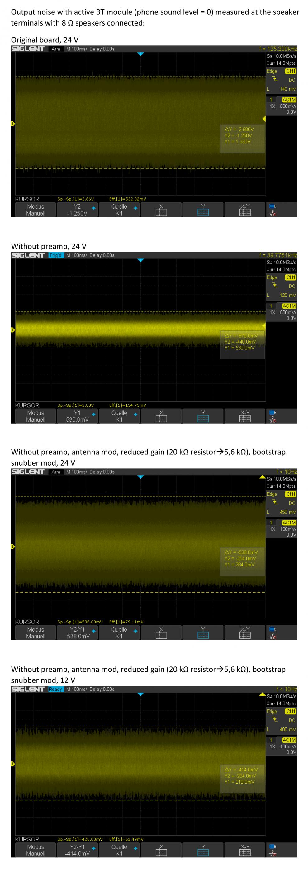

I did these modifications: Remove the preamp, antenna mod (post #111), reduce the gain (20 kΩ resistor → 5,6 kΩ), bootstrap snubber. They work great and reduce the noise drastically!

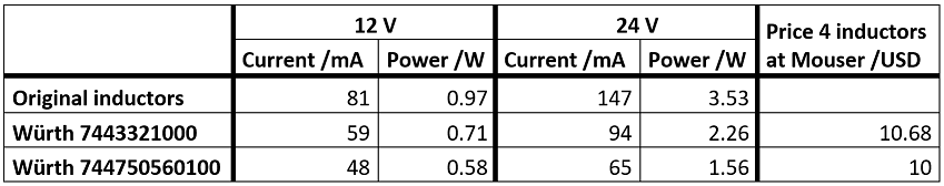

The Inductors get very hot (at very low music level: 65 °C!) so I compared 24 V and 12 V power supply: 24V: 145 mA →3,5 W, 12V: 83 mA →1,0 W! So I recommend using a 12 V power supply or upgrading the inductors.
I got rid of the start up pop by modifying the CSR-module: System → Timers: Audio Amplifier Unmute Time: 200 ms
I also did some oscilloscope measurements:
