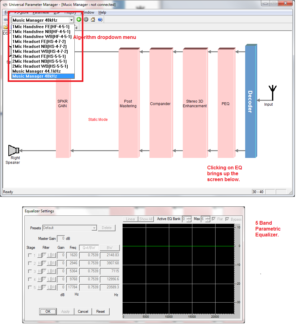

There's a problem. While I can install and open the CSR Parameter manager, all the selections are grayed out. The app is supposed to default to static mode where you can use all the functions without being connected to a device. You can see them but they're gray - no response to a mouse click.
The three links work to down load 3 zip files. The first unzips and the application can be installed from those files. Winzip reports the 2nd and 3rd file are empty. I think elements of the install are missing.
But the documentation is there to bone up.
Check that. In order to see parameter screens you need to select one of the "algorithms". I found the EQ screen by selecting either Music Mgr 44.1 or 48 (each encoding scheme has it's own EQ in the DSP). Selecting other algorithms brings up other parameter screens.
Clicking on the EQ (or any pink rectangle) will bring up specific parameters for that function.
