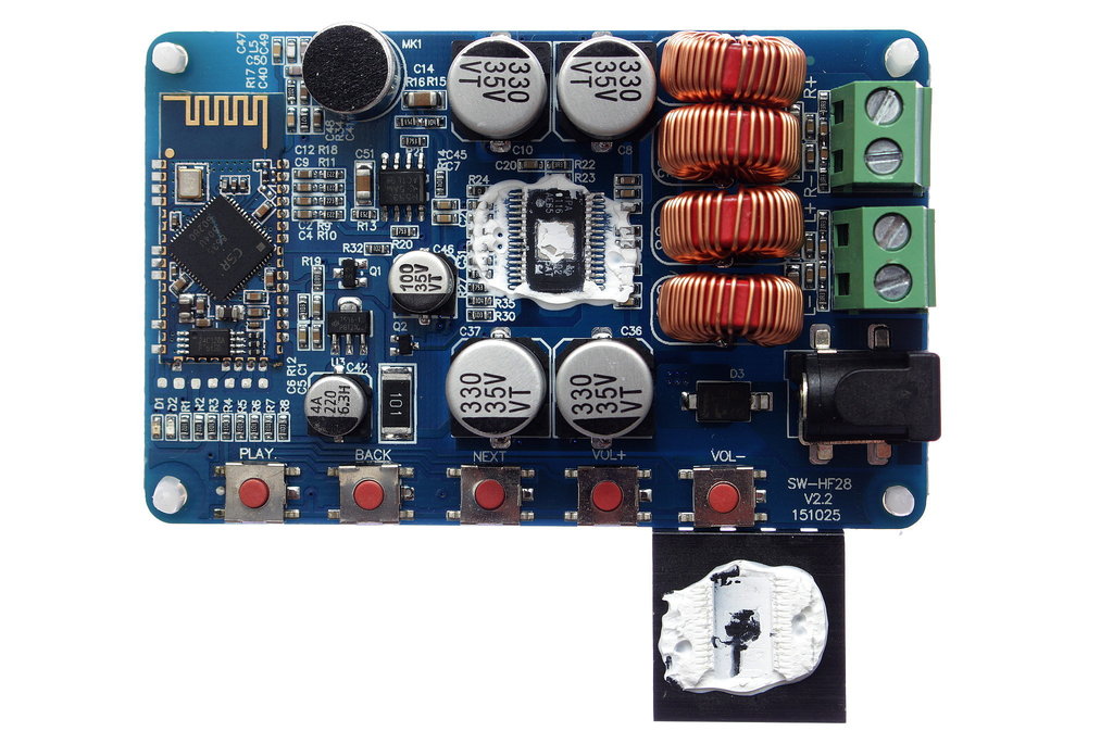

This is not true, this works fine. It is just a 'little bit' (WAY!!) to much heatsink paste. The idea is to replace the air in between the surfaces as air is a good heat insulator. A little drop in the middle of the chip and then putting on the heatsink squeezing a little out is enough. Just make sure the whole surface of the chip is covered. Better use a little to much then not enough...................
Sticking down a heatsink like this is rather useless. Anyway, cleaning the snot off:
Some pastes have silver in them an are conductive; then you would have a big problem shorting everything on the board.
Tell me about that, two weeks ago i burned two amplifers because i changed the termal paste.This is not true, this works fine. It is just a 'little bit' (WAY!!) to much heatsink paste. The idea is to replace the air in between the surfaces as air is a good heat insulator. A little drop in the middle of the chip and then putting on the heatsink squeezing a little out is enough. Just make sure the whole surface of the chip is covered. Better use a little to much then not enough.
Now i know why it happened.
Didnt even had a chance to hear there sound quality.
40$ goan

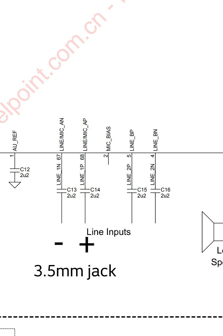

Help with line input
Wondering if anybody could help me translate the schematic for wiring a line input to these boards.
I'm using this:
I've soldered leads to the MIC_AN, MIC_AP, MIC_BN, MIC_BP tabs on the bluetooth module (magnifying glasses highly encouraged), but I'm confused by the C1-C4 markings on the diagram.
Basically I just want to add a female 3.5mm jack that I can use as a line in without adding a ton of noise.
I've already been able to change the firmware so that it acts as a line input, but I want to make sure its wired correctly before I keep going.

C1-4 are just input capacitors that go between your 3.5mm input jack and the CSR86xx input pins.Wondering if anybody could help me translate the schematic for wiring a line input to these boards.

Attached is a snip from the CSR8635s datasheet which hopefully is a little less confusing.

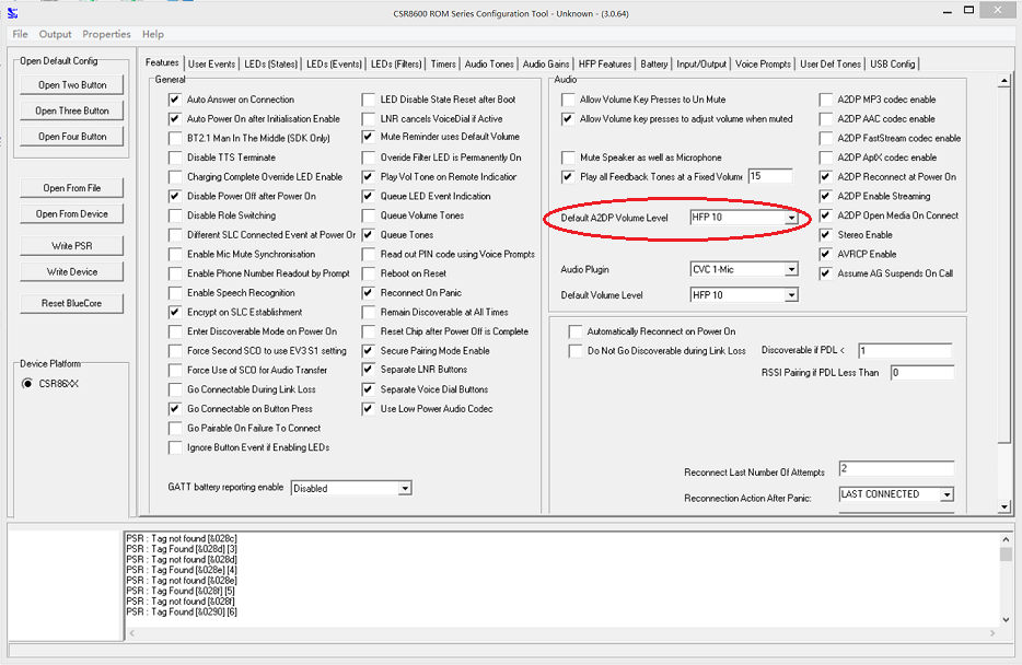

thanks again for that link. i successfully managed to change some parts of the firmware, but i dont see the part so the volume will be at MAX when starting the module. i checked the csr8600 configuration tool and in PStool
This may help from the CSR BlueSuite. I believe the highlighted (red) parameter is the default volume level for streaming audio. Just below that may be the default volume level for the entire unit. The HP10 value is one of 15 HP values that represent relative volume in dB. IIRC, each HP parameter is set in another screen to a particular dB level relative to 0 dB (I don't have the Bluesuite running right now to verify).
thank you. i tried it but it didnt work, for me it seems it always useses HFP10 so i changed the db for HFP10 in Audio Gain and that worked
Attached is a snip from the CSR8635s datasheet which hopefully is a little less confusing. View attachment 665970
Anybody know the purpose of these input capacitors? Controlling DC offset?
