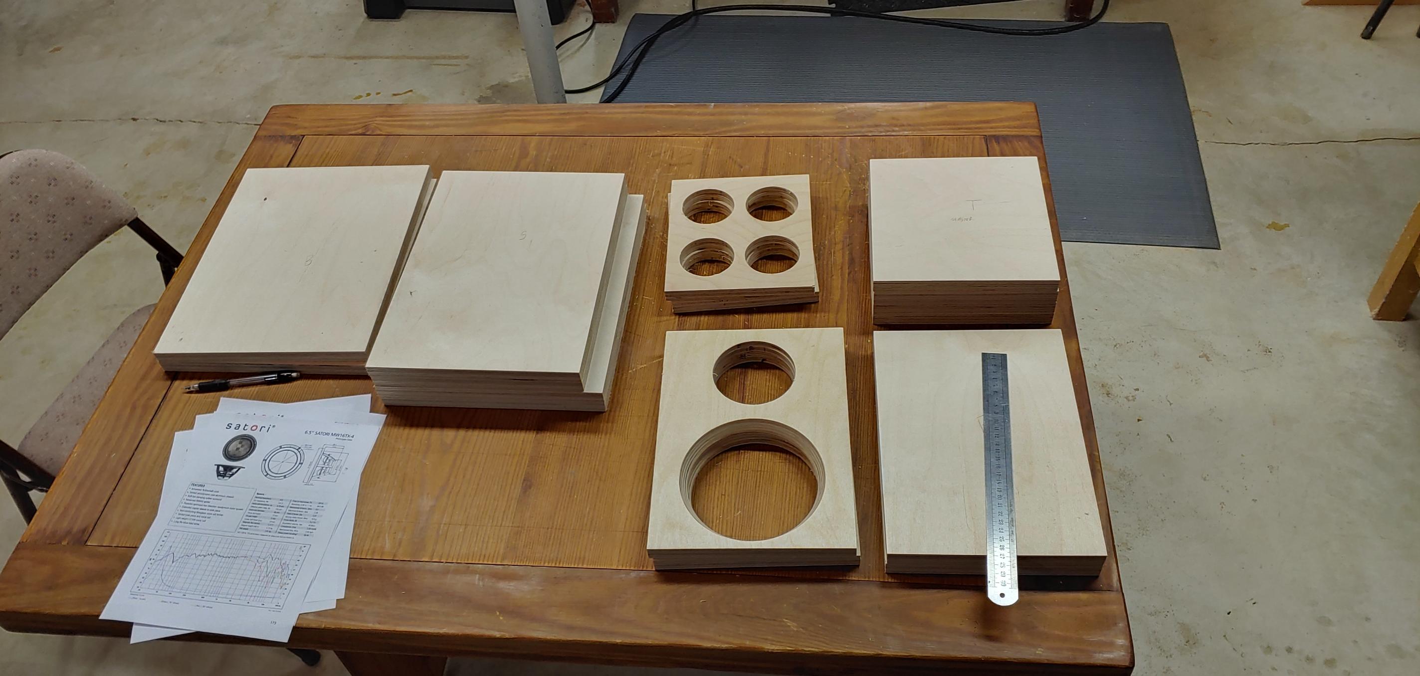

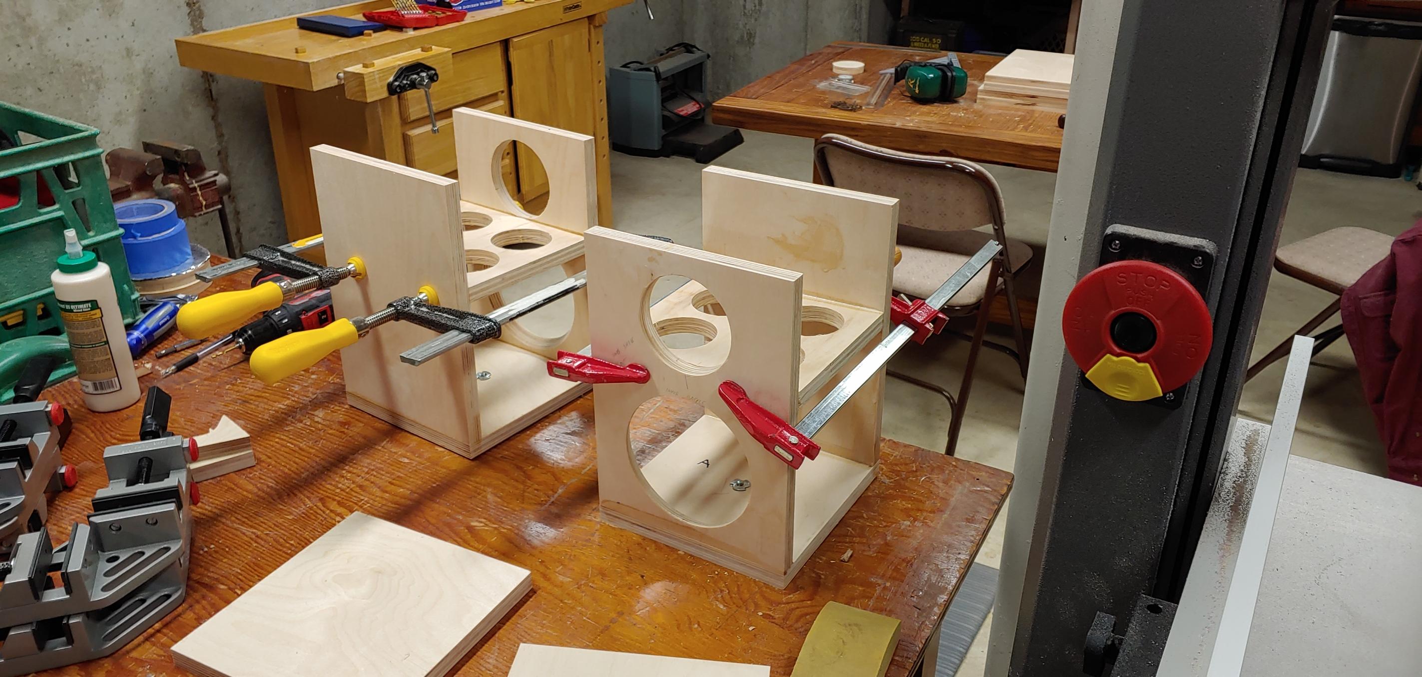

I have dismantled the foam-box prototypes of post 606 / 620. I am starting the construction of the real cabinets.
As work progresses, I think I will start a dedicated thread on the build progress instead of tacking it onto this thread (720 posts and climbing...)

Similar cabinets, but not quite identical. I do plan to build a double thick front baffle, 1.5 inch thick. The sides will be profiled with a 1.5 inch radius round-over bit, exactly like the SB ceramic boxes. This new build will use a 2 layer plywood baffle instead of a composite solid wood / plywood baffle. Before I did not have enough experience with veneer to confidently apply it over a curve, so I used solid wood. Now I know I can do it with veneer. The top edge will be chamfered at 45 degrees to a depth of 1.5 inch.
The SB ceramic box is 13" H x 10" W x 9" D. The new box will be 13.5" H x 10" W x 9.75" D. So slightly taller, slightly deeper. The arrangement of the internal braces will be different. I learned a lot while making the first cabinets ("learning" is code word for screw-ups).
I do not have any digital representations of the cabinet design (CAD or Sketchup). I did that kind of thing for 30 years and it feels too much like work... I like pencil and paper.
As I optimize the filters, I will share my measurements, subjective opinions, and my thought process...

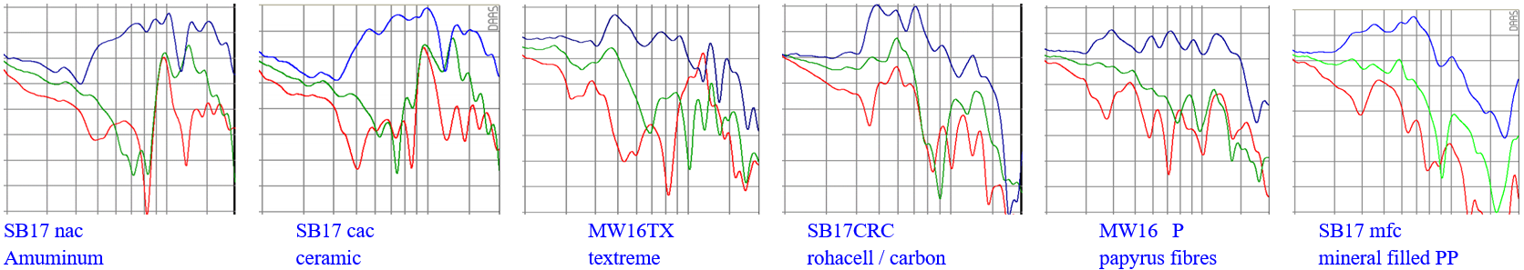

When designing a midwoofer-cone, the manufactorers look for three key characteristics: lightness, rigidity/stiffness/velocity and internal damping. They stir/heat/dry-, vacuum-, compression-, injection-mold/press multidirectionally oriented (ply-layers) of light and strong carbon/kevlar/glass/mineral/polystyrene/cellulose-fibers, mixed with some epoxy binder for shaping and stiffness, added some polymer/foam/pulp for damping, this is is how 99% of non-metal/ceramic midwoofer membranes are made, and every manufactorer has their own secret receips. Don't want to sound more grumpy than I am, but the Satori Textreme is no revolution or holy grail, it's just another thin-fiber, black-art, fancy looking membrane, one among many.
A measurement of a membrane's breakup modes, on-axis and off-axis, can tell how well damped the breakup is. The breakup behaviour does not tell how rigid the membrane is, (or what the breakup sounds like) but it can give an indication of the membrane's stiffness as well. When you look at the FR-plots of the SB Acoustics' different 6½" midwoofers below, between 2-20kHz, you see that the off-axis breakup of the new MW16tx is just as bad as aluminium and ceramic, very low internal damping indeed, don't be fooled by the nicer looking on-axis response, this driver rings! The new stiff cone of the MW16tx will add some low level resolution compared to the soft papercone of the brilliant MW16P, but at a cost.

Thanks for the easy-to-review comparison photo.
My take on Textreme is that it's going to be a rigid cone material with a more-controlled breakup than what you'd find on a conventional rigid material like aluminum or ceramic. Seems to do the job, although I also question if there is any significant advantage vs aluminum or ceramic (as long as the application allows for adequate mitigation of the breakup), especially given the cost differential.
From a practical standpoint, SB coming out with the Textreme lineup essentially gives the end user accessibility to the wonderful Satori motor (though perhaps equalled by the NAC/NBAC series) but with a cone that doesn't suffer from surround-edge resonance and has breakup at a slightly higher frequency.
You may be right... time will tell.
454Casull's thoughts match my own. My test data revealed that the Mw16TX driver has a first mode resonance that is almost as high as the SB17CAC ceramic cone, but the resonance is more damped than SB17CAC. Is this enough to make the MW16TX sound better than the SB17CAC or the MW16P? I don't know... again, time will tell.
