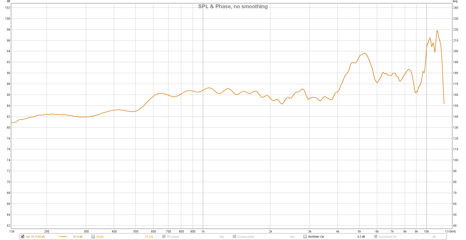

Hifi compass MW19TX-4 frequency response measurement very different from SB. Kind of disappointed about this as the midrange rise on SB graph wd have been very useful Assume hifi compass test is v accurate.
Has anyone else measured this model yet?
Here are my measurements of the raw woofer - In a 445mm h x 230mm w baffle , 20L sealed box. No EQ, 5ms gating. See waveguide thread for more.
![SATORI MW19TX-4 230MMX445MM BAFFLE 20L SEALED BOX.jpg SATORI MW19TX-4 230MMX445MM BAFFLE 20L SEALED BOX.jpg](https://www.diyaudio.com/community/data/attachments/851/851681-eaf9c405d3bb3f029a583ec710c7dd9b.jpg)

Nice and smooth but two bumps above 2Khz that may need attention. Any ideas?
Are you referring to the two breakup modes...? That textreme was supposed to reduce lol?
Easy to flatter with DSP. Passive maybe not so much
Thanks for posting you measurements guys. Quite surprised and shocked how different SB measurements are.

The baffle step fallsbelow 600 hz which is not a surprise... But it is like if your speaker has no gain from the near walls! Did you measure it in a garden far from qny walls but the soil ?
It is absurprise it falls below 84 dB till to 82 dB .... even if Edge soft gives till 8 dB loss around 100 hs... but below Schroeder frequency you should have more gain I beleive...
Bad unit ? Bad Vas measured and too low volume box?
