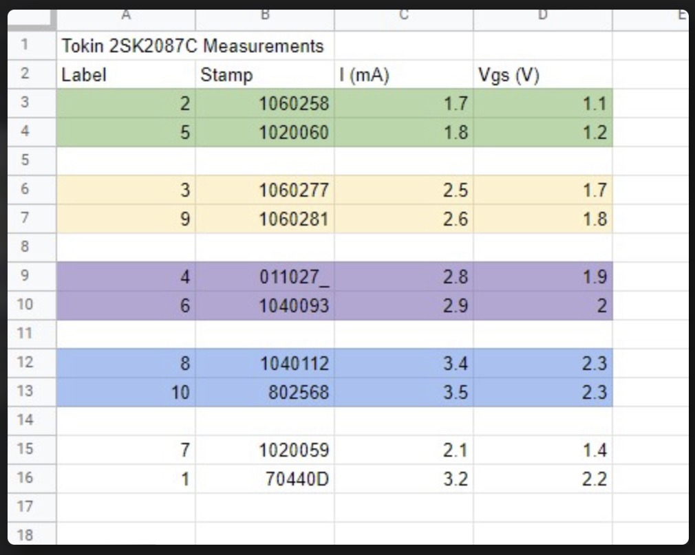

question - did you test your 2SK2087 for Ugs?
first step:go back with Iq trimpot, then replace R116 with 680R

Attached are the results from my simple transistor tester measurements of my 2SK2087Cs. The one on this troublesome board is either #2 or #5. Can’t see my label on it now. So I did not do a more thorough assessment of my little batch of 10 (of which I now have 2, 5, 1, 7 available).
#3 and #9 are in my TDV amp doing very well.
Thank you for the troubleshooting help.

can you measure voltage between mosfet gates, for max and min trimpot positions?
by measurement across R122, we confirmed that CCS side of current mirror is functional
now, observing voltage between gates, we'll know does other side of current mirror is working or not
all of that , presuming that there is no wrong resistor value somewhere ......
gate to gate voltage is not high enough nor is having enough span
3 things:
-check all resistors (values, position); that includes trimpot values :clown:
-take cotton swab, clean top of all 6 SMD bjts (those in current mirror), find good lens/loupe and check their markings; 3 same ones in positive rail, 3 different same ones in negative rail; that in case some bloody greenhorn behind Iron Curtain did solder wrong SMD part ......... if needed compare with good channel
-check position and value of all SMD resistors; those at rails are 470R, base resistors are 100R, in between mosfet gates are 6K8
nomenclature as per schm in #188
if nothing else, while you're staring at small ones and if you can't find my error, you'll find your own
