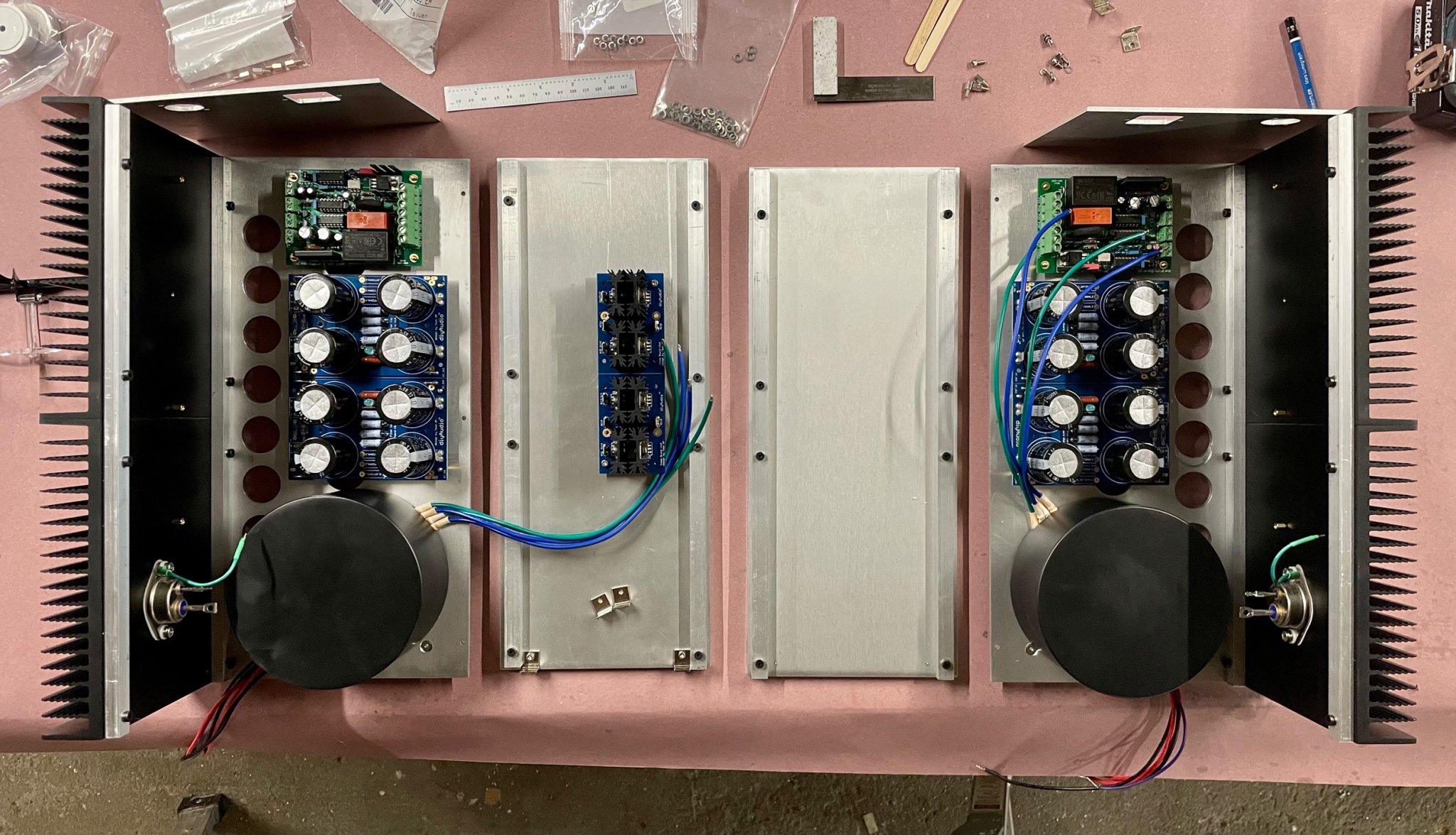

Some progress... lots of tapping—and some more vent holes for his Mighty-ness.
I may have to flip a coin to see if I fill these chassis with Sissy (42) or Scryer first!

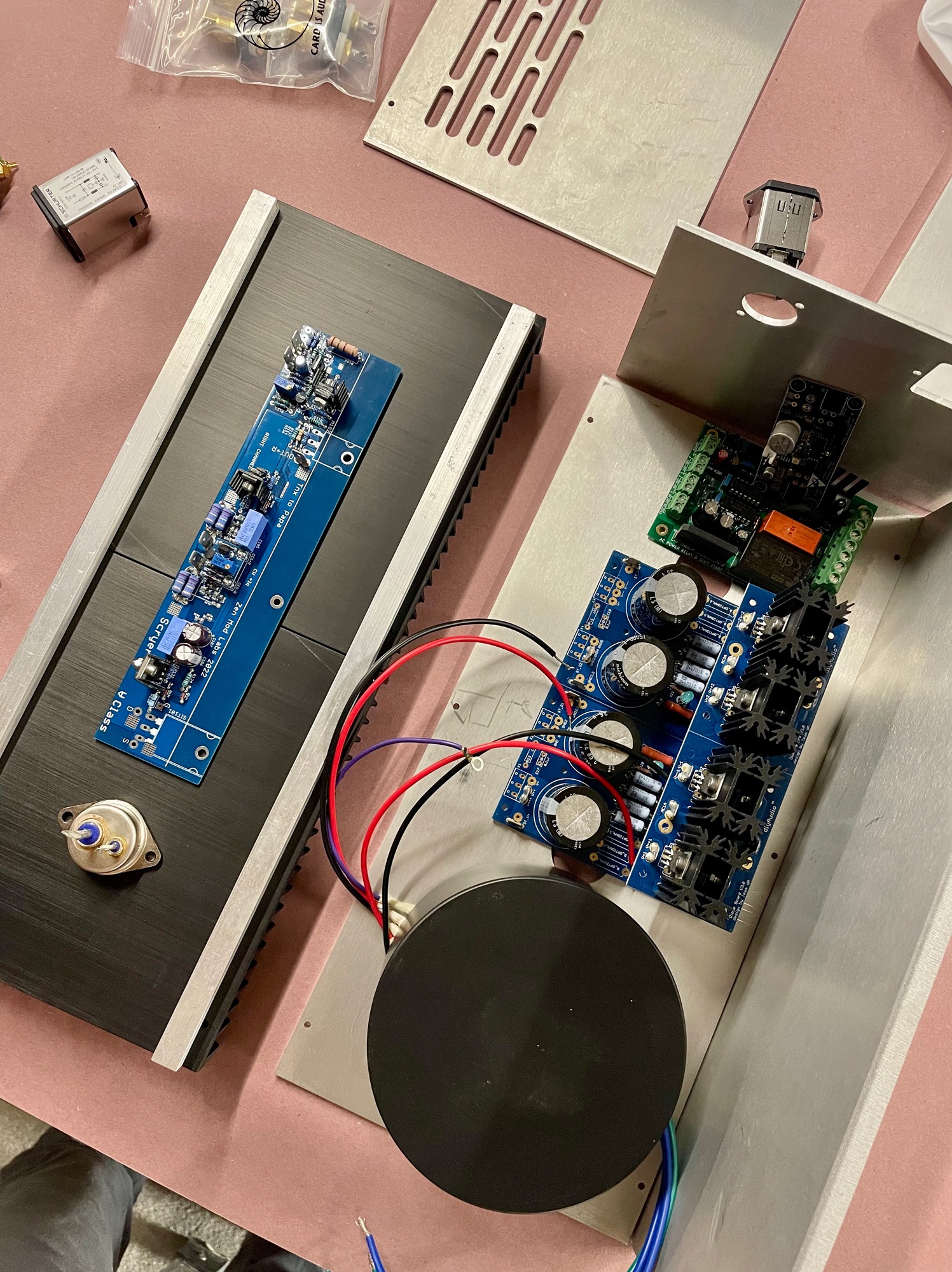

Oh, and ZM—just confirming that the drain connection is from the case of the SIT—the ring connection on the SIT needs to be under the isolator bushing....?
yup

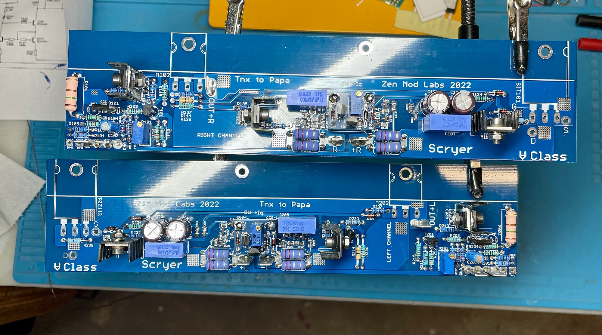

yes, 1A5 initially
when both Iq and DC Offset are in ballpark, fine tune both in temp equilibrium ( not that it matter much, but procedure yadayada)
1A6 to 1A8, whatever makes you happy
1A6*0R11=176mV
ZM—aren't the critters here 0R22 (R139-142)? So, 352mV @1A6?
OR what don't I (yet) understand..?

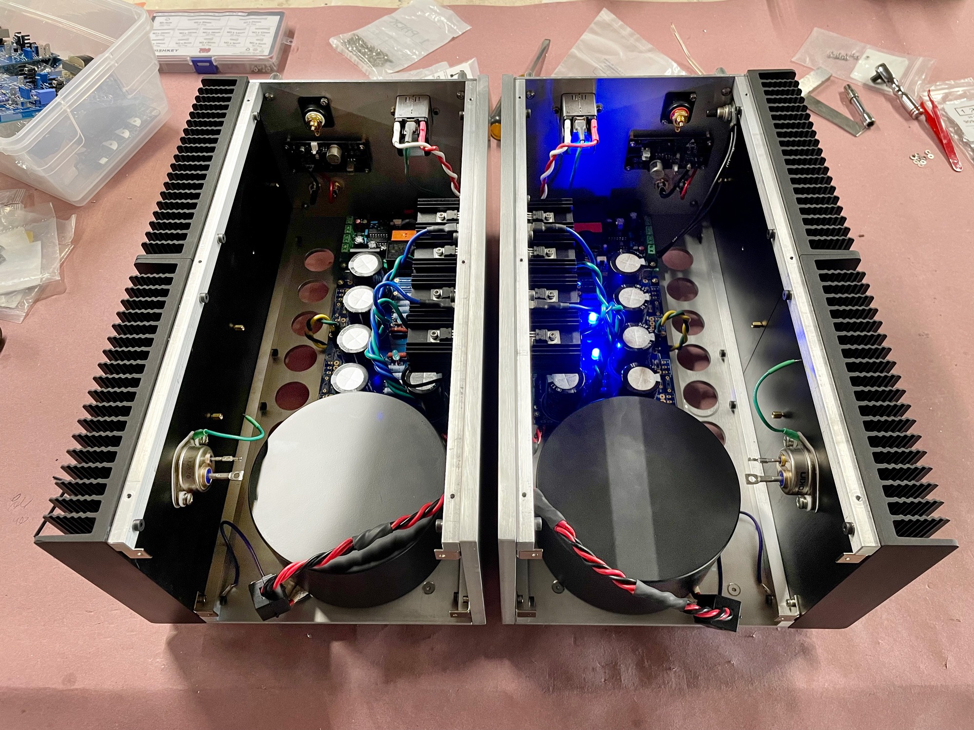

Oh, and 2X working PSUs ready to go... still have to make some fronts...but they fired right up no issues.
(Nice residual blue glow there with no place to go!)
Almost ran into trouble there on the back wall with the DC blocker in the way of SissySIT (later) boards (Scryer won the coin toss).
See? I KNEW it? I did think about that...but alas, my maths? and my abilities to "see parallel" in schematic form (they ARE in fact IN PARALLEL)? Oh man. That's why we (I) have you. I love being the one to ask the most inane question....was just discussing this topic with @ItsAllInMyHead .... maybe someone will be inspired.
Maths is for weaklingzezzez and continental boyzSee? I KNEW it? I did think about that...but alas, my maths? and my abilities to "see parallel" in schematic form (they ARE in fact IN PARALLEL)? Oh man. That's why we (I) have you. I love being the one to ask the most inane question....was just discussing this topic with @ItsAllInMyHead .... maybe someone will be inspired.
Could you tell us a little bit more abput your DC blocker(z)?
Speaks protection. He's a member here—and makes a lovely Ferrari of a PSU—which would have saved some space in these tidy cases. Price doubled since the last I picked up some of the DC blocker boards. I'd love an actual DIY solution... but these are close—and compact. Not entirely sure what would blow in my Xovers since all the up front caps are film (probably more I don't know yet), but the protection circuits have tested themselves...most recently in J2 Bableness....
Here's another speaker protection from Bonsai, also based on mosfets,
it's a bit more DIY, you can only buy the PCBs

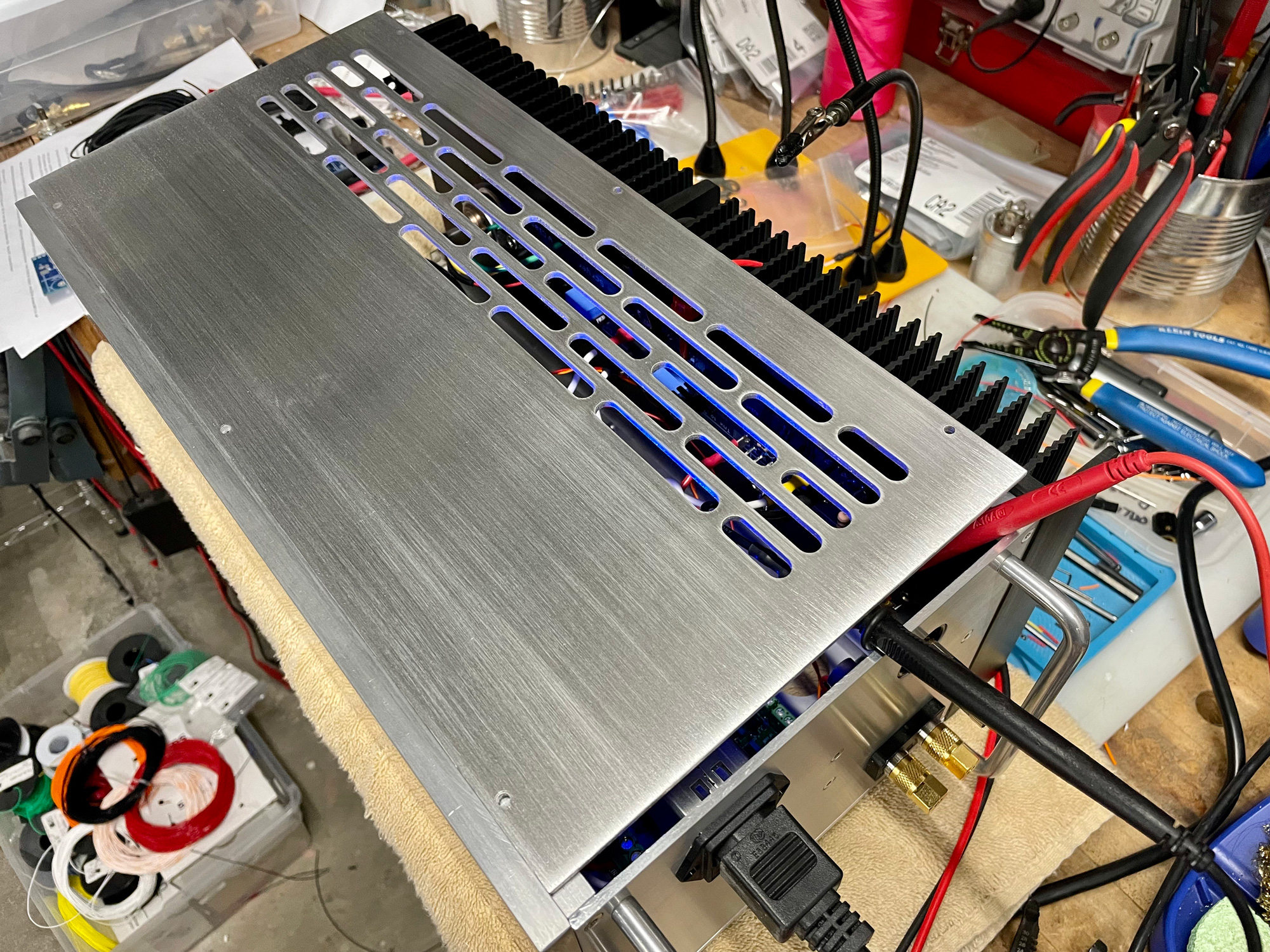

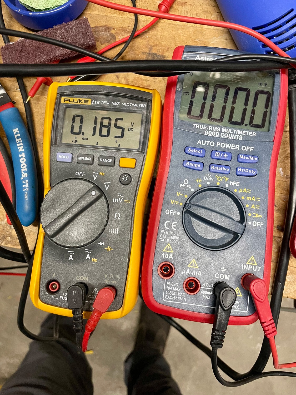

Cooking... Left mono....
0.185V with twiddler maxed at bottom rose slowly from 0.174V when it was cold... so that's about 1A68ish...
Shift resistor change? Something I read along the way someplace... or am I good ZM?
Offset is pretty stable...comes up a bit as it cooks. The whole shebang feels really stable I have to say.
(lid isn't finished... will be not so grained in the end... couldn't wait!)

two things dictating do you need more juice:
-temp of heatsinks (55C at top, unassisted in summer time)
-mosfet dissipation - if Keratherm or Alumina Oxide, good for 45W
whatever you hit first, stop
I'm lazy to get back and search what rails you have, but you know the math for mosfet diss.
going zzzzzz
yup, if you go for more juice, backup with Iq, increase level shift resistor to 150R, readjust Iq and Offset
small slide of Iq and offset is normal, from cold to hot, but if you take numbers, you'll see that percentage is small
my goal wasn't to push any of these to absolute stability, but to have Iq and offset stable enough both in temperature domain and in domain of sliding rails ( mains fluctuation)
