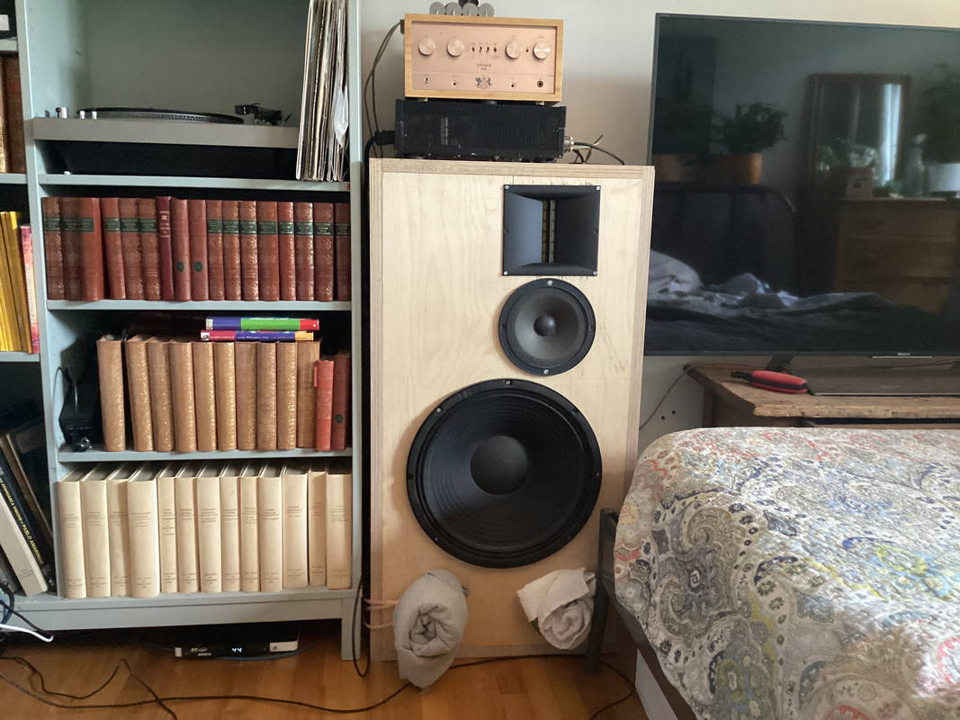

as much as i like them, im kinda shocked by how limited these are in resolution, in extension, in bass quality vs my big 3 way.

ive had, heard and auditioned probably around 300 speakers since im a audiophile.
you can look at my past post for my current speaker system.

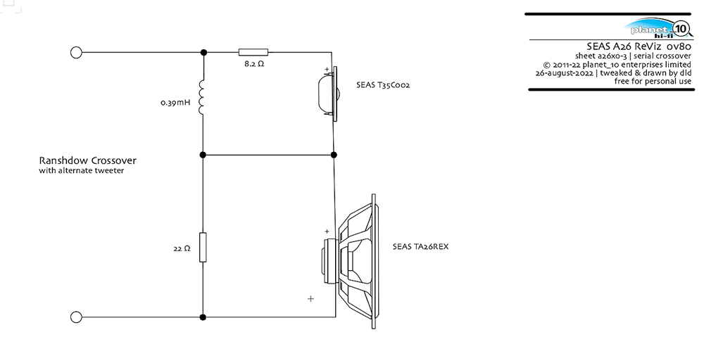

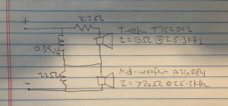

Thanks for posting the link to your system. It would appear you favor series passive crossovers. Did you happen to try the Seas A26 with a series crossover and a high Zout amplifier when you listened to it?Seas a26.
Below is the series crossover I use with my Seas A26 aperiodic 28L cabinets. It sounds quite good with diy clones of the First Watt F1J and F3 amplifiers. The former is a transconductance amp, the latter is a voltage source amp with a DF of 6. The crossover uses one leveling resistor and one shunt resistor so it may not be to taste.
Or maybe it doesn't like the location.Love the towels. I usually use open cel foam. Suggests the box not right for the (JBL?) woofer.
jeff
do you have measurements of ur A26?Thanks for posting the link to your system. It would appear you favor series passive crossovers. Did you happen to try the Seas A26 with a series crossover and a high Zout amplifier when you listened to it?
Haha indeedOr maybe it doesn't like the location.
jeff
the bookshelves are now gone cause it totally messed with the bass response
