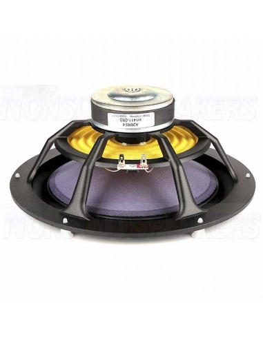

the pics for the Devore O93/O96 show that the magnet is much different then the A26 woofer. only the cone is identicalMaybe the A26 is made for the DIYers and whatever Devore uses is something Seas made just so that manufacturers would fork up the money for an OEM design. In this case, with a properly sized magnet.

I believe the drivers in the second pic are for the O reference series. Notice that they cast from brass.he front looks like phase plugs so not identical and not an A26
Can you post pic of insides or a link.
None of these are A26:

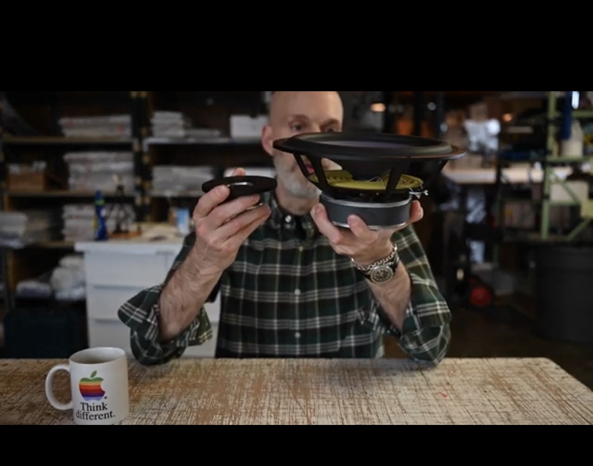

In this video Devore talks about how speakers work
And At 5:31 you can see the driver he holds up.

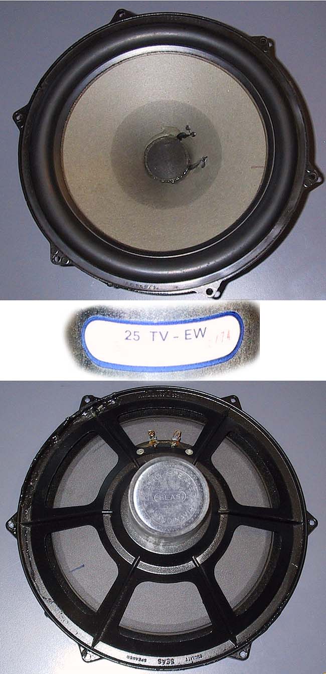

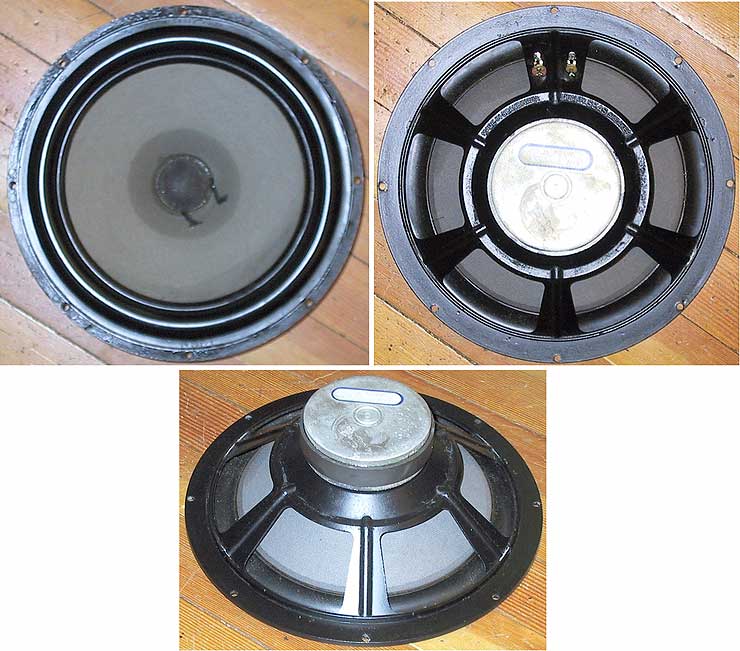

And the Devore driver looks like they are using the ferritte magnet of the old Seas A25XL, the second version used in the Dynaco A25 (first was with a Seas A25 H336 with the Alnico magnet).
The modern A26 has a much better magnet i have to say. It's lower distortion and more powerfull than the big old A25 ferritte magnet.
