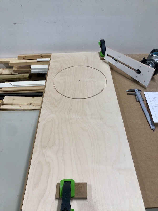

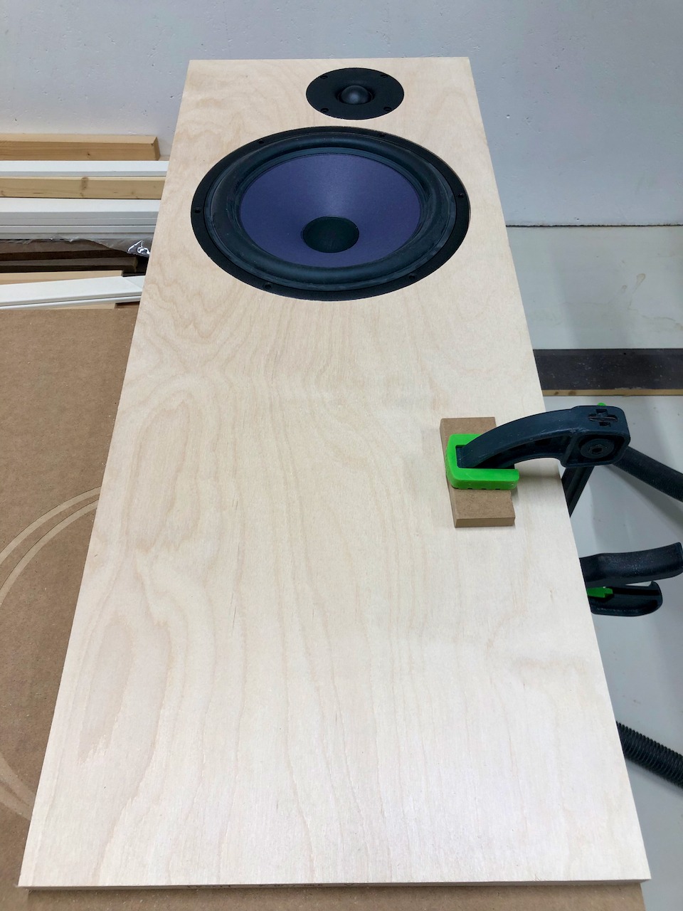

I've just started my project «SEAS A26 floor stander». Pretty much like the SEAS recommendation, but the height is extended to 85cm. 18mm BB plywood with bracings. Sealed. Approximately 61-liter gross volume.
I'm considering making the rear panel removable - with sealing and screws. It would be easier to experiment with damping material. In addition, I can go for M5 machine screws for attaching the woofer. Any drawbacks?

I made mine with removable backs. It just makes it so much easier to make adjustments.
Almost every speaker I’ve ever made included a removable back, and quite often a removable baffle.
I have read posts from much more experienced builders that suggest that there are no down sides to a removable back—just a little extra work.

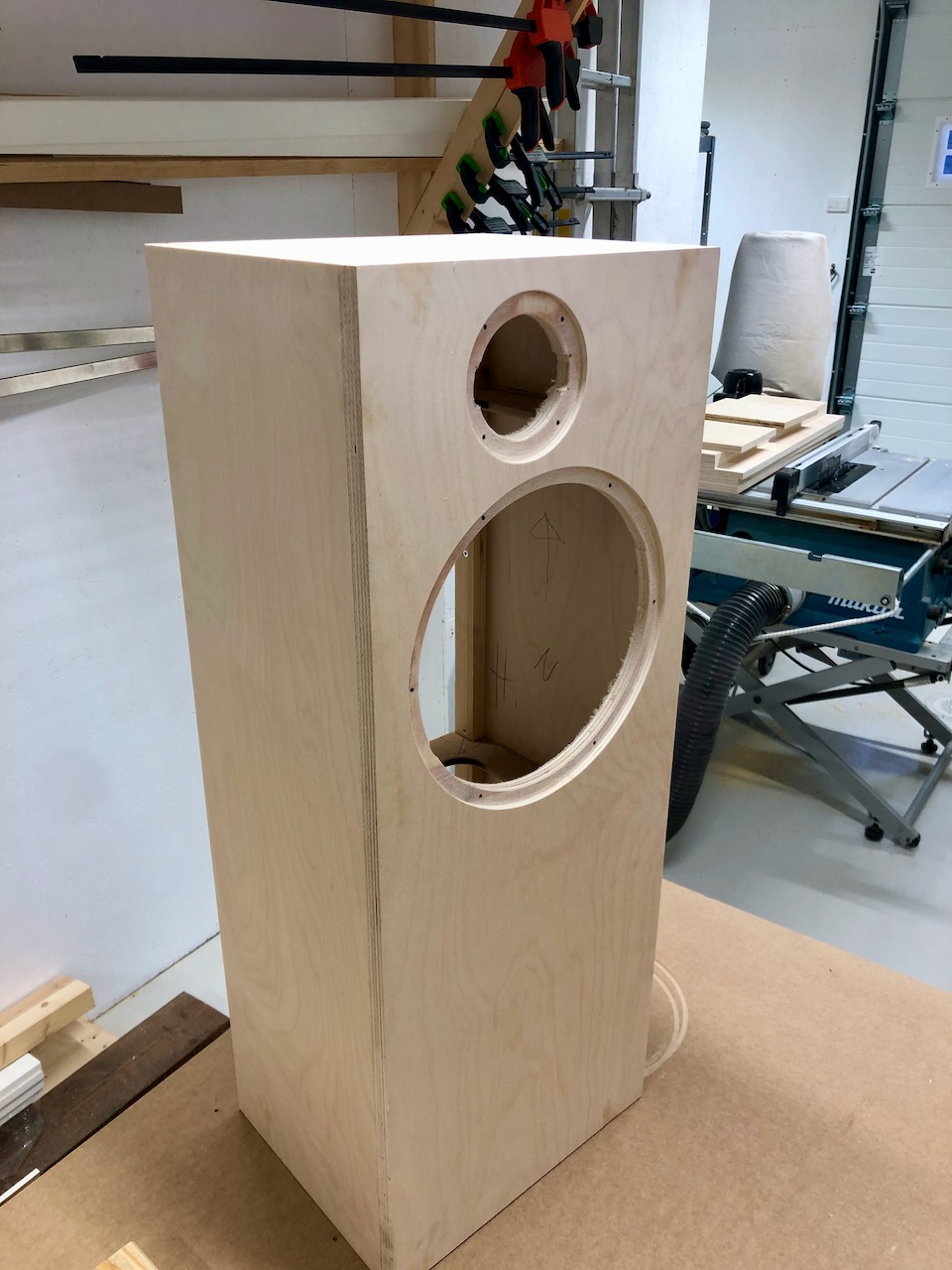

Hi guys. The project is moving forward - slowly but steadily. This is new ground for me, so I'm waiting for some flaws or setbacks...
Both cabinets are glued together. Next up is fine sanding and a few layers of clear Osmo top oil.
Should I add more bracings?
Is a gasket behind the woofer recommended? Nothing to find in the SEAS cardboard box.
