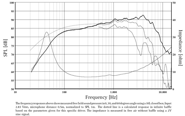

The 7" Seas Curv is recommended up to 4k. Do you think this one is not a good option?

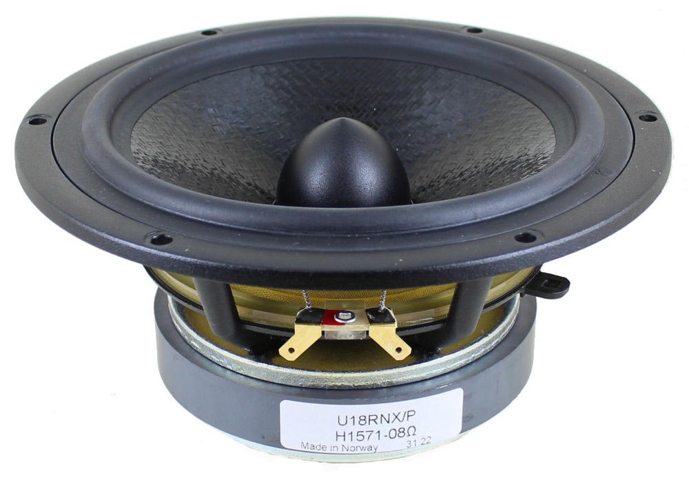

Do you think its a good option to go ahead with the Seas magnesium woofers? I found them at 199 usd on sale right now. Why do you recommend the U18 instead? Someone told me the Seas Magnesium are old and that there are better cheaper options today, but I personally am not finding any modern better solutions other than potentially the U18 Curv. (But I read a lot that Poly woofers have too much damping so I am hesitant, but since the Seas are woven poly, maybe that is different).

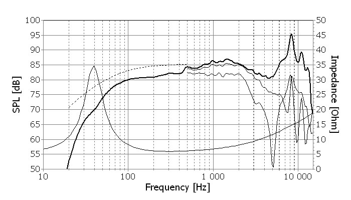

Seas 5" magnesium woofers
Yuk.
Rising response but only to about 1.3 kHz and that ugly peak would have me avpoiding crossing any higher. And i would put a coat or 2 of puzzlekoat to tame that peak a bit.,
The basket is nice.
dave
