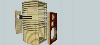

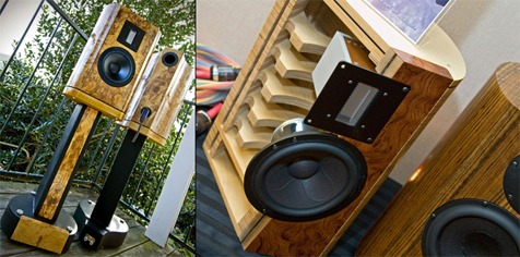

here are some translam examples I have seenThe walls will need to be something like twice as thick vrs using the materials in the direction intended for their use.
Solid is not something i associate with translam.
Yep, maybe I am at considerably lower power in that case.That's pretty much just a guess IMHO.

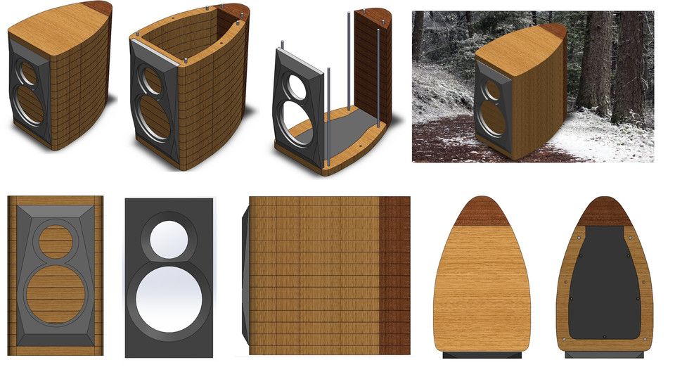

Here is a quick render of the design concept. The woofer on the render is still the original 6.5 AC woofer I had started with. Final design will probably be professionally painted instead of veneer.

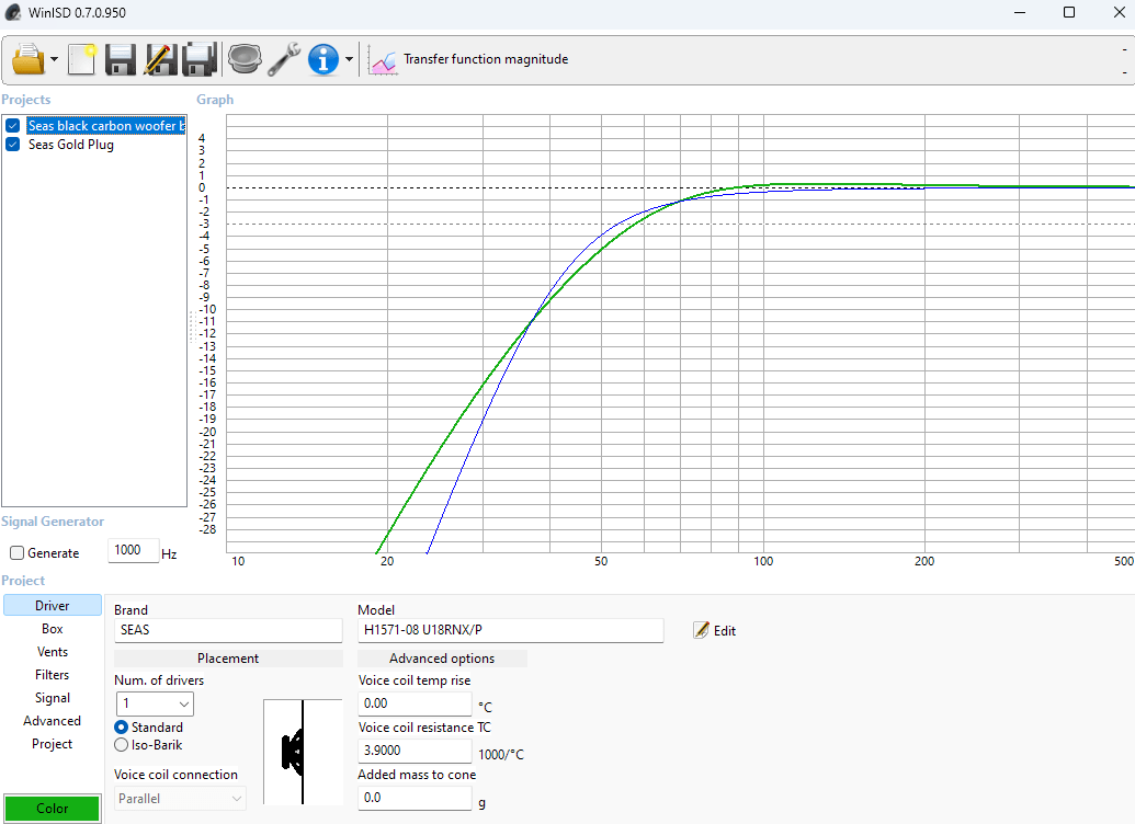

And here are the measurements as promised :
In green we have the Seas Curv 7" with a 650 cubic inch enclosure and in blue it is the Seas Magnesium 5" with a 550 cubic inch enclosure.

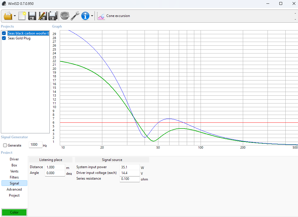

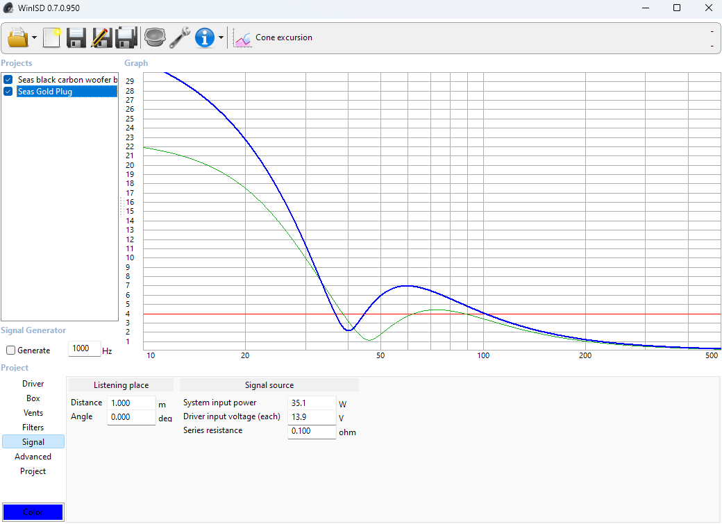

Here is the cone excursion for the Magnesium driver with 35W :
And here is the cone excursion for the Curv woofer with 35W:
For the Magnesium driver I have to go all the way down to 11W to avoid cone excursion at these settings. Also I turned filters off for these graphs. Vents are tuned to whatever WinISD chose, I use butterworth for the preset.
I got the data from louspeaker database, I downloaded the WinISD file for each driver.

Hmm why not? It involves a lot of glue, which is generally stronger than wood
I have seen many crack, not at the glue joint if that is properly done.
Requirement for thiovker walls and difficulty bracing (not actually, i just haven’t seen it done right yet.
Note that in a small oludspeaker and if you have to have 30mm thick walls instead of 15mm the gross volume increases significantly or you loenet volume.
each translam piece is one full piece of wood, not four glued together
And th esides are a zillion pieces of wood not one.

Tuning is whatever WinISD chose. Its around 40 for both. Any ideas why I am hitting Xmax at 12W on the magnesium drivers?The sims. Box volume? Tuning
Yes I will have it professionally done with some wood that is intended for the purpose. I saw someone using marine grade wood, it might be interesting. I still have research and consultations to make in this regard.I have seen many crack, not at the glue joint if that is properly done.
