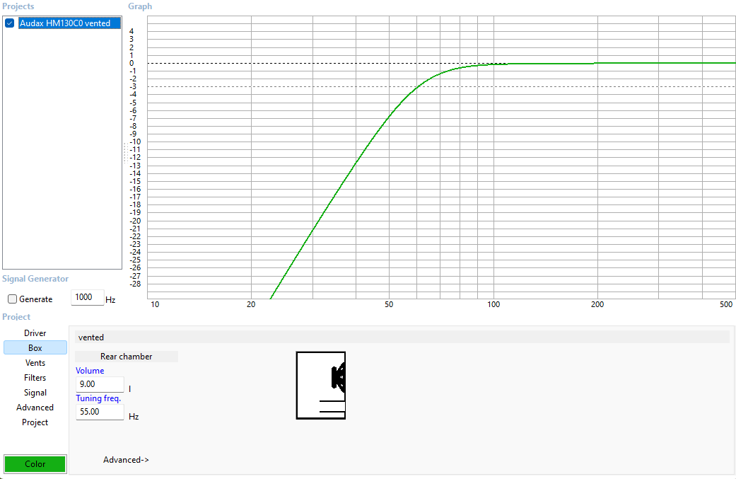

No kidding. Here's a slightly better behaved woofer: https://www.madisoundspeakerstore.com/approx-5-woofers/audax-hm130c0-5.25-carbon-fiber-cone-woofer/Yuk.
Here's a sim of said woofer in a 9 litre box @55Hz.

Hmmm, it looks nice, why is the price much lower than the Seas if it is so much better? Btw thanks a lot for simulating that and finding a driver.No kidding. Here's a slightly better behaved woofer: https://www.madisoundspeakerstore.com/approx-5-woofers/audax-hm130c0-5.25-carbon-fiber-cone-woofer/
