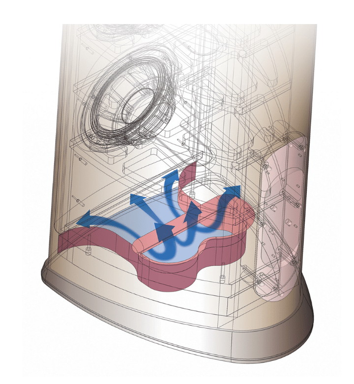

This is very interesting to read Dave, ideally my port would be a rectangular one at the very bottom (approx 0.75 inches by 7 inches) similar to the TAD Reference One). I need to figure out how they calculated their port tho as per this image I am attaching. It doesn't seem calculated like a regular port.I’ll probably get a lot of flack, nut i note that a typical circular cyclinder vent (ie plumbing pipe) does not offer as much control of the bottom as a more resisiive vent. The way i do it gives up a bit of bass extention for greater control, more aesthtic bottom as the extra R seems to make the box more tolerant to dynamic shifts of T/S parameters.

The picture is not that clear… it is not a simple rectabngular vent. Either some exitiuc modeling or a lot of cut and try and measure. Likely the latter.
The vent you plan is of an aspect ratio that should add some R if long enuff. A standard modeler can’t deal with this, over some 2 decades of miniOnkens there is an extrapolation that i make with the sim.

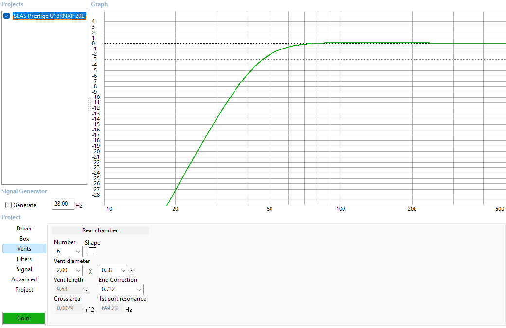

Yes, and you don't need fancy shmancy software to model the behavior.The long high-aspect ratio ventsi use have been shown to work pretty well.
Look like the U18RNXP will work with 6 vents (2.0" x .375" x 9.7" long) in a 17 Litre box, tuned approx. 44Hz.

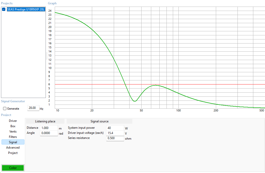

That's a nice curve, thanks for modelling it. What does Xmax look like?Yes, and you don't need fancy shmancy software to model the behavior.
This might be the driver to go with then. I am still very much considering the Excel driver but I am not sure if it is all that better then this prestige driver, and it would cost me a fair bit more. Plus I get more surface area with this one. Thanks again!It looks like this @ 40 watts.
