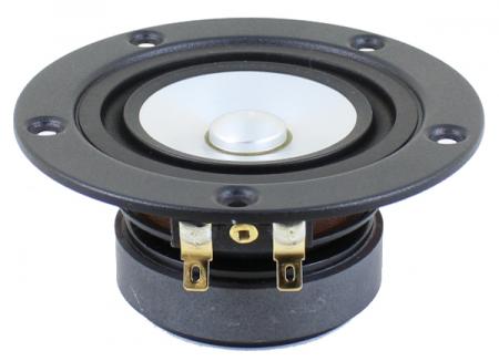

Given the OP’s styateof confusion o would recommend something like CHN-50 in a 2.5ish litre reflex and see where you are. Why that one? Real cheap, real good. WOn’t do a lot of bass, but wiil cost less than taking the SO to a nice dinner. When you finish the learning experience you have a nice set of small loudspeakers that can be repirposed (ir put in abriefcase with a small amp and you have a portable hifi to take with you).’'
https://www.madisoundspeakerstore.c...mark-audio-chn50-3-magnesium-cone-full-range/
