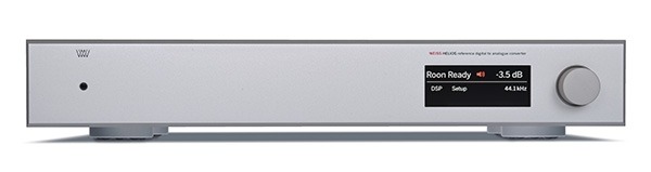

What DAC do you have?

SMSL C200? Beats an old Yamaha interface I had by a lot. But I will use the interface to connect my mic to the computer once we get to the measuring.What DAC do you have?

Has one the chips that is well impelmented can be VERY good. Some variations of them north of $20k.
https://weiss.ch/products/highend-hifi/helios/

SMSL C20
