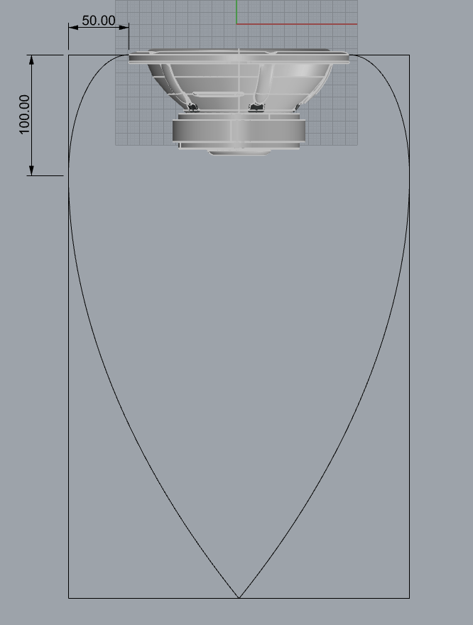

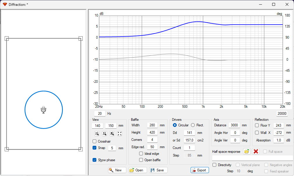

Does this sort of a curve on the front baffle work or is it too steep towards the rear? Measurements are in MM
Edit : I see a similar curve on B&W speakers, and the woofer is quite close to the edges as mine. But Sonus faber that uses a similar shape has a much bigger front baffle to driver size ratio. I saw your older comments from 2021 @planet10 about front baffle, and I saw some graphs, if I understand properly, there is no perfect size for the front baffle, its just about choosing how i want to deal with baffle step in the crossover right? As in different baffle sizes affect different wavelengths right? Thanks

For the bass step compensation, you can do a full correction 6dB or 3dB if your speaker is near a wall. See zaph zrt, all these options are discussed
Baffle is 280x420mm with 50mm round edgeAwesome, my box will probaby end up actually being quite a bit bigger than I initially thought. Looking at 27L at the moment without counting the bracing or anything. I will try and reduce a little.

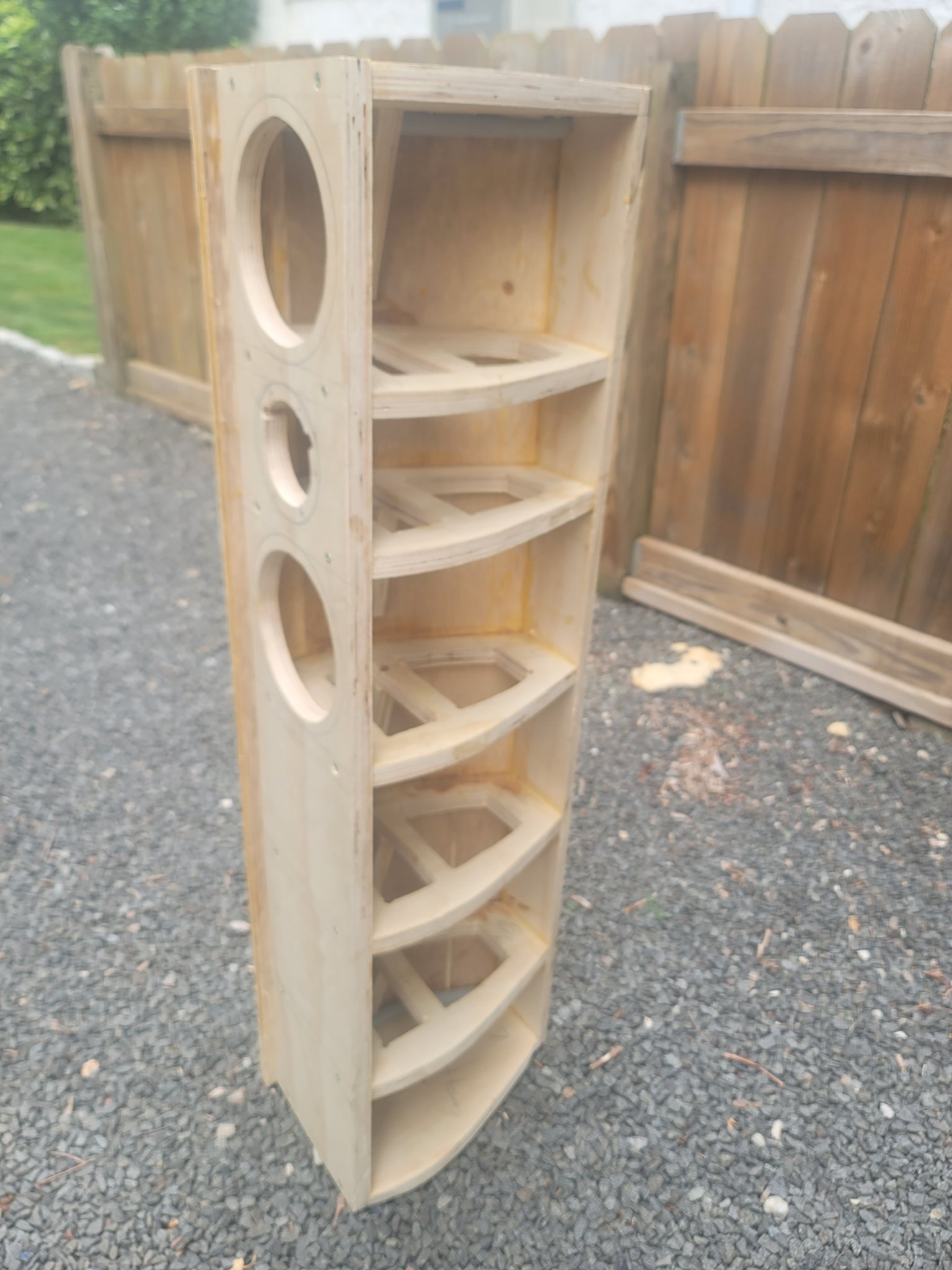

Yep thanks Dave, I have seen a few made like that, and I know TAD, the company I was initially copying for the translam, they also moved to this method after the translam reference ones. Bending small pieces of soft plywood doesn't seem as difficult as I initially thought. I don't know if I will be building the cabinets myself so the final design will depend on what method will be recommended by whoever might build them. I have a decent amount of experience and all the tools, but I have friends who would probably be quicker and make less mistakes than me.

hmm that front baffle is 100mm larger than my design. Is the 50mm round edge included in the total width of the baffle or is that additional please? Thanks a lotBaffle is 280x420mm with 50mm round edge
Yes.
dave
Ah well in that case, those are actually exactly the dimensions of my box. Thanks a lot @shadowplay62 .Yes.
