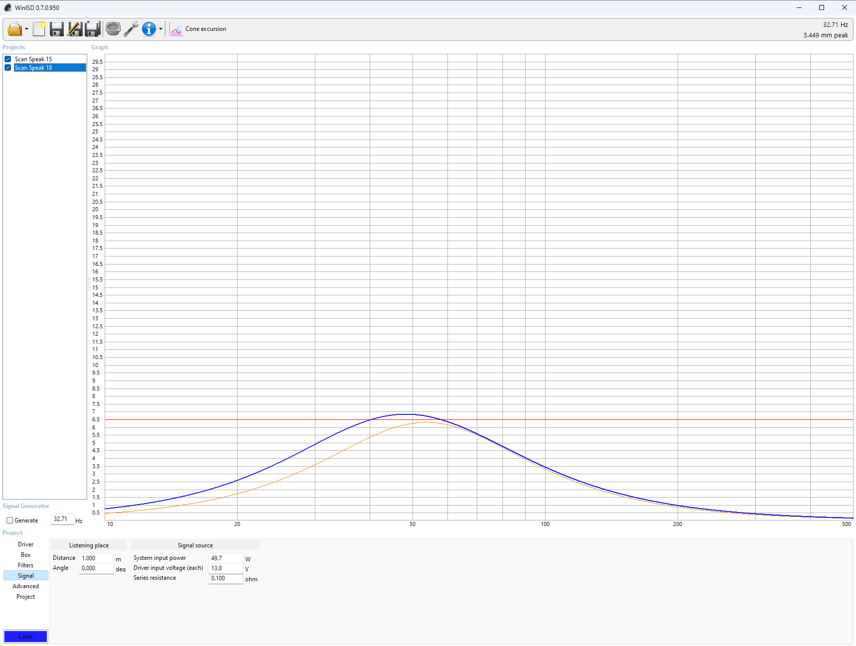

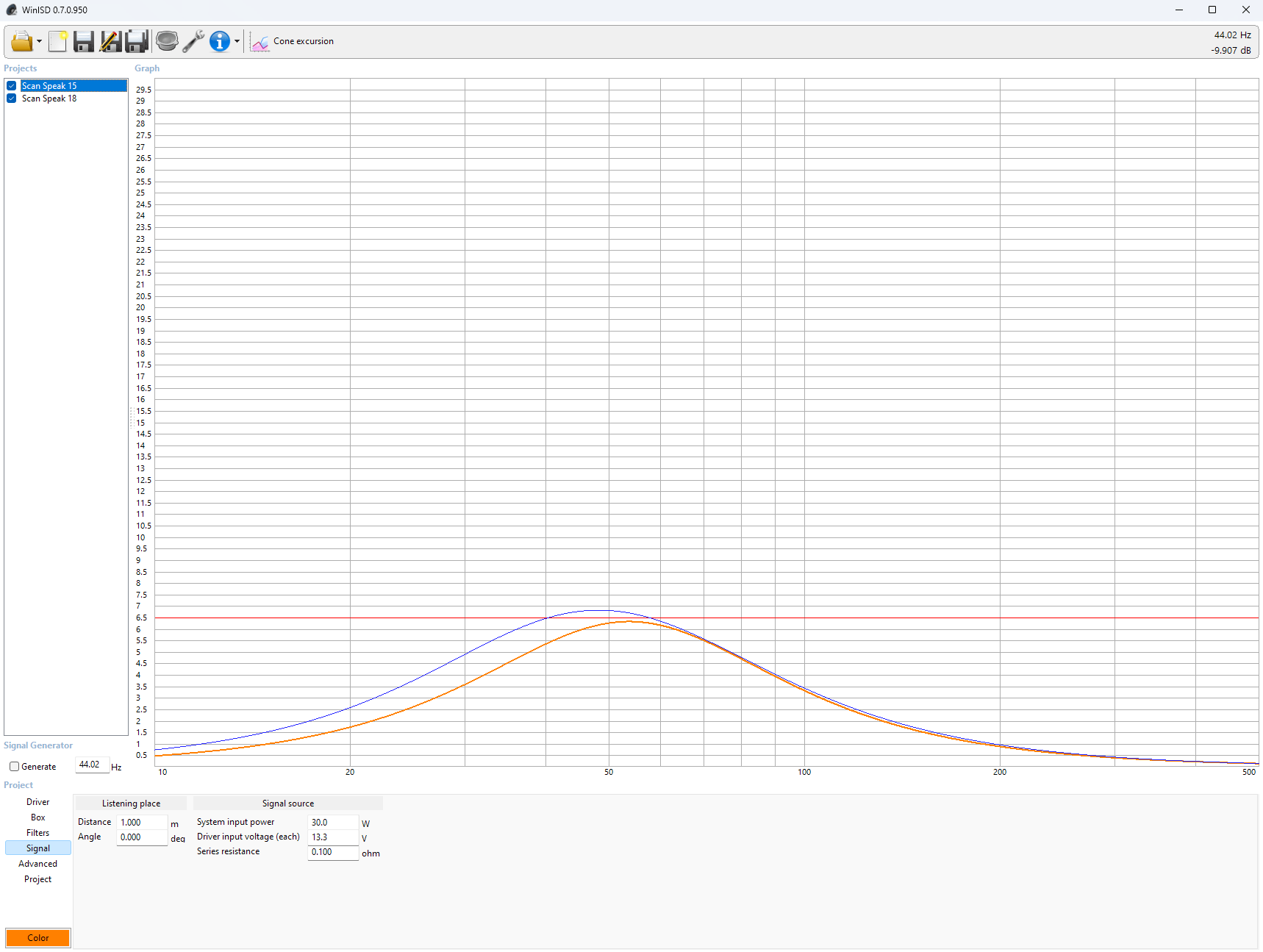

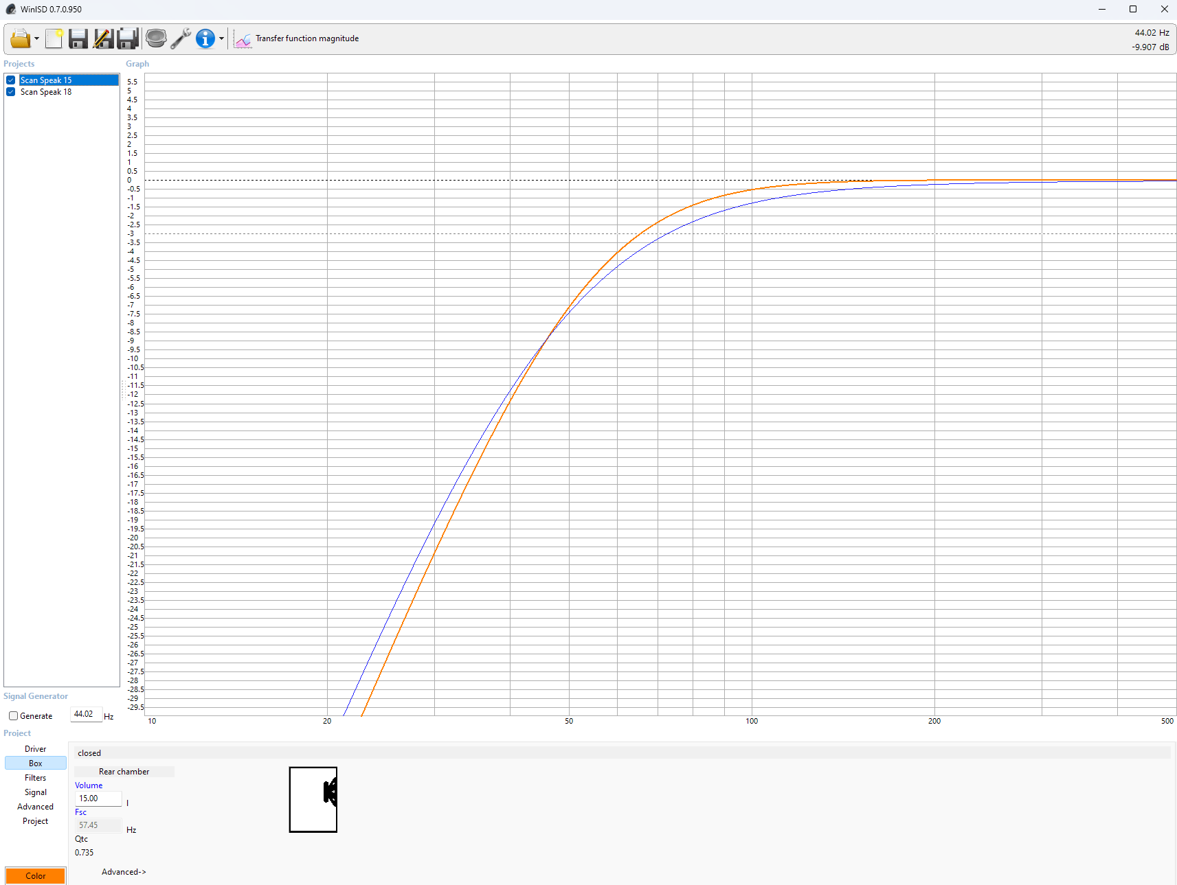

I did some comparing, it seems that the 15 might be more interesting to me than the 18. I calculated the 15 in a 15L enclosure and the 18 in a 20L enclosure.
The 18 can handle 50 watts without exceeding cone excursion with a 40hz highpass filter appplied. The 15 Can handle 30 watts with a 50hz highpass filter applied. Being able to reach 50 watts is nice but maybe not necessary. If anyone has an opinion on this please let me know.
The 18 has an F3 of 72Hz, and an F6 of 55Hz and an F10 of 43Hz.
The 15 has an F3 of 66Hz, an F6 of 53Hz and an F10 of 44Hz.
So I think the 15 would be more pleasing to me because it reaches a decent amount lower. And you guys said it will also potentially crossover higher and play better midrange.
Another advantage is that I can make a lighter and smaller box for the 15.
I have never had speakers that small tho, am I making a compromise by only being able to handle 30 Watts?
Thanks, here are the graphs.

Alright thanks a lot, I'll get a 3D model and some baffle dimensions with those smaller ones.I've run the 8530K00 in a 2way in my living room, and been happy with 30W.
At nearfield, you'll need a 3rd of that power.
