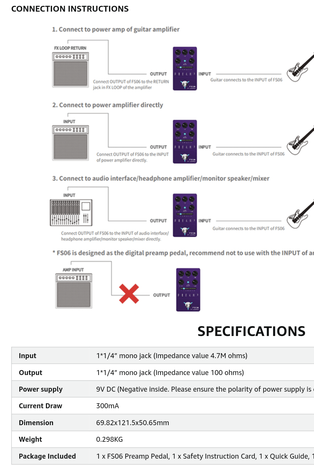

@leadbelly , @Randy Bassinga - you are probably right: I did not consider that the unbalanced pedal output may not need hi-z input in the mixer. I assumed that I should treat any unbalanced pedal output like hi-impedance, similar to the raw output of passive single coil pickup.
But all pedals have active power and may be able to drive enough power into a regular mic input... Is that so? Could somebody confirm or deny that?
(There is no such thing as "neutral setting" on my fuzz but that is a minor concern since I'm going to use flamma anyways.)
Hi-Z input on the mixer would still be convenient but if the above is correct, it definitely moves it from "a must" into a "nice to have" category!
It looks like @Randy Bassinga and @leadbelly are correct: I do not need hi-Z input if I use flamma fs06, see the screen shot!
