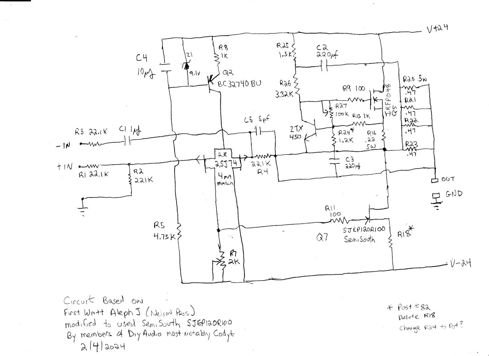

Hi Folks
I was ask to update this thread after Elwood625 help me select the Aleph J circuit for the SemiSouth SJEP120R100 that was gift to me in this thread.
In post#82 it was mentioned that R18 can be jumped and also R24 value should be experimented with. What will be the best solution to measure the current at the output stage ? Measure the voltage across R16 ? or place an ammeter where R18 used to be and place a switch to jumped it when done measuring the bias ? For R24, should that be changed to a 2K pot ? Also, is the best solution to turn on "thump" is to use this soft start circuit ?

- include 1Meg from neg input to GND, that 1uF cap still needs somewhere to be bled to, in all circumstances, just for giggles if not all practical reasons
-instead of zener-BC critter CCS - use ring of two CCS; on my side of pond, usual parts for that combo are BC556 and BD140; better sleep, wider green, lily must be gilded
-put 5V6 zener across C-E of small bjt in Aleph CCS; see enclosed pdf, origin A. W. Newby
-trimpot in 2SJ drain is way too big; 2SJ having 4mA Iq, SS needs no more than 1V5 to be fully open; depending of SS source resistance (yes or not) make your calc; pretty much 270R as fixed resistor, in series with 200R trimpot is all you need
I'm sure there are more things, but - first morning coffee, yadayada

Zen Mod thanks for the article. This is my first foray in building a DIY Solid state amp, I have built tube SE and OTL from scratch in the past. Building this is a great learning opportunity for me.
1. I will put a high value resistor at the input of the 10uf cap.
2. The change of CCS for the Toshiba Jfet to the "Ring of 2", I had Bard AI explain how that works. I will implement that change later. Since I already have the parts for the DiyAudio store Aleph J board.
3. Trim pots(R7) for Toshiba 2SJ, I used the schematic on Post # 81 as the base for my hand draw schematic; I notice that the original schematic (DIY Store) had a 1K resister in parallel with the 2K pot. Which essentially making it 666 ohm pot, which is much closer to the value that is being suggested. It had a added benefit of protecting the circuit if the pot goes bad. I will put the 1K resistor in parallel .
4. Since I going to omit R18 the source resistor, What will be the best solution to measure the current at the output stage ? Measure the voltage across R16 ? or place an ammeter where R18 used to be and place a switch to jumped it when done measuring the bias ? For R24, should that be changed to a 2K pot ? Also, is the best solution to turn on "thump" is to use this soft start circuit ?
