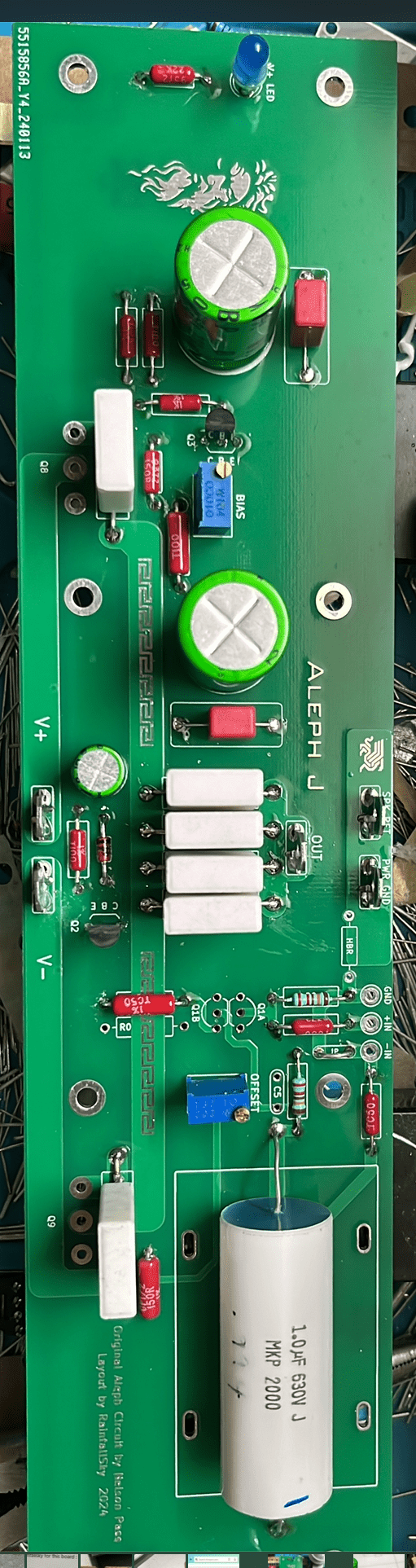

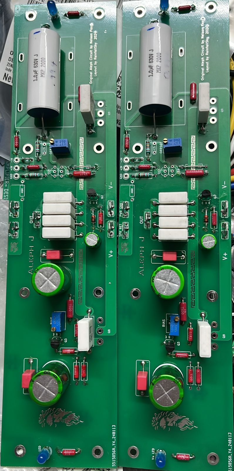

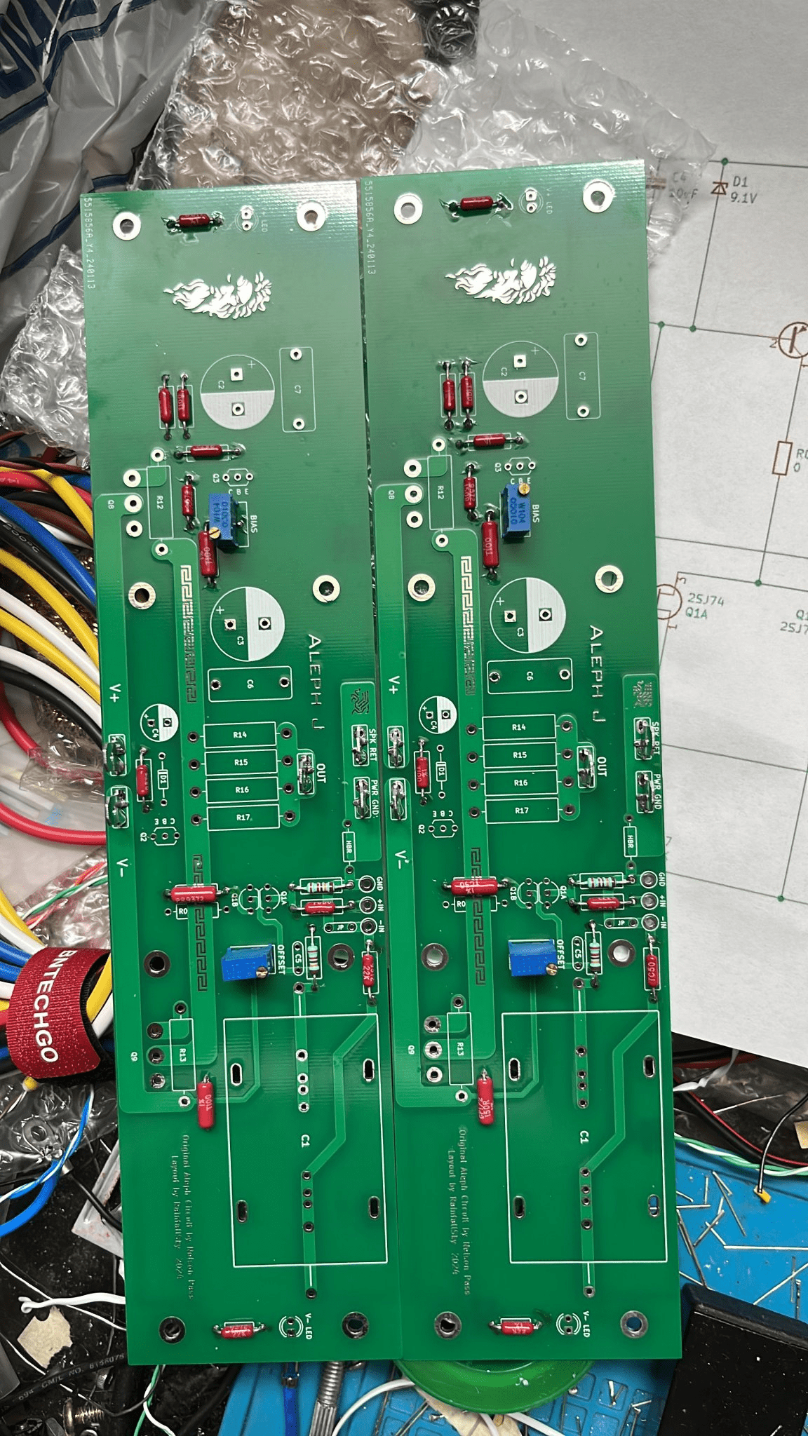

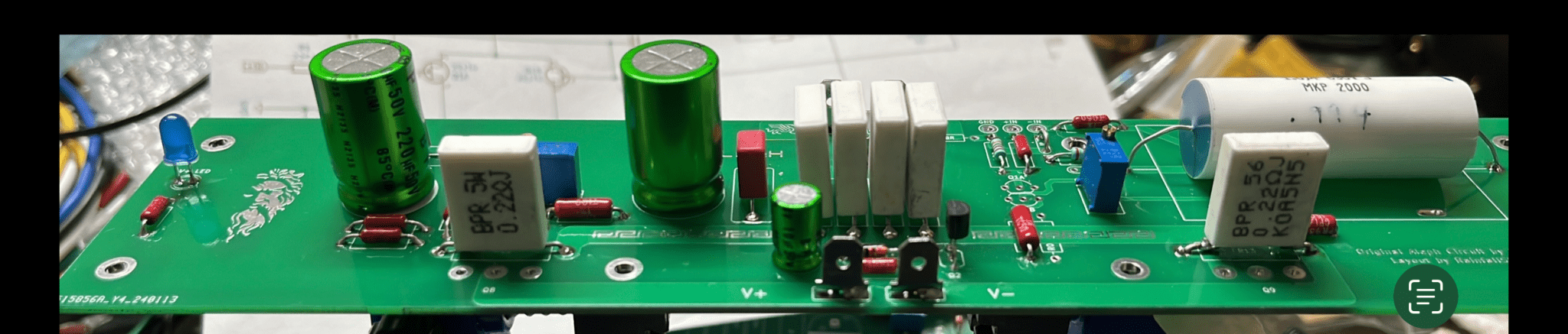

Thanks to @Ylab for sharing pair of boards laid out by @RainfallSky, progress so far as plan is to build per the original with IRFP150 mosfets.

I can offer that these boards sound excellent with other FETs in the output locations. I wrote about my build a while ago.
The IRFP150 would still be fine in the upper (Q8) position and something like an IXTQ36N30P or IXTQ75N10P in the lower position. The higher Vgs at Q9 may be accommodated readily if the J74 JFets are on the higher end of the 'BL' grade.
The high transconductance FETs will be different than the SS, but have a unique sound that is worth a build.

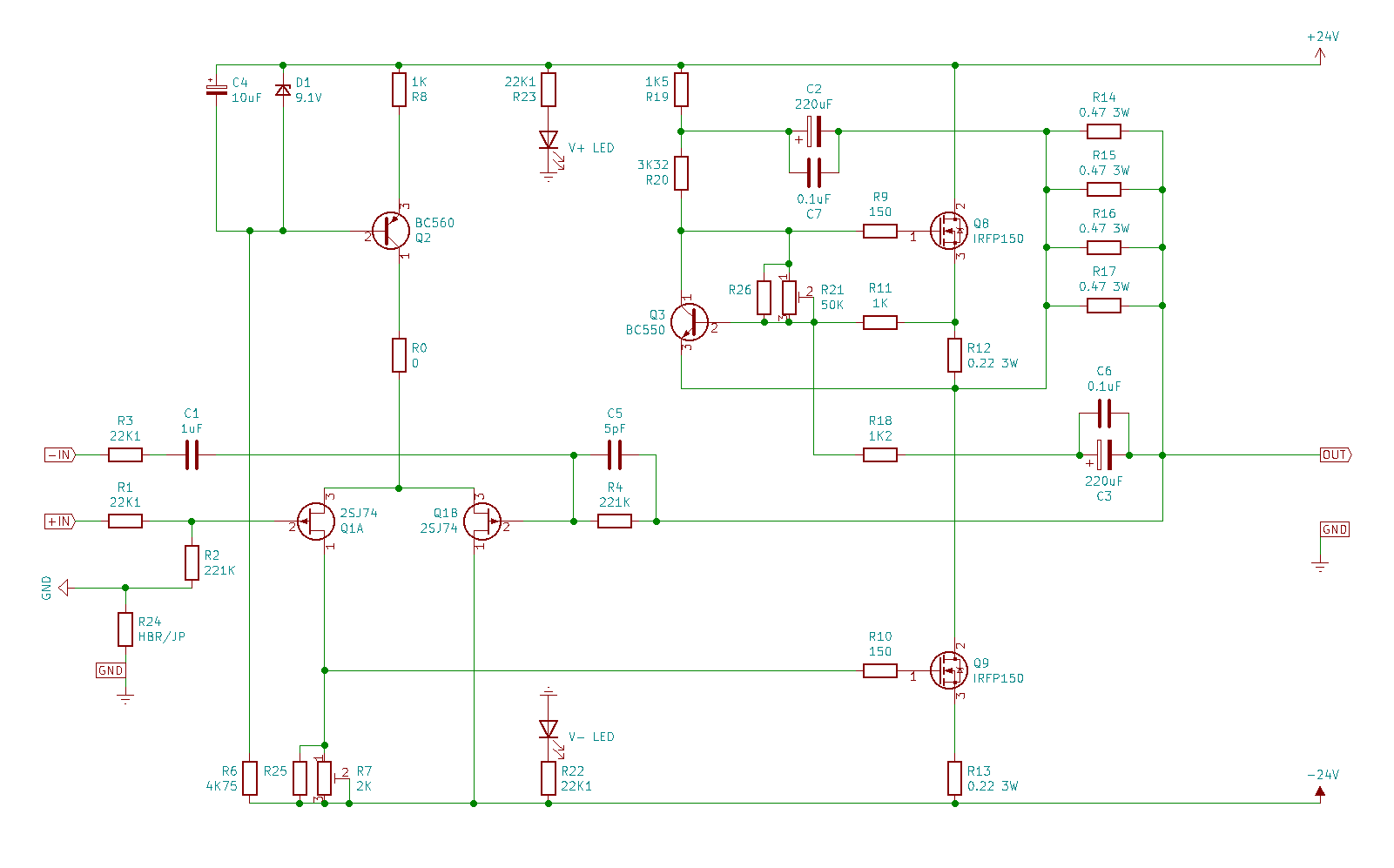

I will upload 2 versions when I am at home.

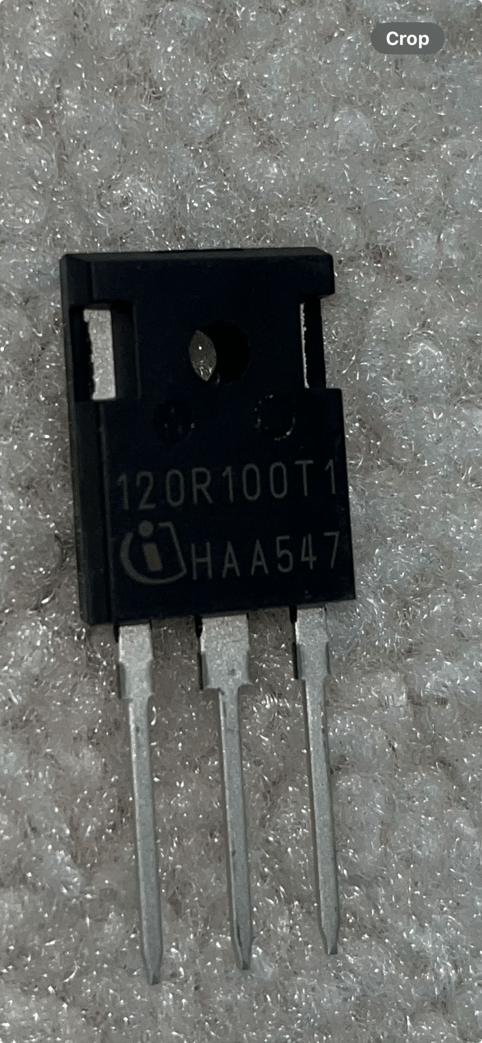

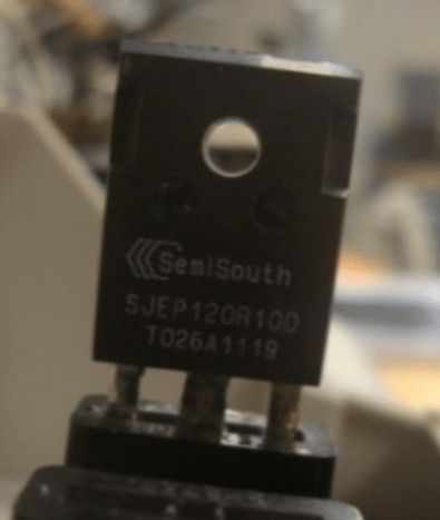

P.S.: A few spice tests with SemiSouth SJEP120R100 and IRFP240. (I don't have a good model for IRFP150)
1. R12,R13 - 0.22 Ohm, Q8 - SJEP120R100. Q9 - SJEP120R100 = R21 need 5K to reach 2A bias.
Good pot value would be 5K preset to 3K before solder.
2. R12,R13 - 0.22 Ohm, Q8 - IRFP240. Q9 - SJEP120R100 = R21 need 22K to reach 2A bias.
At 20K it reach 1.92A bias.
Good pot value would be 20K or 25K preset to 14K before solder.
3. R12,R13 - 0.22 Ohm, Q8 - IRFP240. Q9 - IRFP240 = R21 need 33K to reach 2A bias.
At 25K it reach 1.87A bias.
Good pot value would be 25K or 50K preset to 16K before solder.

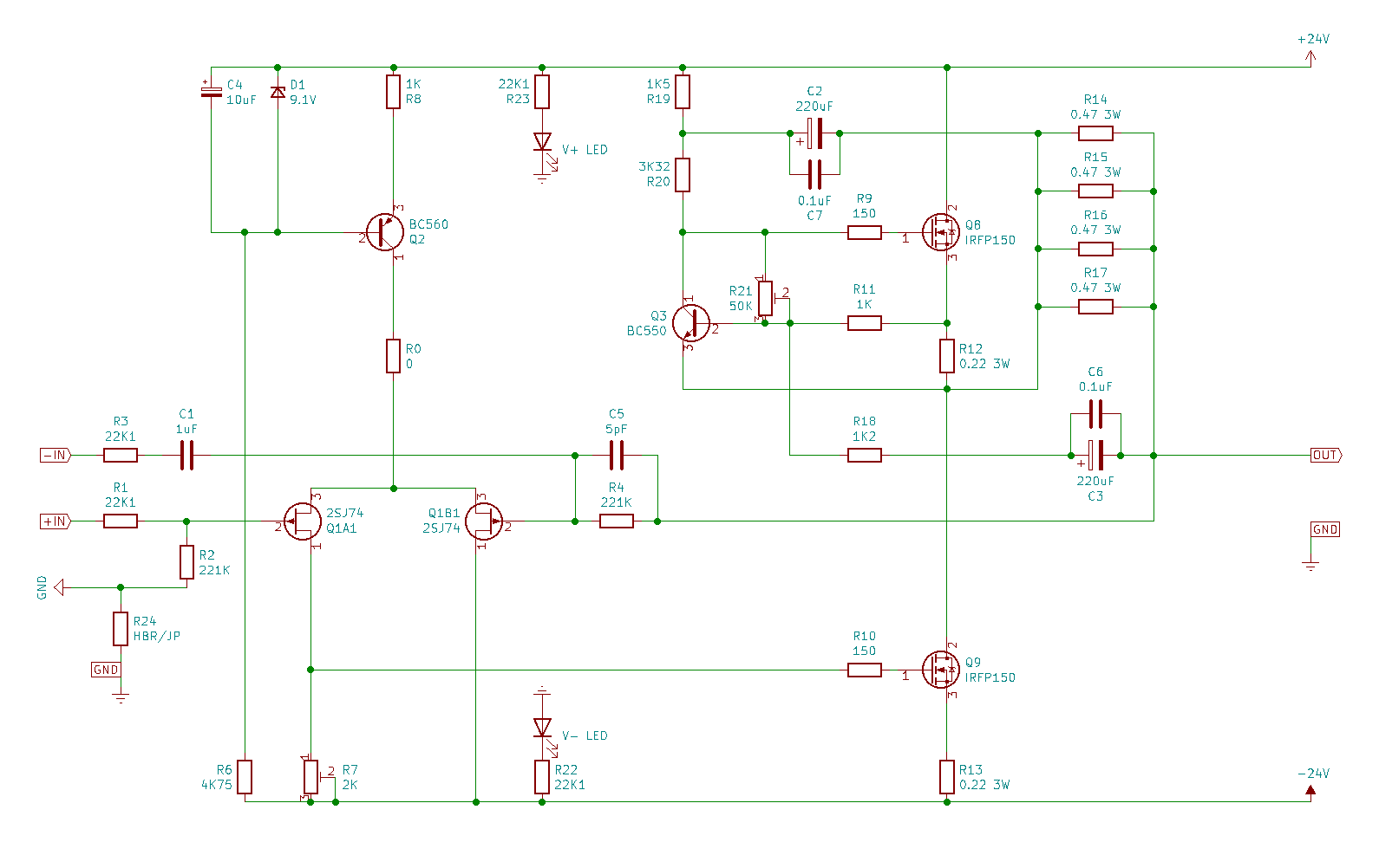

Can somebody point me to the gerbers for these boards or if anybody has a pair they are willing to part with I would be grateful.
Here is the gerbers file and schematic.
I will upload another version tomorow.
I was asked if I could add option to change pots with a fixed resistors.
Attempt was made but I left it on another PC.
  • Aleph J V1.22.zip
