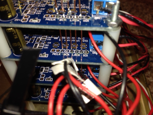

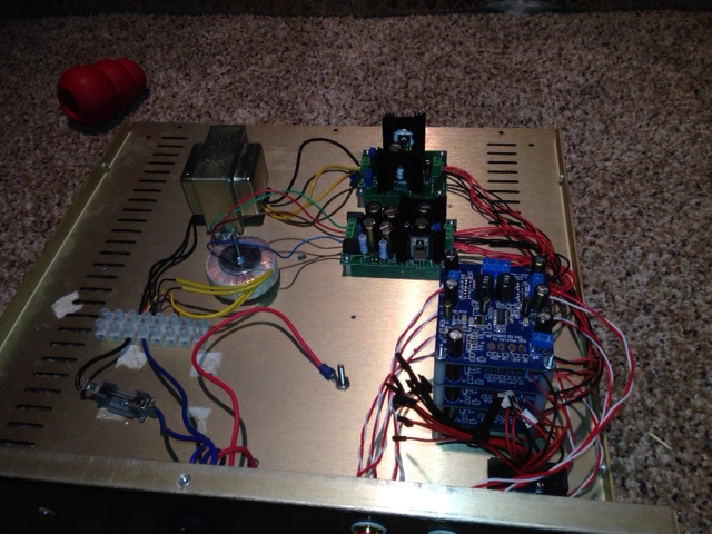

After ordering the wrong thing from MiniDSP (a MiniStreamer); and finding out "no refunds", oh well, I ordered the correct thing (a USBStreamer) so I can do ADAT. After much fiddling, and about $350 invested (not counting idiot purchase of wrong items !) I am pleased to report I have JRiver playing and a basic crossover set up. There is a learning curve here, and I have much to learn. I may have finally found my very low noise Nirvana because of my Balanced outs on the "DAC" (a Behringer ADA8200).
Now, how to import REW data into there...
