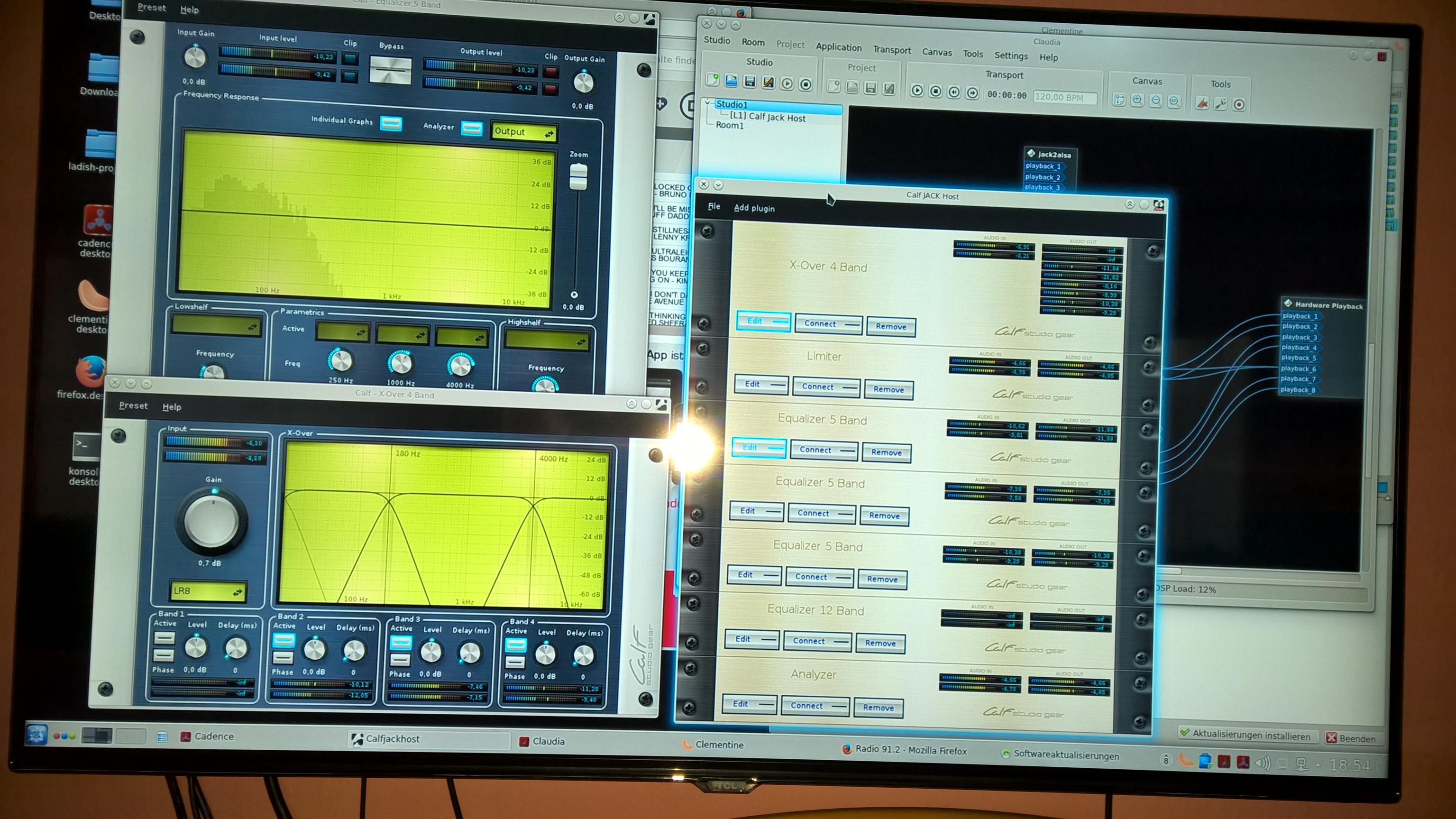

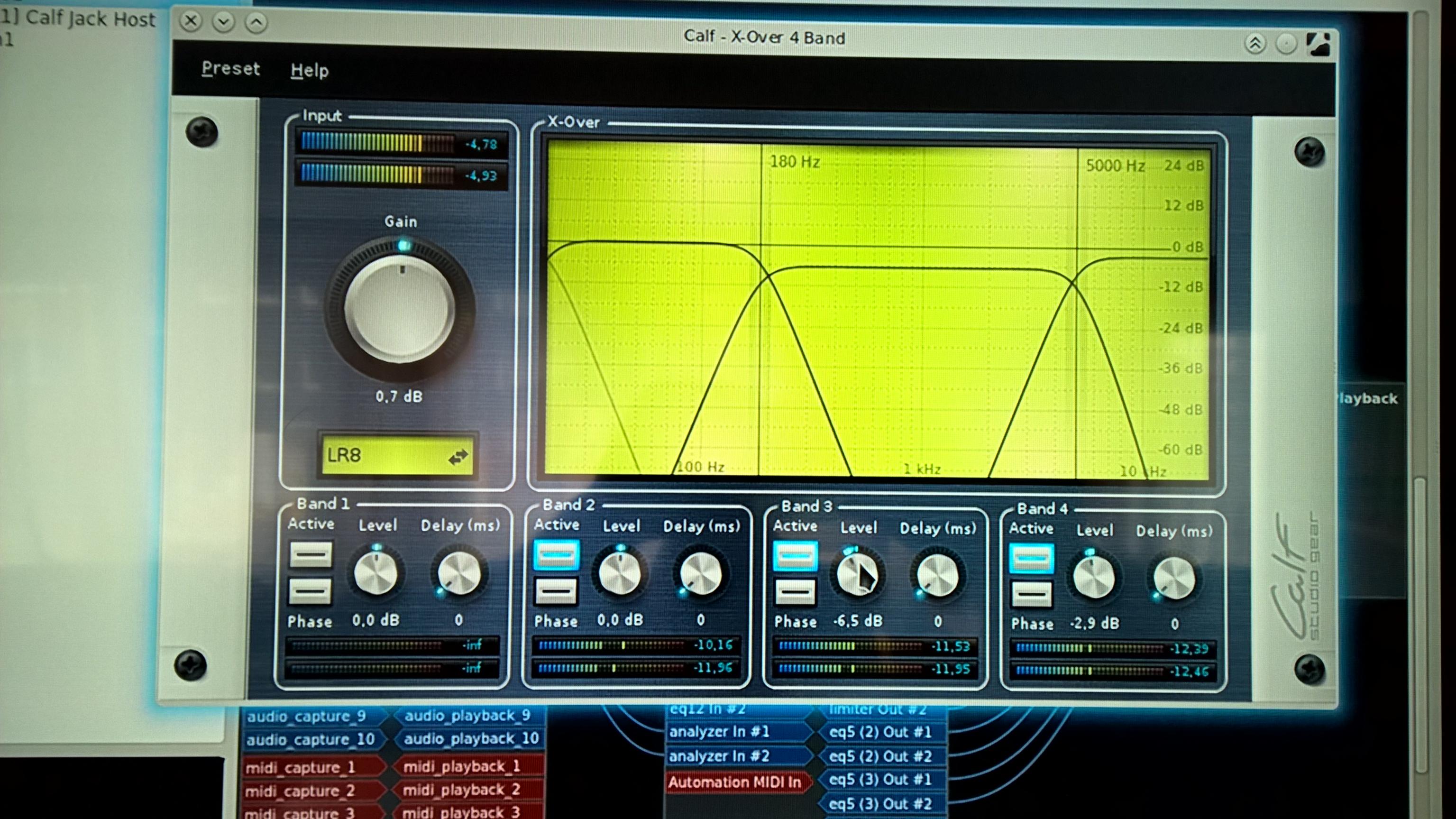

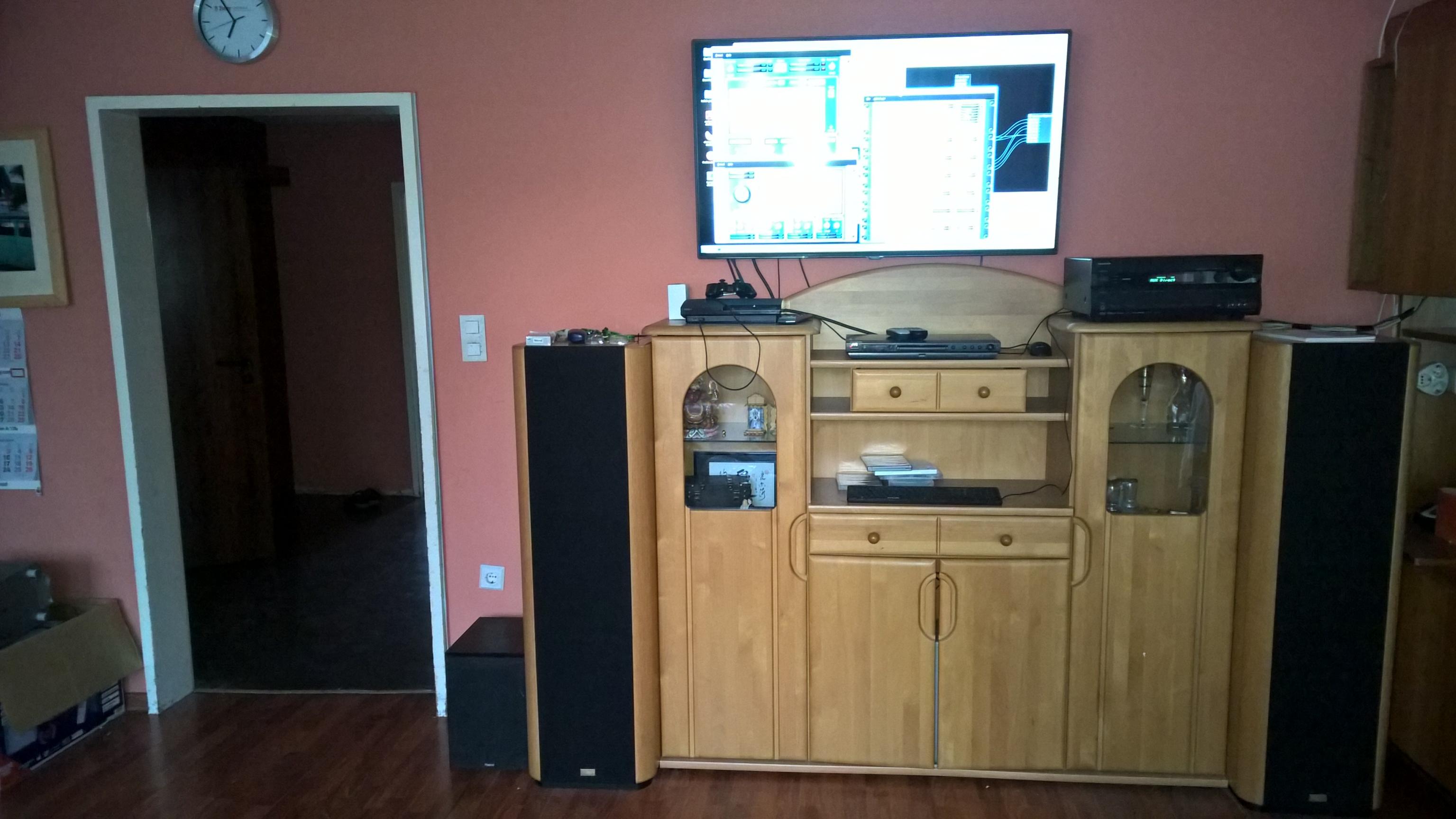

here some Pictures to give you an Impression of my Setup with x-over and activated Vulkan Chassis
X-over frequences shown here were experimental. Now I have found better ones. (180 / 3800)
Also I have activeted Equalizers and limiters in my dsp Setup

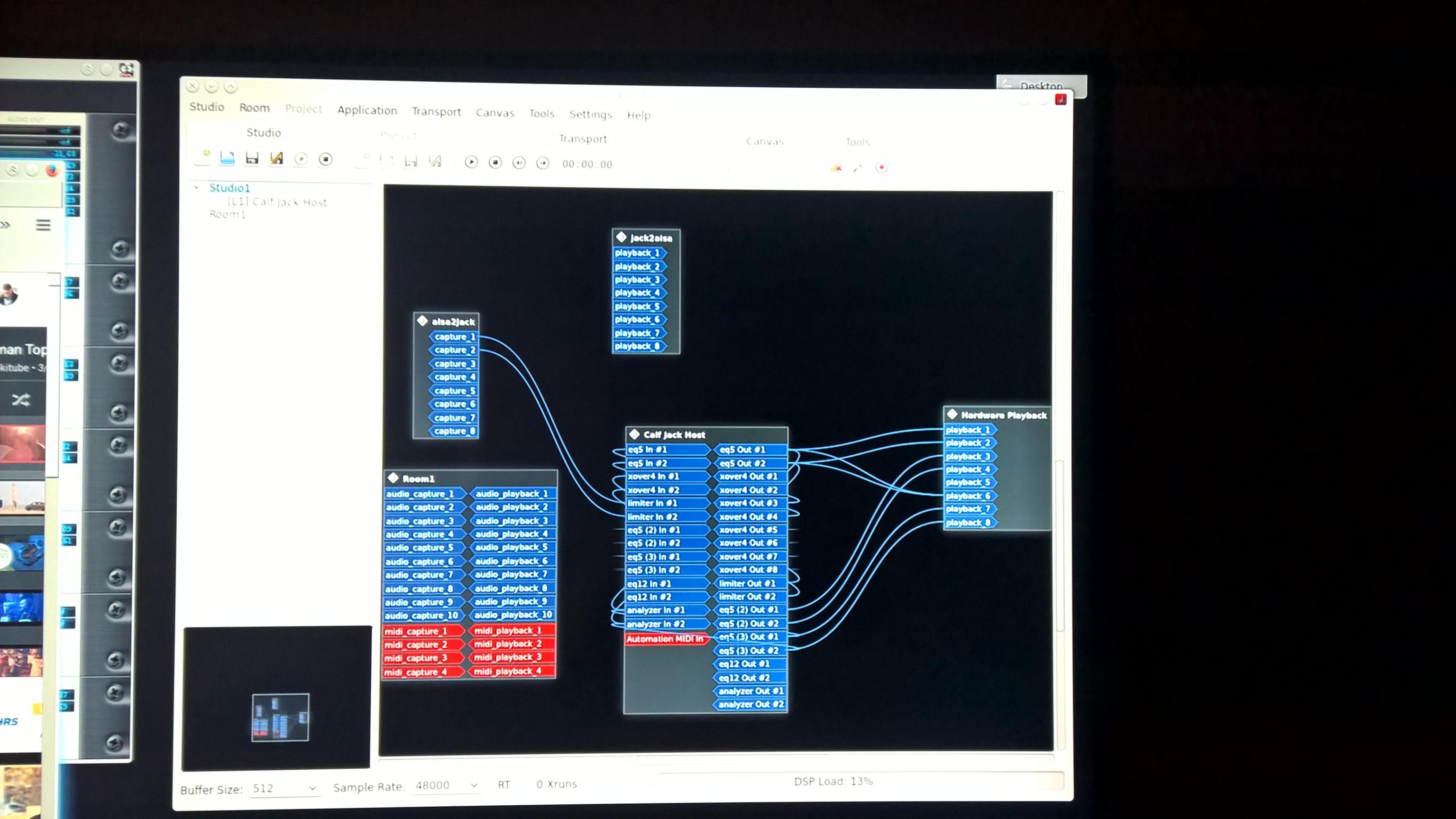

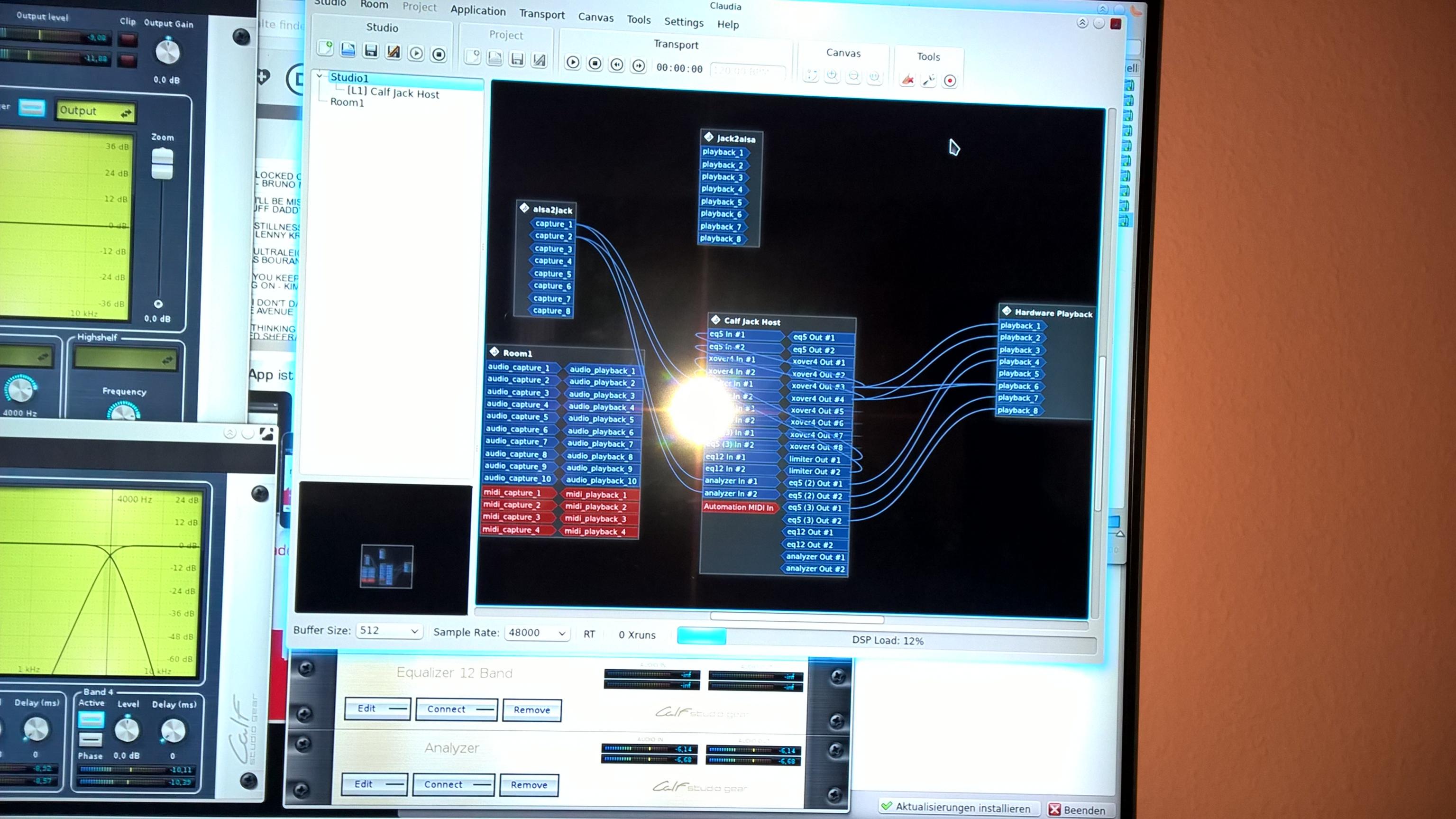

The "spaghettis" are a result of my channel Setup in JACK, with Crossover, Limiter, Equalizer and Analyser. Normally you don't need all of this. Ist nice to have and adjust Sound if you want. The limiter is good for high Level Sound. Most important is the Crossover channel mapping. Then it looks easy.
And of course I use one PC for all my needs .That means DSP, HTPC, Fileserver, ssh Server (to connect from outside).
Audio is via HDMI to the AV Receiver with 8 channel. DAC is done by the AVR.
