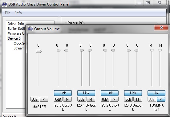

It's like this?

Can you show to us how the usbstreamer is presented in Windows?
Is one device with 8 channels and another with 2 or is various stereo devices, or is a 10 channels device, or...?

It's like this?
Yep. The card that's used as the default Windows device doesn't need to be multi-channel, though most are.
