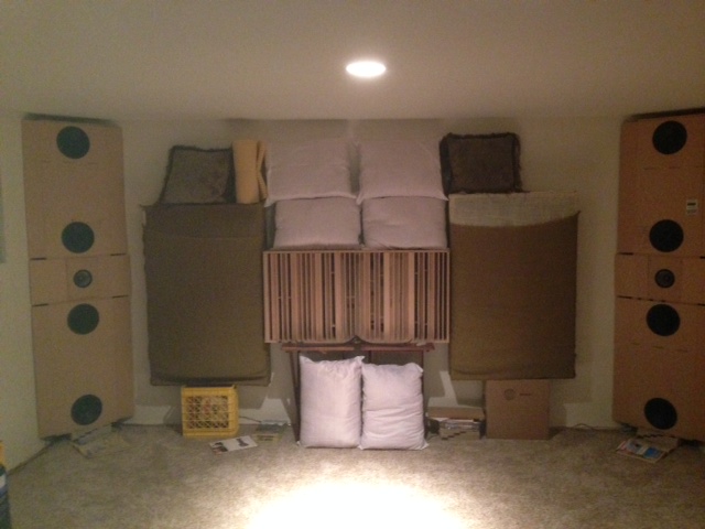

Will put up pics of the speakers. Should make it clearer. First impression is really good. That front wall has disappeared.
Here's a pic of the speakers. There is a quadratic residue diffuser in the center and some thick absorbing panels. Earlier, I had just the KEF cab sitting atop a small tower cab for one of the 8" drivers. I had shoved the speakers in the corner and it gave a nice sense of depth.
With this new setup, the front wall completely disappears. There is a great sense of envelopment and a feeling of being in a different acoustical space. The goal with this speaker design was to eliminate ceiling and floor reflections. It is supposed to be an expanding array with the array length increasing as the frequency is lowered. The outermost drivers have a LP at 125 Hz. The two central drivers have an LP at 500 Hz. And the KEF coax has an HP at 500 Hz. Then there is a passive crossover between the tweeter and the mid driver in the KEF Q100. The KEF Q100 is a truly amazing unit. Really smooth response.

By putting it in the corner, you get horizontal control down to low frequenciesas well. Plus, no front wall reflection, at least not of the first order.
There are a lot of things to improve. A proper crossover would be a start. But even with this crude one, there is a lot of promise. I am using cheapo $8 Jamo buyout drivers from PE. These could be improved to something better, maybe from the SB Acoustics line. And distributed subs would be good too. All in good time.
