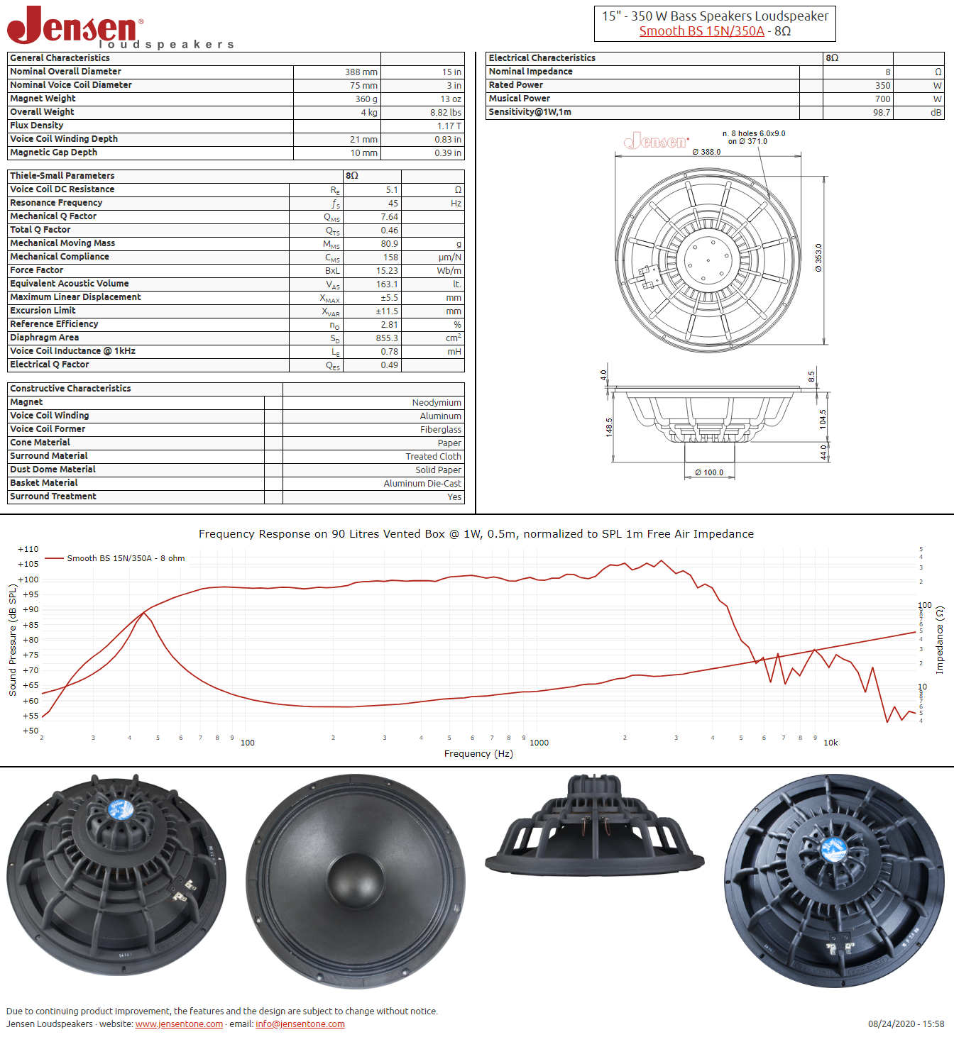

Current woofers are Sicas with 3" motor and light, uncoated cones.
I've a weak spot for semi-instrument woofers, like the old JBL E-145, some Electro-Voice, Celestion drivers, as well as the Fane Studio series.

That jensen model could be fun to try
