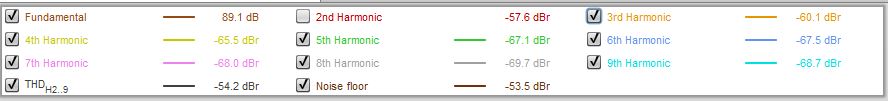

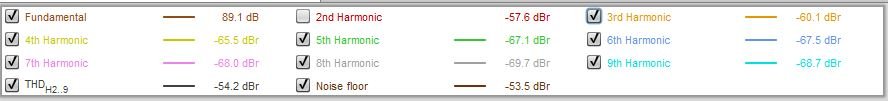

I will drop some measurements. I will measure the Faital also with higher level so the H3 can be seen more clearly.
The td-4001 diaphragms are god knows how old, not in their prime anymore perhaps (H3): td-4001 distortion - Google Search
Measuring distance 50cm, 0deg. No xo, no eq.
Distortion plots were measured from the mouth (same drive voltage as in 50cm measurement):
![CZ4EuyR.jpg](https://i.imgur.com/CZ4EuyR.jpg)
![8nh9zNI.jpg](https://i.imgur.com/8nh9zNI.jpg)
![sTSJZn4.jpg](https://i.imgur.com/sTSJZn4.jpg)

i too have been conducting some testing on my TAD drivers as well over the last few months, so i am happy to find some reference points against which i can compare what i am seeing. in my case, on the 4001s i am seeing much lower distortion than that. this was measured in the mouth of the horn as well (REW). these were used drivers, i couldn't break the seal to get the back off to inspect the diaphragms but i suspect they have never been opened.

Thanks for the plots! What wonders me first is the strong peak for the Be driver below 20kHz. This should not occur as Be has it's first mode around 26kHz. What equipment and especially what microphone did you use for the measurements?
Anyway, I would say the clear winner is the TD-4001. More linear, especially not this strange region starting from 1k5. Much more HF output. Less and more evenly distributed distortions.

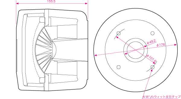

The Faitals 1,4"->2" throat adapter is 77mm long and conical/straight flare. Td-4001 has built-in throat adapter which is 75mm deep (to the fly net, cannot see deeper) and is also 1,4"->2" conical flare. The reason for 77mm long adapter is that I wanted to emulate the tad, for which the yuichi horn is specifically designer for.
I had actually read that td-4001 built-in adapter is 64mm (or 65mm) long and the expansion 1,5"->2", but this is not the case (I measured 75mm/1,4"->2" this morning). The expasion rate is the same however (~13deg iirc) and I got the throat adapter for faitals "close enough" also by using the wrong information regarding the tad's built-in throat adapter. I would have made the adapter 75mm long if I had known (should have measured myself but would have required detaching them
To be precise, the internal throat section of the TAD TD-4001 driver is actually conical, 74mm deep, and goes from 36.7mm dia (1.445") to 49.2mm dia (1.937"). The included angle is thus 9.7degrees and the equivalent exponential flare rate is 217Hz.
These are old Japanese measurements straight from an MJ magazine article.
