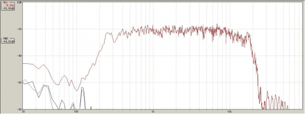

The only thing that buggers/puzzles me is the 1,3khz dip with Faital. I dunno if the 1,3khz dip is due to Faital's own structure (some resonance?), Faital/Yuichi compatibility thing, or Faital's Qms/Qes is little bit too high to drive the horn as uniformly as Tad. I might test a less deep throat adapter what it does to it.
But very excellent sounding driver it is, just believe me on this one.
The impulse response is very clean due to non-resonant and very low energy storing behaviour of the diaphragm.
Tad has the hf peak which screws the impulse. I wish I still had the Truextent-Jbl measurements somewhere for comparison (in a different horn). My memory would say it also loses to Faital's impulse.

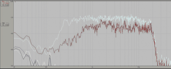

Faital vs. Tad zoomed-in:

Tried the Faital in the Yuichi without the 77mm long throat adapter. The hf response is predictably totally screwed because of the 1,4" to 2" step in the throat, but the 1,3kHz dip is almost gone (at all distances 50cm/100cm/listening spot).
So I will need a less deep throat adapter. 25-30mm long conical or even less?

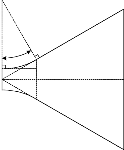

at Faitals official page about HF1440 we can read:
I would read this as follows: The exit angle is nearly zero.
Following the original idea you would need two different sections. The first would be conical from 1.4" to 2" round to round as described for the TD4100 and then to respect the fin orientation with it's origin and opening angle a round to squared section. To do this should not be so complicated.
I assume this first conical section is indented to generate a defined spherical wave front and would also have some loading effects. I know someone who calls this correction section.

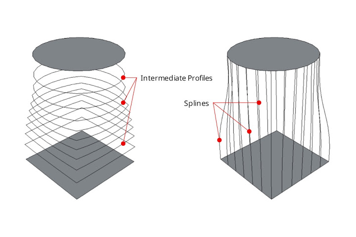

It should be possible to calculate an ideal throat (adapter).
Perhaps a 'negative/inversed' extension of the phase plug, which does have some curvature. A hyperbolic-shaped adapter may work.
In short: splines could be used which are then lofted in order to get a smooth transition to the throat of the Yuichi.

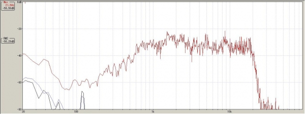

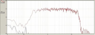

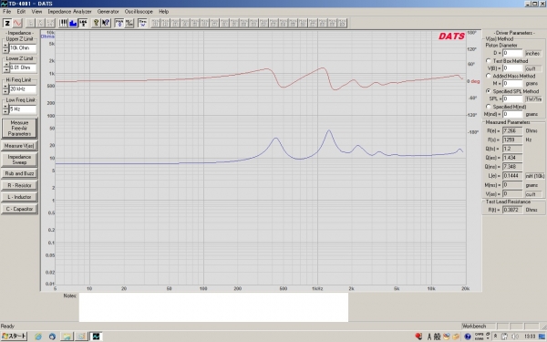

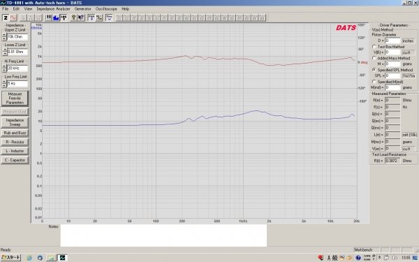

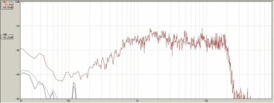

Came across some measurements of a naked TD4001 and attached to an AutoTech Tractrix 200 horn.
Shipping these from Poland to Japan should be horrendously expensive.
Unfortunately, the images are terribly small.
3&4: TAD TD4001 naked
5&6: TAD TD4001 + AutoTech Tractrix 200
7: TAD TD4001 naked vs. TAD TD4001 + AutoTech Tractrix 200
TAD TD4001 + Tractrix 200_sweep from 100Hz to 23KHz, input to the driver is fixed at 200mV, meas.jpg82.1 KB · Views: 577
Naked TAD TD4001 sweep from 100Hz to 23KHz, input to the driver is fixed at 200mV, measured 1m f.jpg82.2 KB · Views: 599

^That is certainly a Radian Al diaphragm used in Tad, impossible that genuine Be would drop that much in laser-tractrix and has an Re of much below 10ohm. Real diaphragm impedance around 11ohm at 5-30hz.
Also the beryllium 'phragm has rising response naked🙂 (hence it is straight even in constant directivity horn)
