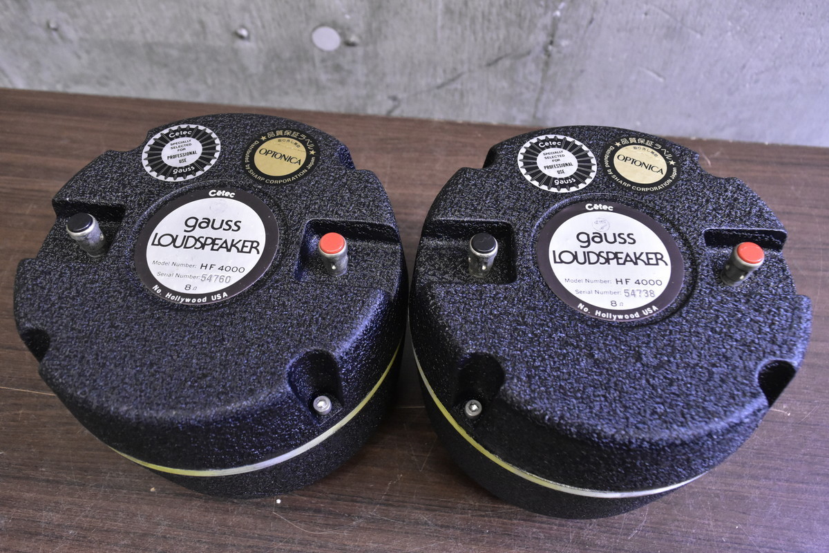

The TAD is impressive. I wonder why these seem to be a "one off" design after all these years?
Japanese autistic level hifi hard to copy or design better? 😀

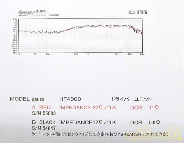

Thanks! I thought you used a protection capacitor. Be careful not to destroy your driver. Then the parallel resistor will not work. Different in a later x-over.
Maybe you have to add a low parallel resistor before the 33 Ohms (or larger). I remember that jmlc has several times exaggerated that a large series resistor flattens the response. Btw. there is some work from Nelson Pass about current source gives a more linear response.
If a driver has some inductance ie. rising impedance then current driving/series res rises the hf according to voltage dividing law. With Faital wont happen because low impedance at 20khz. You can't current drive (remove electrical damping) and voltage drive (offer electrical damping) at the same time so no adding parallel resistors in the mix if current drive is sought. edit. And if the parallel res is before the series res, it does not do anything except increase the amps load.🙂
It seems quite hard to 'steer' the impedance of drivers with permanent magnets, but not suggesting it can't work. With field-coils it's another story.
Perhaps the differences between Alnico and Neodymium also play a role here.

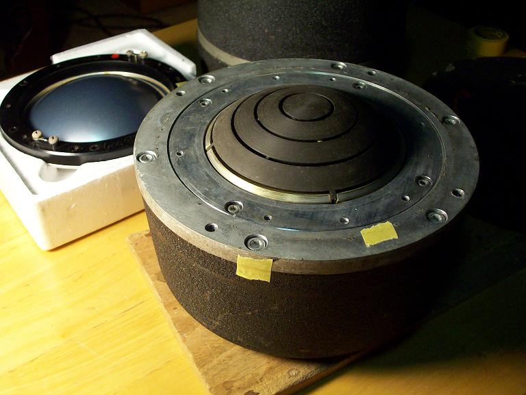

Adding a sturdy felt under both "damping donuts" seems to affect that region. Will have to measure further away also.
(For those who don't own the driver, it's inner space is fully connected together via small slots in the diaphragms felt surrounds.)
Can also be seen in the H2, there is'n a sharp dip anymore. It was as if the driver would "shut off" in this frequency due to some resonance (analogy to bass reflex port resonance).
Don't mind anything else, the level and distance is not the same.
Soon will measure at greater distances. Previously the dip in fr got quite much worse at greater distances.

Initial expressions regarding the felt damp:
Listened full range and a/b comparing two drivers (one with felts) in a horn: "The lower piano notes slightly cleaner with damped one. But is transient snap slightly damped?"
Listened normally the whole system. "Odd feeling something is missing. Maybe it's in my head. Maybe some livelines and see-through thing got hit. Good sound but where is the wow-effect?"
The measured effect is quite small to non-existent with the felts, so they might have to go. Maybe I will try the drivers with very minimal damping or no damping at all in the back chamber/s. Actually I already tried them yesterday without the damping donuts and immediately liked the sound (naked), but the dip got very slightly worse so...🙄 More wooly-like softer polyester felt sounded bad in the small back chamber. Could the comp drivers also follow the same rule (sound-wise) that I feel with bass radiators is the correct one, ie. minimal damping in the back chamber for the best sound.😀
Might be fools' effort, I will go and hang the noose so it will be ready when I need it.😛
The added damping material definitely made thing subjectively worse by sneezing out some life and accuracy.
I'm playing them now without any damping material inside, both stock damping doughnuts and the felts completely removed.
It's hard to believe, because it seems counterintuitive, but the sound is more mellow this way. Life-like fast transients and breathing unhindered sound.
The notion I made against the lower piano notes sounding less good was propably caused by the very good and "undamped" feeling to every resonating sound no matter is it hf or lf on the band the driver has to produce, it feels accurate. It made a wrong impression when listening/comparing the drivers full range without lf.
Even more surprising is that the impedance at hf is smoother without any damping😱. There are less small ripples when zoomed. This has to be related to some delayed energy (from the damping materials) in the air spring that affects the membrane. Maybe this also explains why I feel the sound is the most mellow, yet very accurate this way (after 60mins of listening).
Black trace is the one without any dampng material, the other one is with only stock damping doughnuts (no felts).
(The systematical difference can be slight variance in sound card calibration.)
