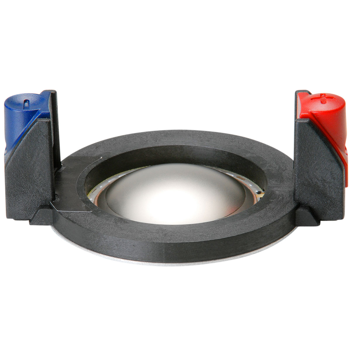

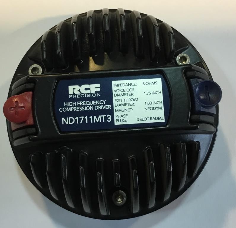

There's an older, less known driver that has a lot in common with the 18Sound 1" drivers. I believe some engineers that later moved to 18Sound were involved in its development.
It's got all the bells and whistles of modern high end drivers, including a 3-slot phase plug, copper demodulating ring and a powerful magnet structure (BL: 8.10 Tm). This driver was also used in a 2 way PA monitor loudspeaker with a low crossover point (1200 Hz).
So I've bought a pair.
Reactions: Gill.T
