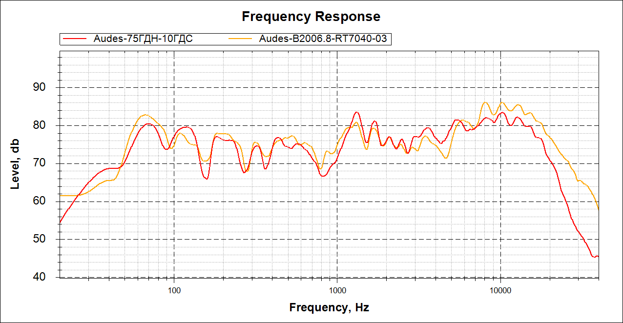

The tweeter is AudioPur RT7040-03 -- 8 ohm
XT25 is generally better but AudioPur RT7040-03 has even more detail and separation of sounds. especially at low levels

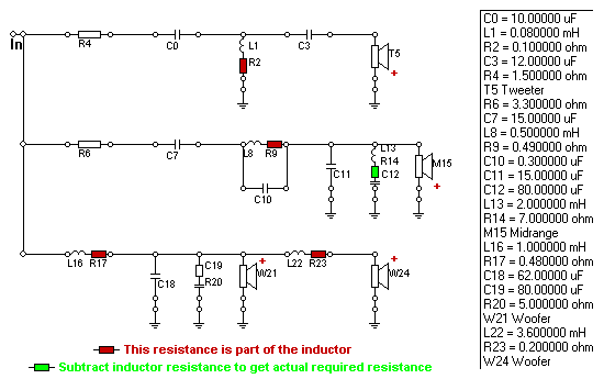

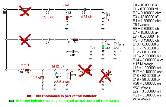

I think I will leave the attenuators and try to copy/modify Zaph's cross-over
I'm going to start with midrange cross-over and take it from there
I think I can get rid of R6; is that the only attentuation resistor?
Not sure about R14
I'm not sure where the 80uF caps came into play in this cross-over
I get a totally different value for the filters
I guess one is a notch and on is zobel or one is both
I have two 80uF caps but not 4
I think I have two 60 uF caps

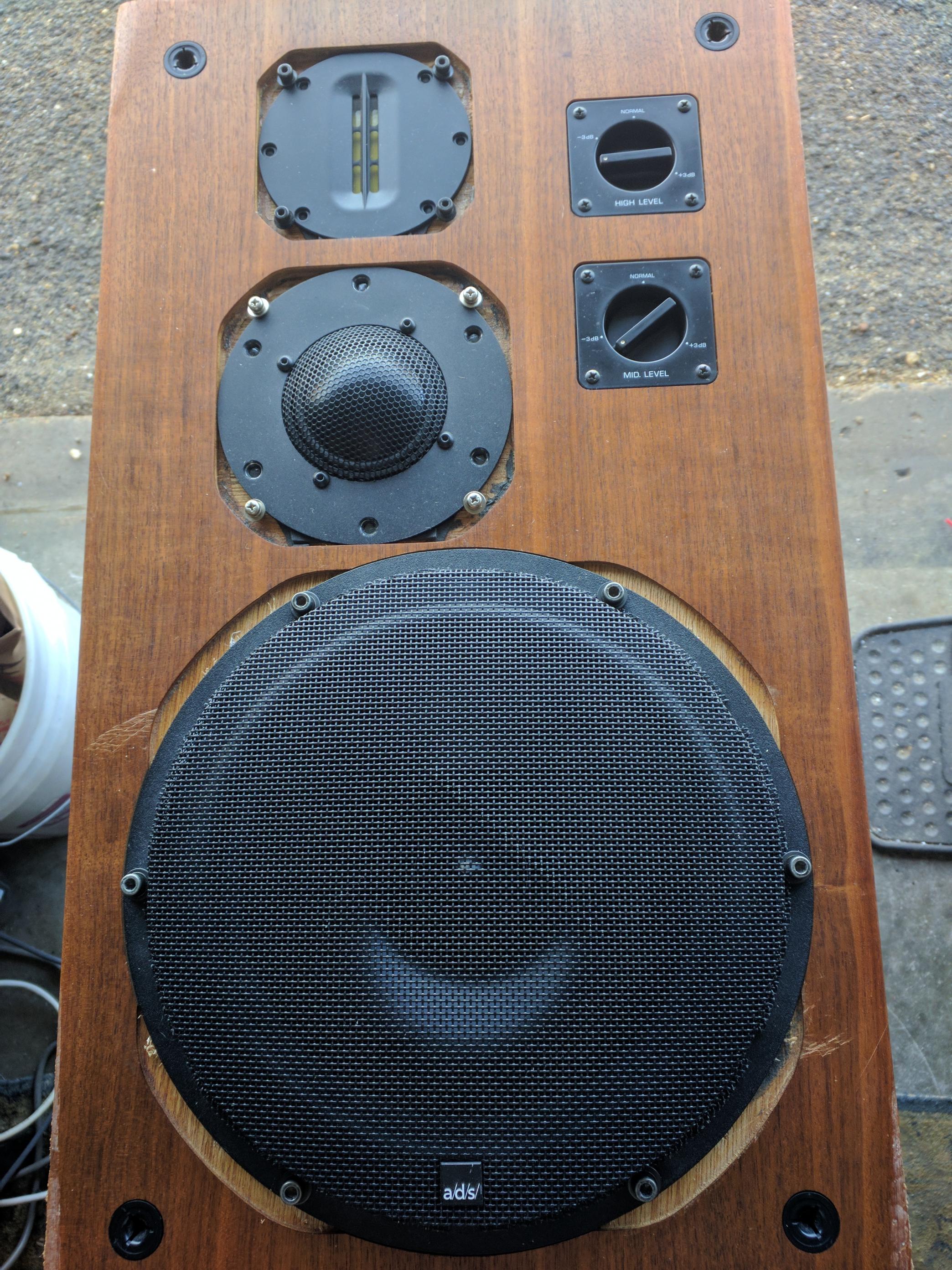

Got lucky on the speaker and found two /a/d/s grills the right size
I forgot how hard it is to modify cabs
It's harder than actually building ones from scratch if you have nice/proper tools and wood

Can I use Rifa Miniprint MP Metallized paper caps for 80uF caps and .3uF caps?
Tweeter cap values don't seem to be ones that I can calculate
I would use 4th order for tweeter but I don't know if 180 degree phase will have verse consiquence, so I will stick with third order for 8 ohm nominal impedance
Woofer section I won't really change
I don't seem to get anywhere close to 80uF for the zobel filters in any calculator

Anyway I'm down to finding the 80uF caps, everything else I have
The woofer section I will keep the same
Not using online calculator, going to adjust Zaph's values to 8 ohm tweeter
So half the cap values and double inductor for the tweeter
R4 and R6 I'm getting rid of because I have attenuators
Any advice on cross over appreciated

Here's what I have for the cross-over
I half *** measured the cross-over, it didn't seem to bad
If I had two XT25 tweeters I would just build this speaker with that
Although ribbon dome has more detail to my ears than even the XT25 which is better than any dome tweeter I have heard, but it's Vd far lower than it's Sd would lead you to believe
I doubt it's distortion that makes these ribbons sound more detailed
I had a few BG neo8 and 3's before and they are very detailed also
Or HiVi mid-dome is easier, but doesn't have a grill
Built better than Dayton also I would bet; that's important to me

How's the cross over look?
I have some giant 75 uF 250-400v poly caps in the midrange section I'd like to exchange for 60uF 50v cap in combination with some other higher voltage caps
Can I get away with that?
Or just leave the "multi-purpose zobel"(s) as they are?
I have 2 - 75 uF and 2 - 62 uF very large poly caps
Guess I'll just use those in multipurpose zobels and called it "good enough"?

Just an FYI, all of those drivers can easily be rebuilt with new surrounds and even new voice coils and spiders if needed, but doubtful. Only new surrounds should be needed. If you went that route which any normal person would, you would have perfectly operational drivers back in their original enclosures and their proper crossovers directing the signals to them.
With a lot less headache and money, you'd end up with much better looking and sounding speakers than what you're going to slap together.

I need 72 uF and 60 uF caps for the zobels
Can I make this work?
I have 16.5 uF for the woofer's zobel and it's suppose to be 80uF?
Where do you get 80uF?
Can I use 60 or 72uF instead and make it work?
If I can do this I will have everything I need for the cross-over
Use the 16.5 with the 60, you will be within a reasonable tolerance.

Jimmy - the 250-400V rating on those caps is probably overkill for a speaker crossover, but as the exact values that calculations arrive at are not always available, or certainly not at convenient pricing, sometimes your choice is limited. To answer the specific question of "where to" either something like Solen 80 mfd Fast Cap 400V

- Should I modify ADS L570/2 or Yamaha NS 670 speakers?
