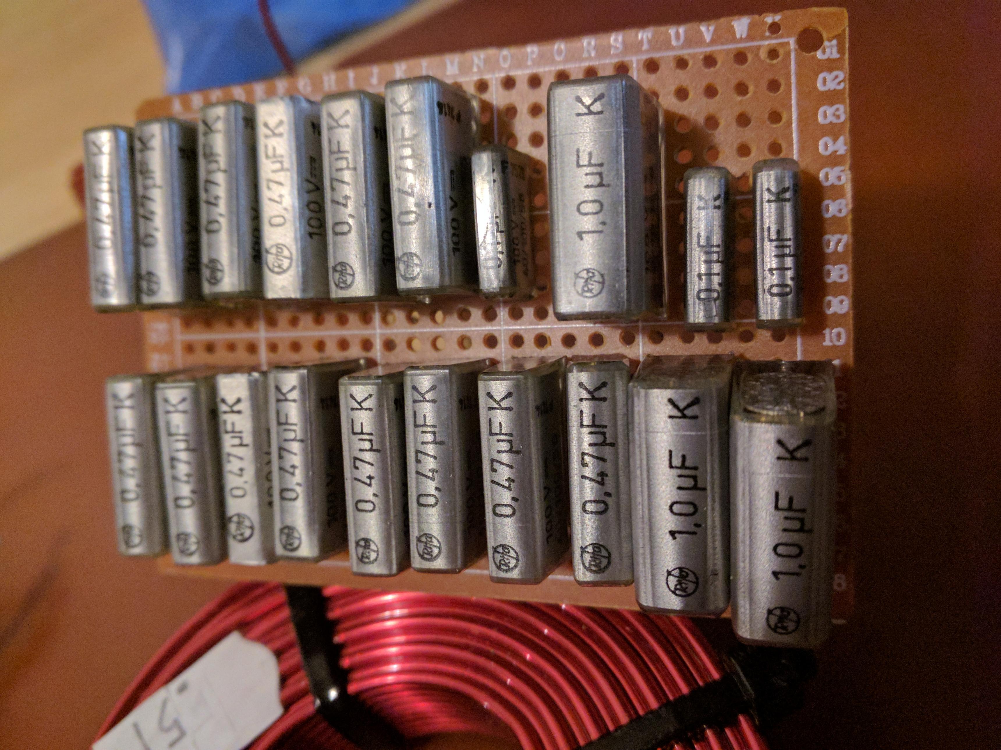

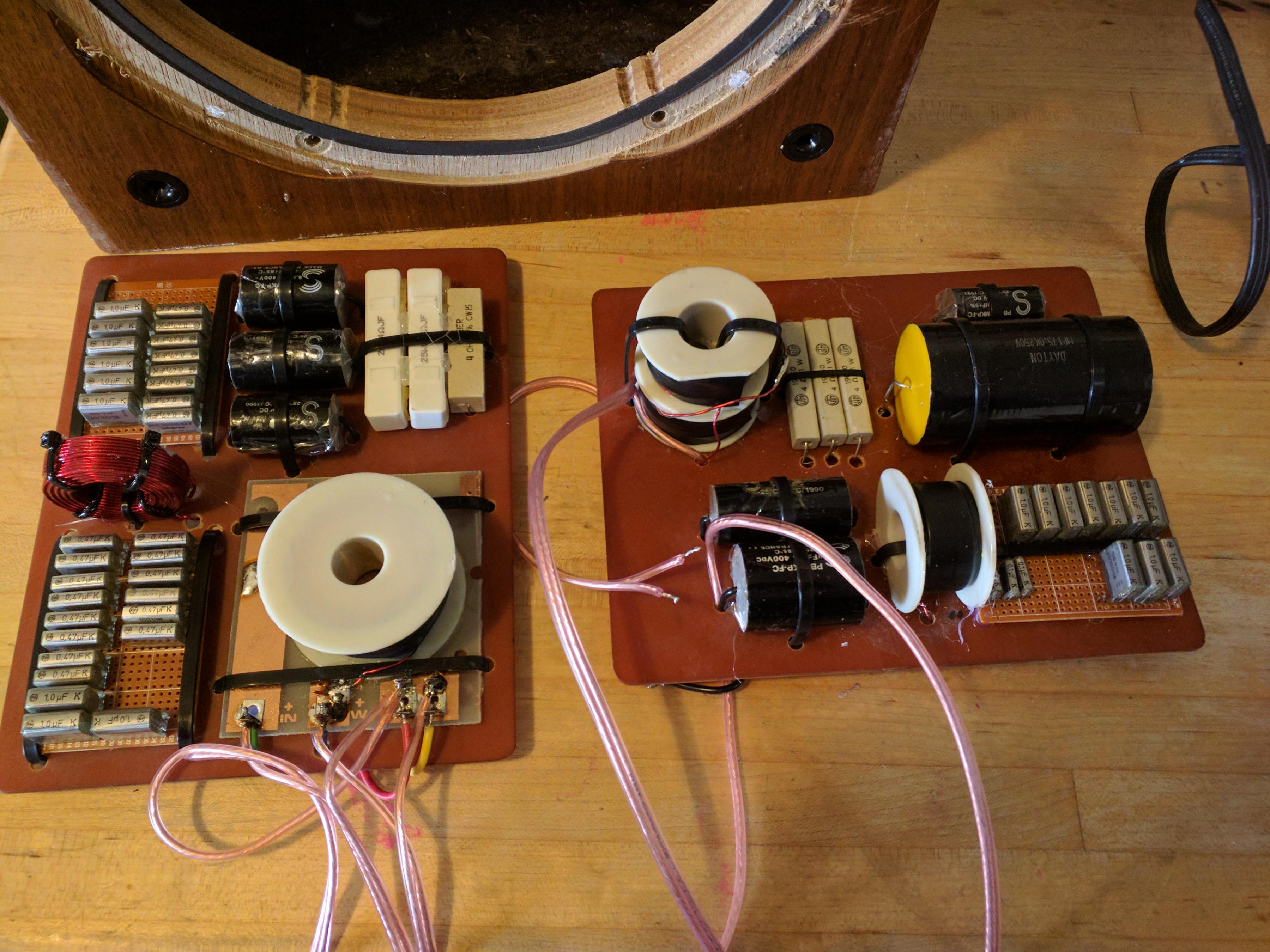

Any one know how these vintage rifa caps sound?
I believe they are metalized paper

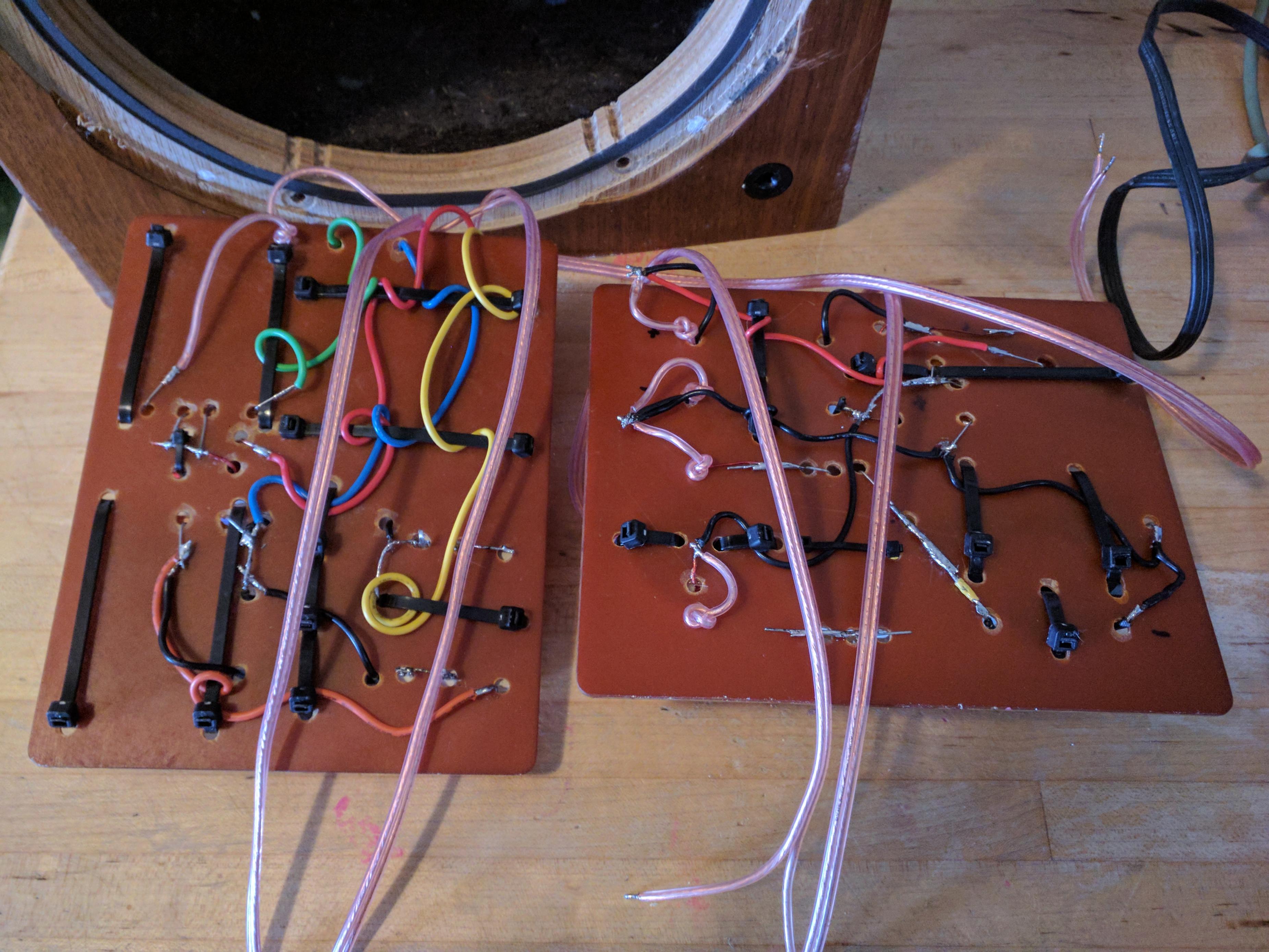

Pic is of the tweeter section
Oops it has the wrong caps (0.1uF); suppose to be 0.01uF but I won't use those anyway probably
Guess I will listen to them, but I'm not sure I have a golden ear
Turns out I have a 19 gauge or .91 mm diameter .5 mH inductor and a 14-16 gauge also I think
Hold them to your ear. I'm pretty sure they're as silent as any other capacitors.

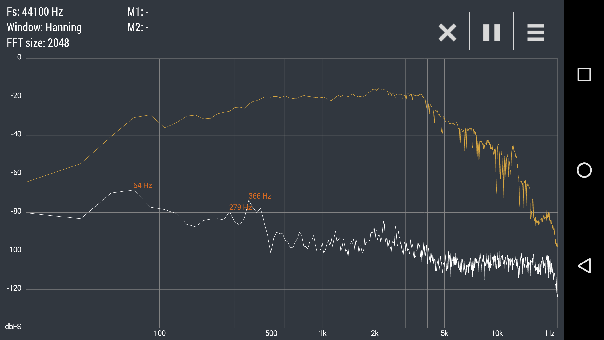

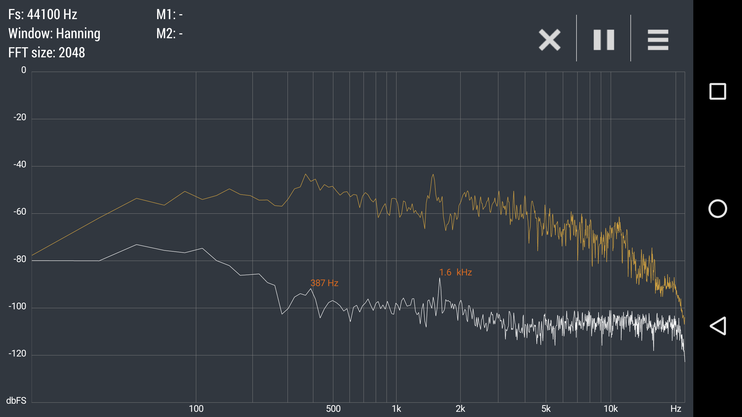

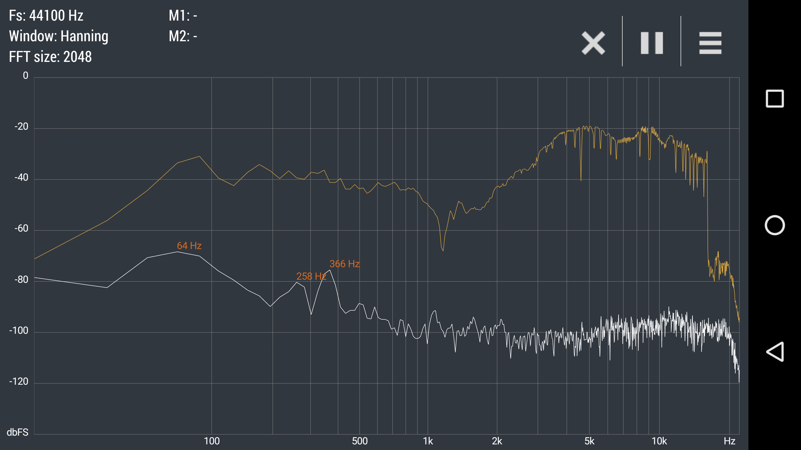

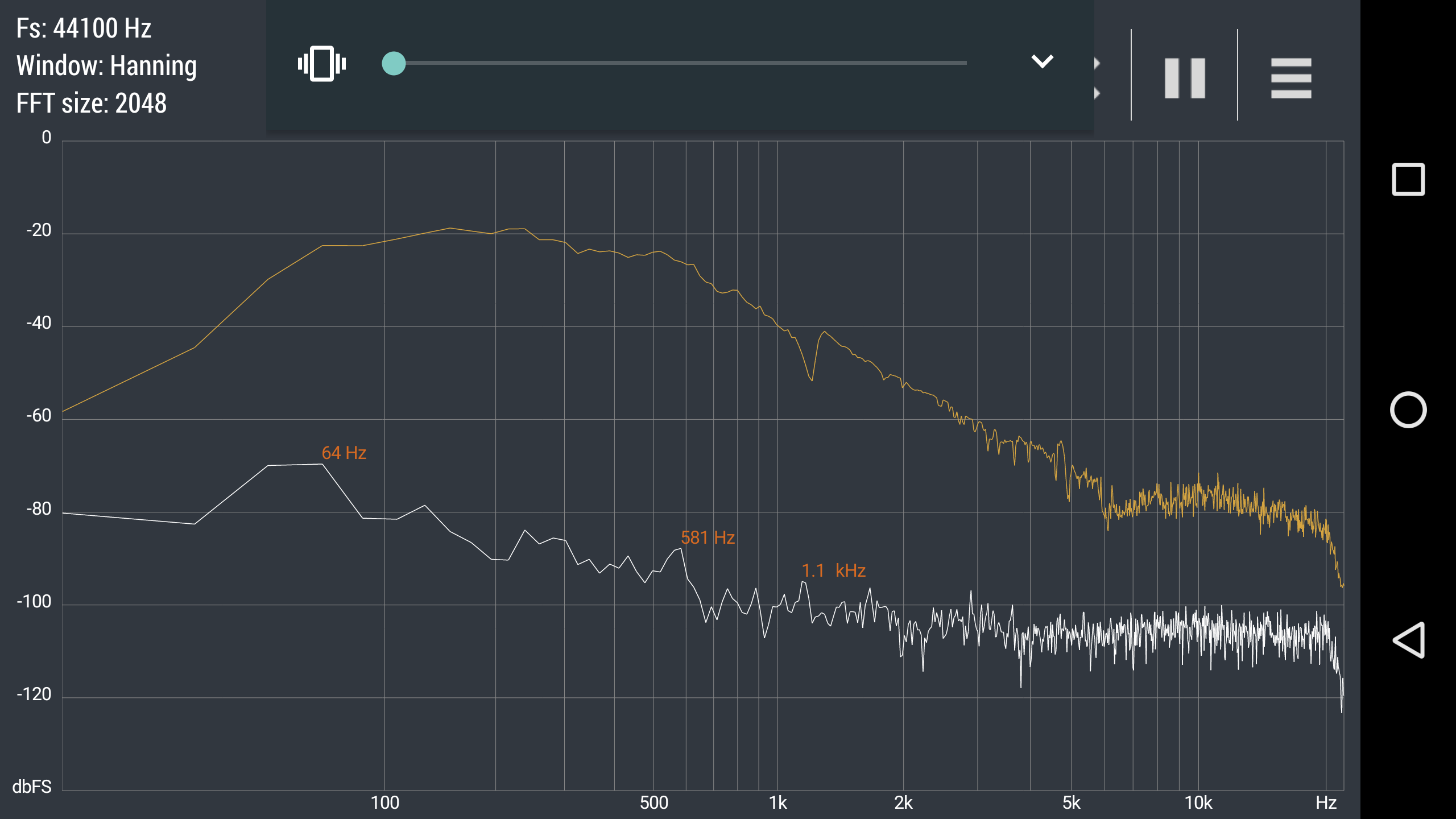

Took some measurement with old x-over, one with tweeter off and one with midrange off and one with tweeter and mid off
Mic was about 1.5 cm from the front of the mid/tweeter, woofer was about 3cm away
Woofer I could not turn of without opening box, so I skipped that

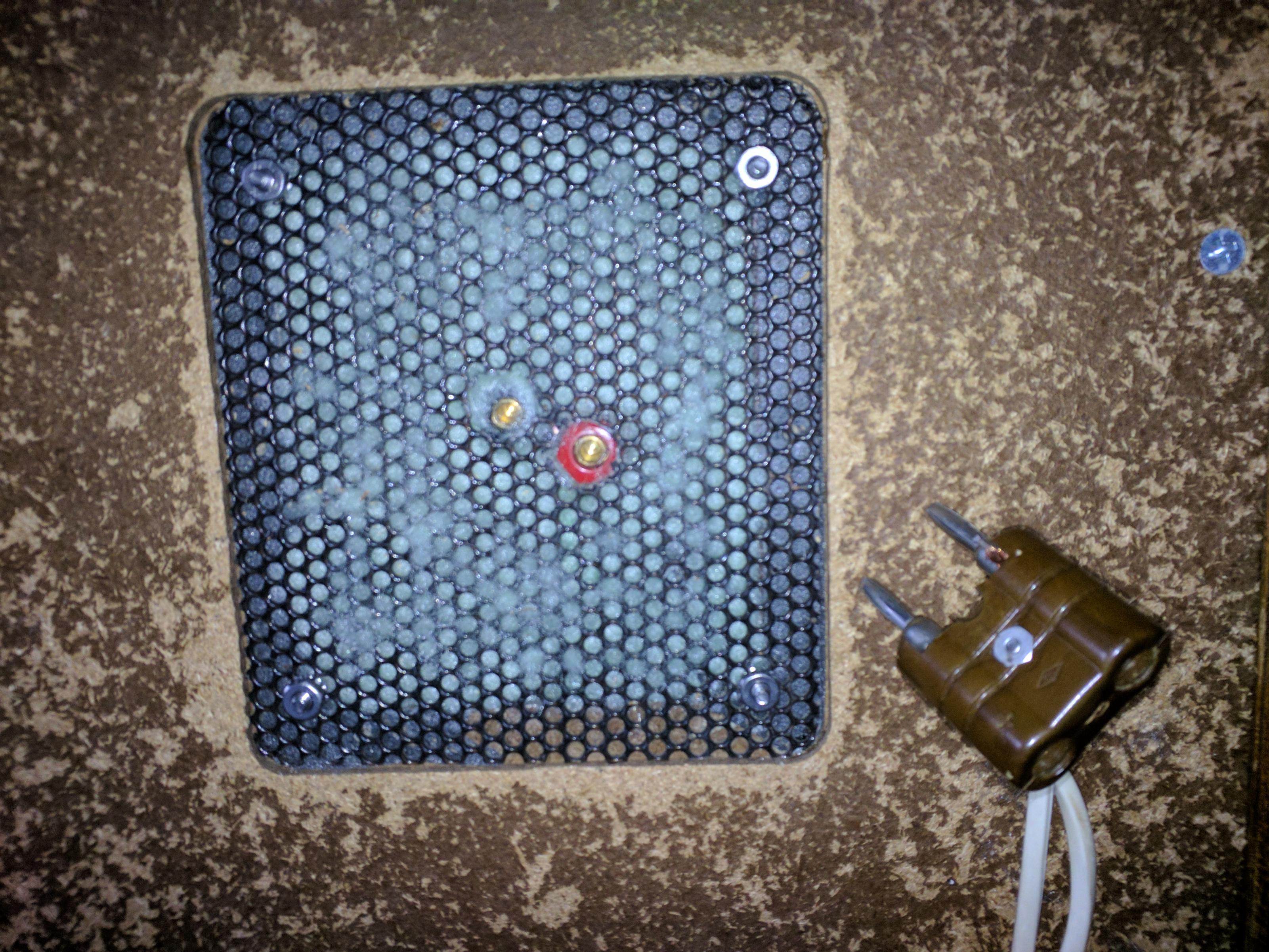

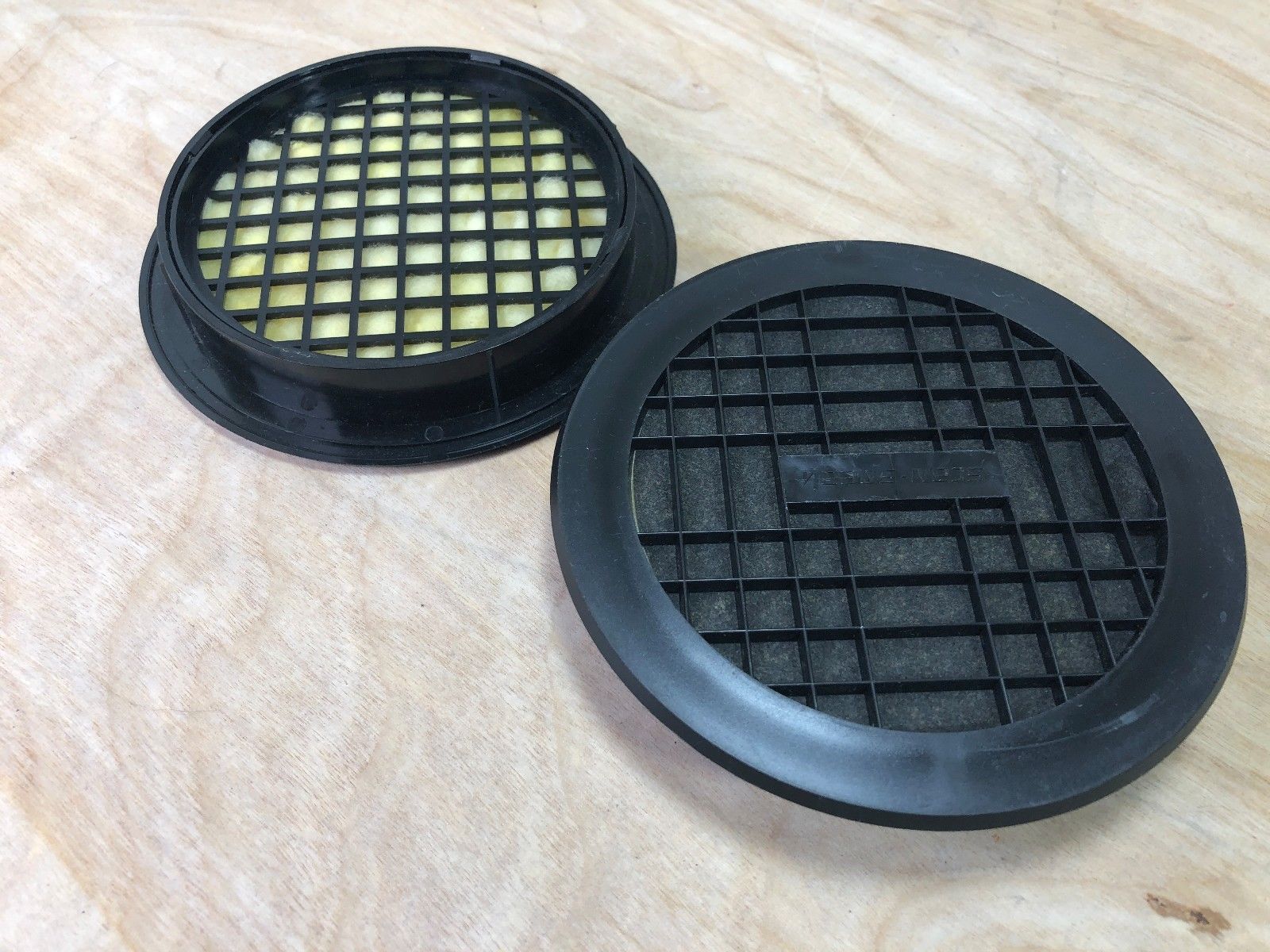

Aperiodic vent sounds better
Feel like the speakers are hissing at me, especially with human voice making "s" sound; but happens on my computer speakers too and speakers I had before
I mostly listen to youtube, mp3, mp4, other compressed audio
Can't play any FLAC files, so far
Included pic of Scanspeak aperiodic vent
I built a speaker with that before, Eton 8-800, excellent fast/tight bass
Seems as though you can compress fiberglass (or something else, I don't use fiberglass) to about 25% of it's original starting thickness as a good starting point
I used polyfill stuff between perforated sheet metal
Last pic is summed response of old cross-over where my head is, were I usually sit, I think
The scale says 20 dB on the scale, but I think it's about 10 dB, just looking at the cross-over roll off, but I really don't know
