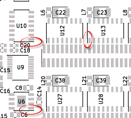

Got my boards this week and starting to assemble them now...may be this is a stupid question, but may I ask how do I know the correct chip orientation as I did not find any markings on the boards ? Can someone upload a hires picture of his assembled board in bird perspective, please ?
gtose picture above is already helpful, but you cannot see all markings on all chips.
http://puredsd.ru/mounting_plan.pdf
Each chip has its first pin labeled.
https://www.diyaudio.com/forums/attachment.php?attachmentid=766723&stc=1&d=1562430261
