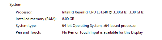

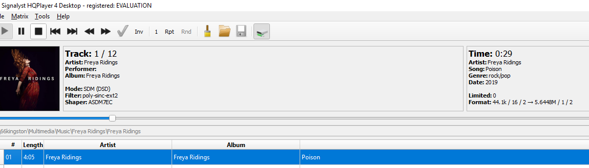

I've installed an eval copy of HQP4 on my 'den' Win10 workstation and have been listening to HQP3 & HQP4 using headphones (600ohm BeyerDynamic DT880s and 32ohm Goldring DR150s) via my Buffalo 3SE/Legato DAC (BBB/Botic/NAA and full fit of Salas Regs). SQ is really exceptionally good with HQP4 and the new EC modulators but I could only use DSD128 (CPU at around 65%), above that playback rate CPU loading was very high and consistent playback wasn't possible.
The Win10 workstation is a little long in the tooth but still no slouch, with a 3.3GHz Xeon processor benchmarking at around 9500-10,000 IIRC. I'll try HQP4 on my Music server in the next few days, using the same DAC & headphones. That's a more powerful i7 with CUDA support and running AudioLinux so ought to be a bit more capable.
Really enjoying the music with the eval copy of HQP4 using the EC modulator as per my previous post. I'm going to have to get HQP3 upgraded on my main music server and see if that gets me back to DSD256.
FYI, based on what I've learned following some HQP threads at audiophilestyle, processor clock speed is one of the keys to running EC mods with no dropouts.

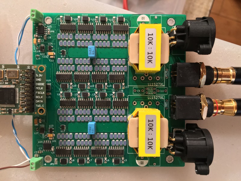

Finally I got my version of Pavels v. 2.6 working properly and with no noise.
My skills in SMD soldering leaves a lot to be desired
But I got it sorted out. No noise and great sound.
Yes, that's why I'm hopeful that my faster i7 server will do the job. That said what I'm hearing at DSD128 is marvellous.

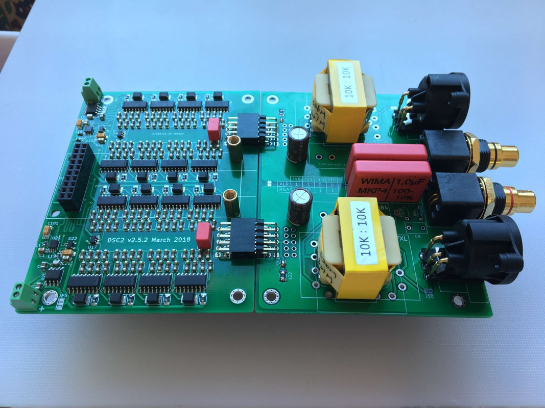

Has someone compared the DSC2 to the 2.5.2 and 2.6.2?
I'm just wondering because I currently have the DSC2 and I'm quite happy with it but thought the other day that it would be interesting to know how the other versions sound compared to the DSC2..

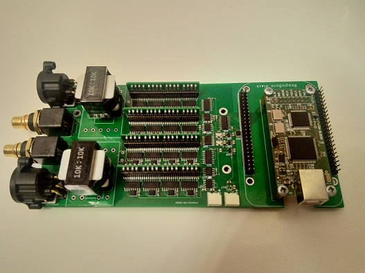

I am a little confused by the naming of the different DSC versions.
If you look at the Google drive : DSC2 2.5.2-2.6.2 – Google Drive
2.5.2 and 2.6.2 are both called DSC2.
My version is yet another DSC2. In the schematics it is called " BB/Amanero + isolator+reclocker+DSC2" . No idea what version this would be??

The "BBB/Amanero+isolator+reclocker+DSC2" is what I refered to as simply DSC2.
Have a look at https://puredsd.ru/ -here all 3 different versions are listed.
WOW!This is one project under the general name DSC2.
v2.5.2 and v2.6.2 stable versions.
ver "BBB/Amanero+isolator+reclocker+DSC2" was made in only four copies.
Therefore, it does not have a version number. On puredsd.ru, it is listed as prototype of the new version DSC2
I am then the proud owner of on of the four New DCS2´s.
Apparently, I am here referring to the Pure DSD site :PureDSD,
DSC1 are the single ended and DSC2 are the differential version.
