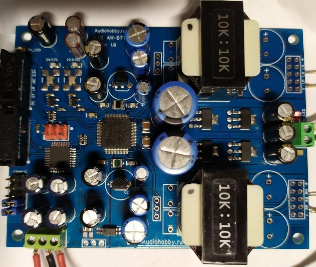

Hi all
Has anyone compared AK4490/3/7 in direct DSD mode with the same transformer output with DSC2?
Yes, the AK4497 sounds good too.

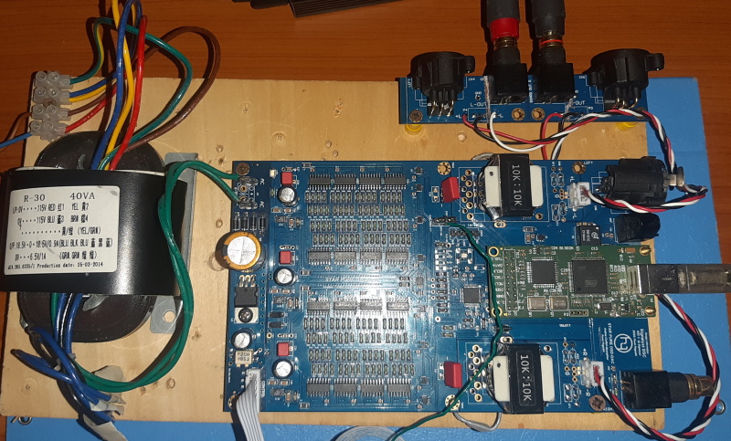

Hi all!
Andrea and me have new design dac with input Ct7302,
Please see some . Thanks

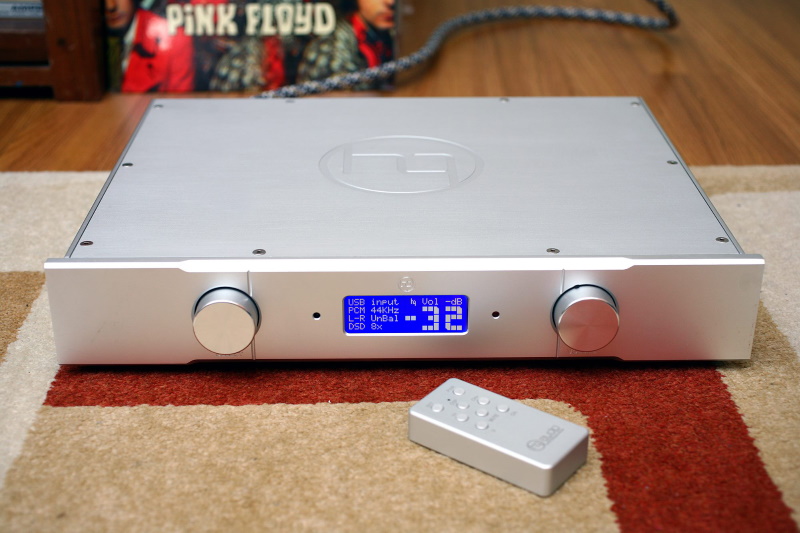

STAR Pure DSD DAC
1 x Star Pure DSD DAC module
1 x Controller LCD module
1 x XLR and RCA output module
1 x Silver remote
This not include Amanero USB module (you can buy directly) and this not include 6.5V 20VA transformer.

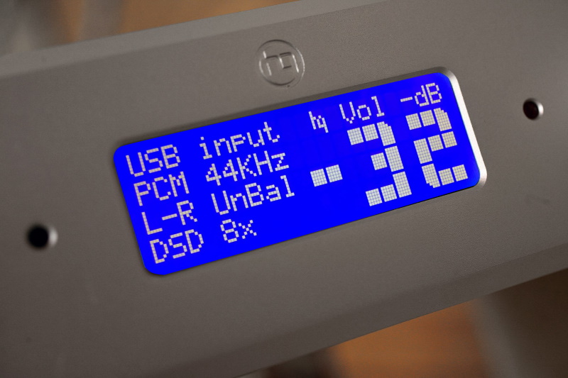

This project here exposed has another approach, it is based on the DSC1 that is an Open Hardware, "discrete" delta-sigma D/A-converter developped by Signalyst, the DSC1 is able to convert the DSD signal to analog without noise and without a DAC chip.
The DSC converters does not work with a PCM signal so it is necesary convert the PCM to DSD on the fly during playing so it is necessary to use computers with adequate performance.
In this project we have used the CT7302PL single chip dual channel audio digital to digital bridge with a sample rate converter to convert PCM signals to DSD.

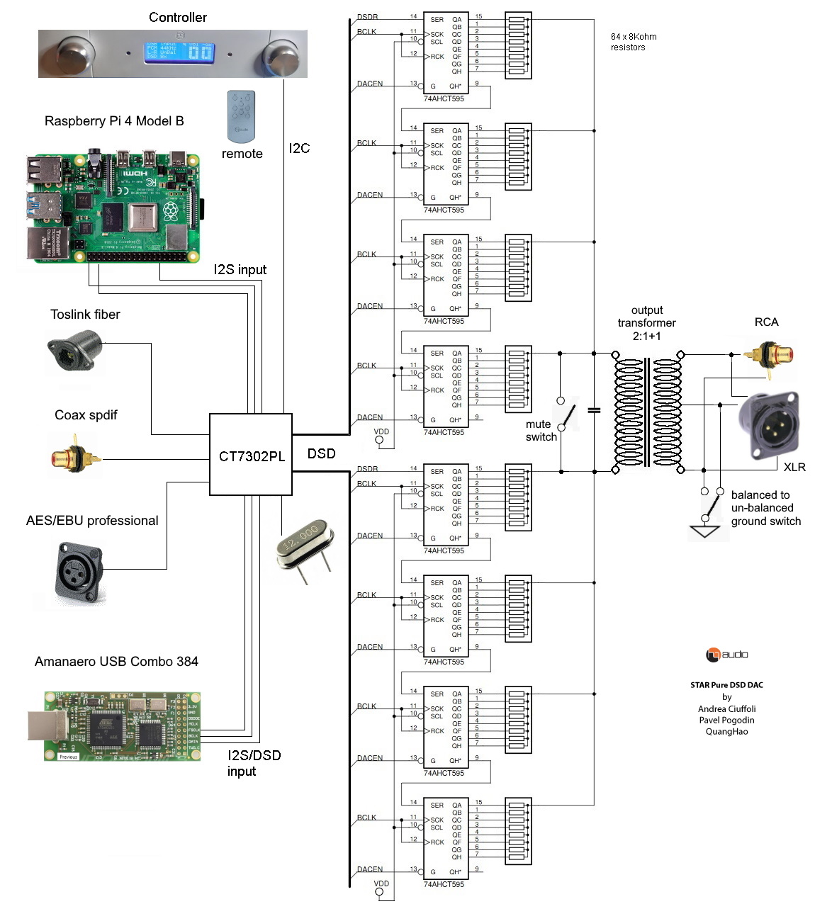

HARDWARE
The core of this design is the CT7302PL with the following specifications:
SPDIF support up to 768 KHz/32bits mode
I2S support up to 768 KHz/32bits mode
DSD support 1x/2x/4x/8xmode
DoP support 1x/2x/4x mode,throughI2S
DoP support 1x/2x/4xmode, through SPDIF
PCM SRC / ASRC fully support 32 KHz~ 768 KHz.
PCM / DSD / DoP to PCM / DSD / DoP converter with SRC / ASRC
Crystal reference clock / MCLK / DoP / Mute status output

After the CT7302PL chip there is the DSC in the differential version designed by Pavel Pogodin with the output transformers to filter and to convert the output in un-balanced and balanced signal.
The 74AHCT595 are high-speed Si-gate CMOS devices used for the serial-to-parallel data conversion.
This module use a mute circuit to eliminate any click in the transition from one track to another using the TS5A3167 (SPDT) single-pole double-throw analogswitch .

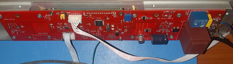

The Controller module included in the kit use the 16F877 chip, a 20MHz Enhanced 8K Flash Microcontrollers.
It drive a 4 x20 characters LCD and it is connected with the I2C bus to the CT7302PL.
A separeted power transformer is used to manage the standby function.
OUTPUT TRANSFORMERS
The output transformers are necessary to mix the differential signals coming from the 74AHCT595 in phase and out phase.
These are also used to give un-balanced and balanced output signal, the module integrate a relay to switch the ground connection.

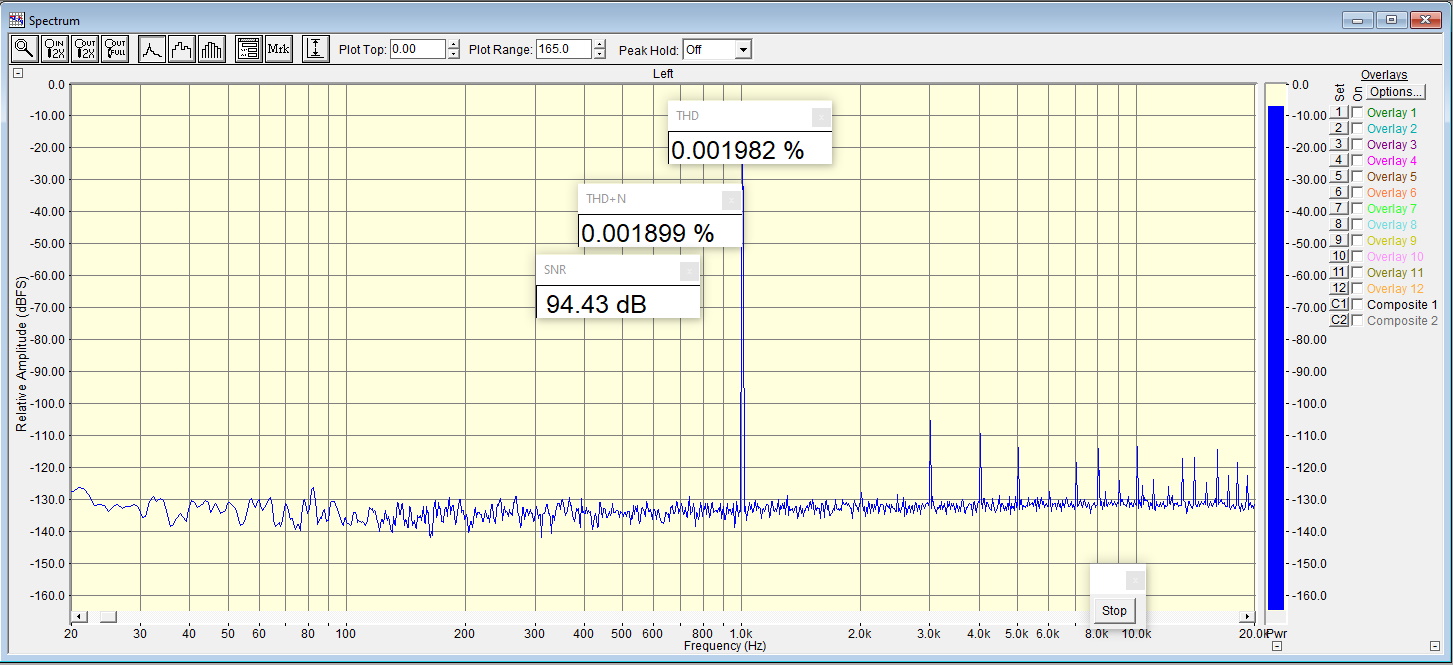

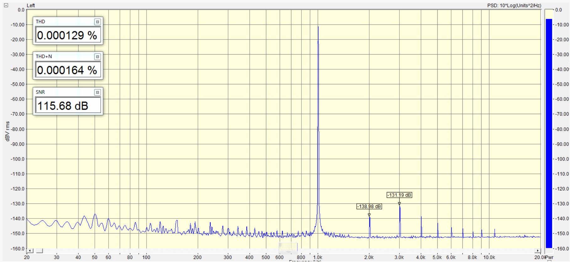

MEASUREMENTS
Output at 0dB near to 1.5Vrms.

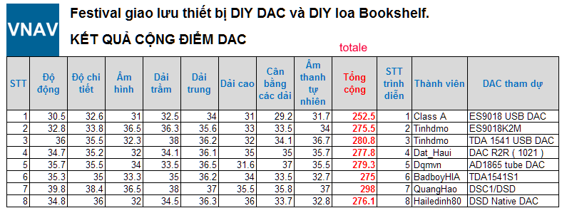

STAR DSC took first place in the contest organized by the forum Vnav
