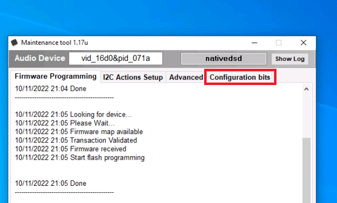

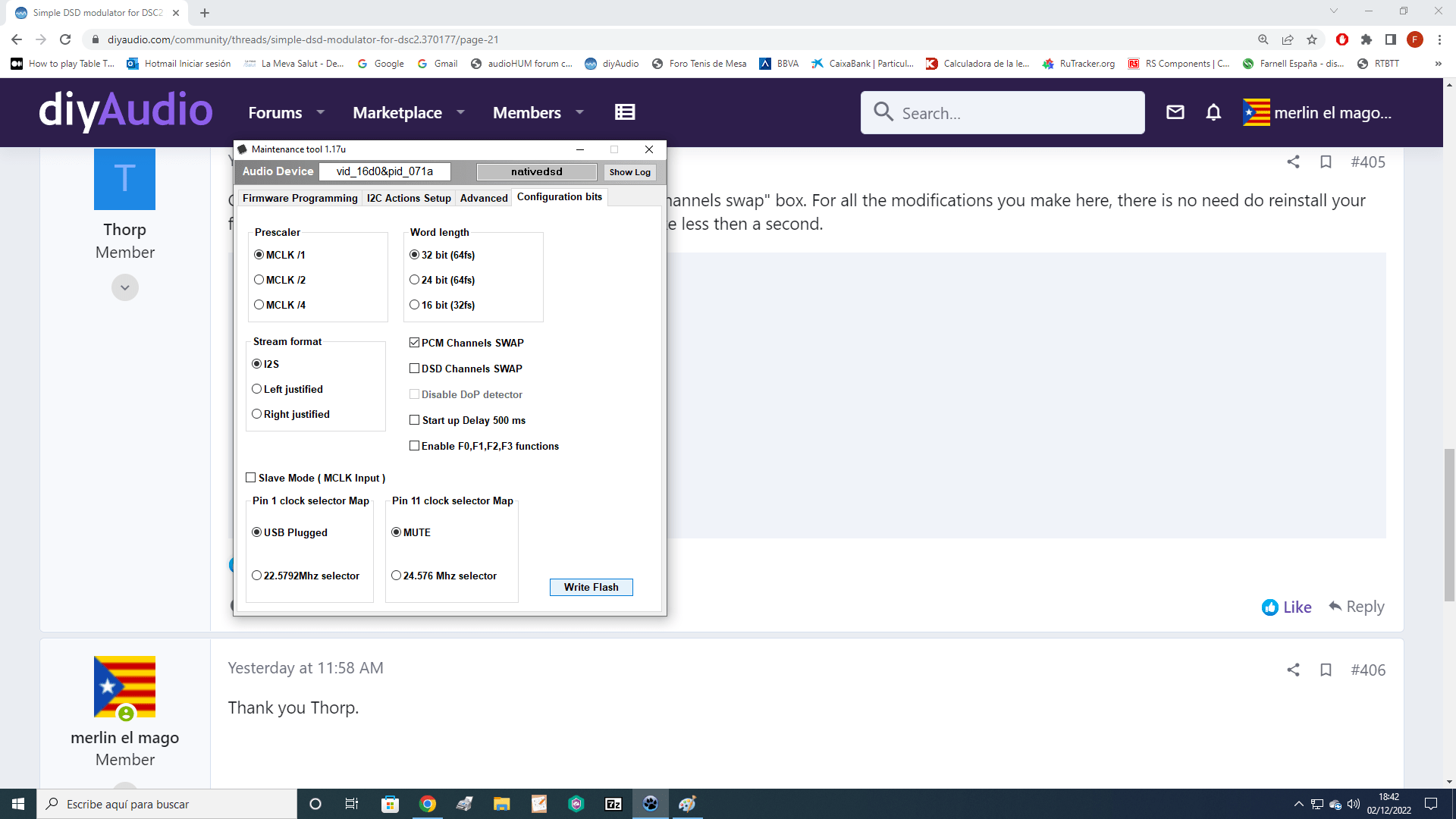

Use oemtool 1.17, you can download it from Amanero site.

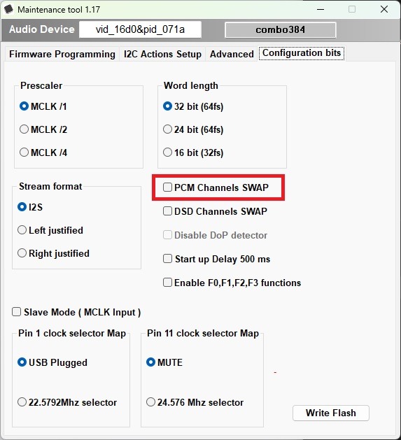

Go then to the "Configuration bits" tab and check "PCM Channels swap" box. For all the modifications you make here, there is no need do reinstall your favorite firmware, but only to press "Write Flash". It will take less then a second.
Reactions: 1 user

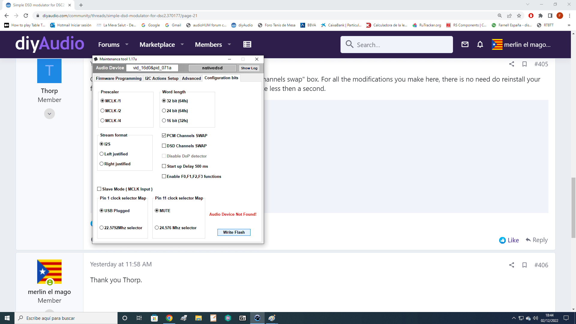

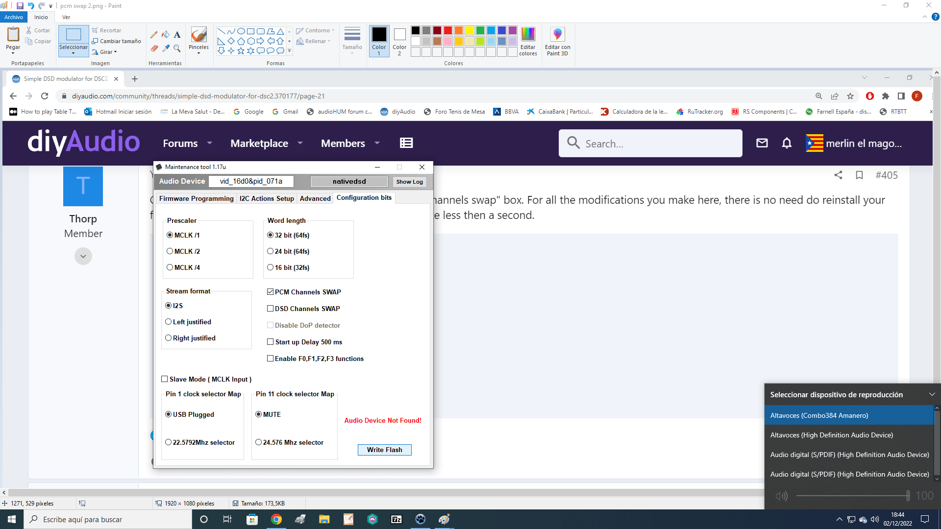

Doesn't works, are you sure that don't need to erase the flash & re-install again?

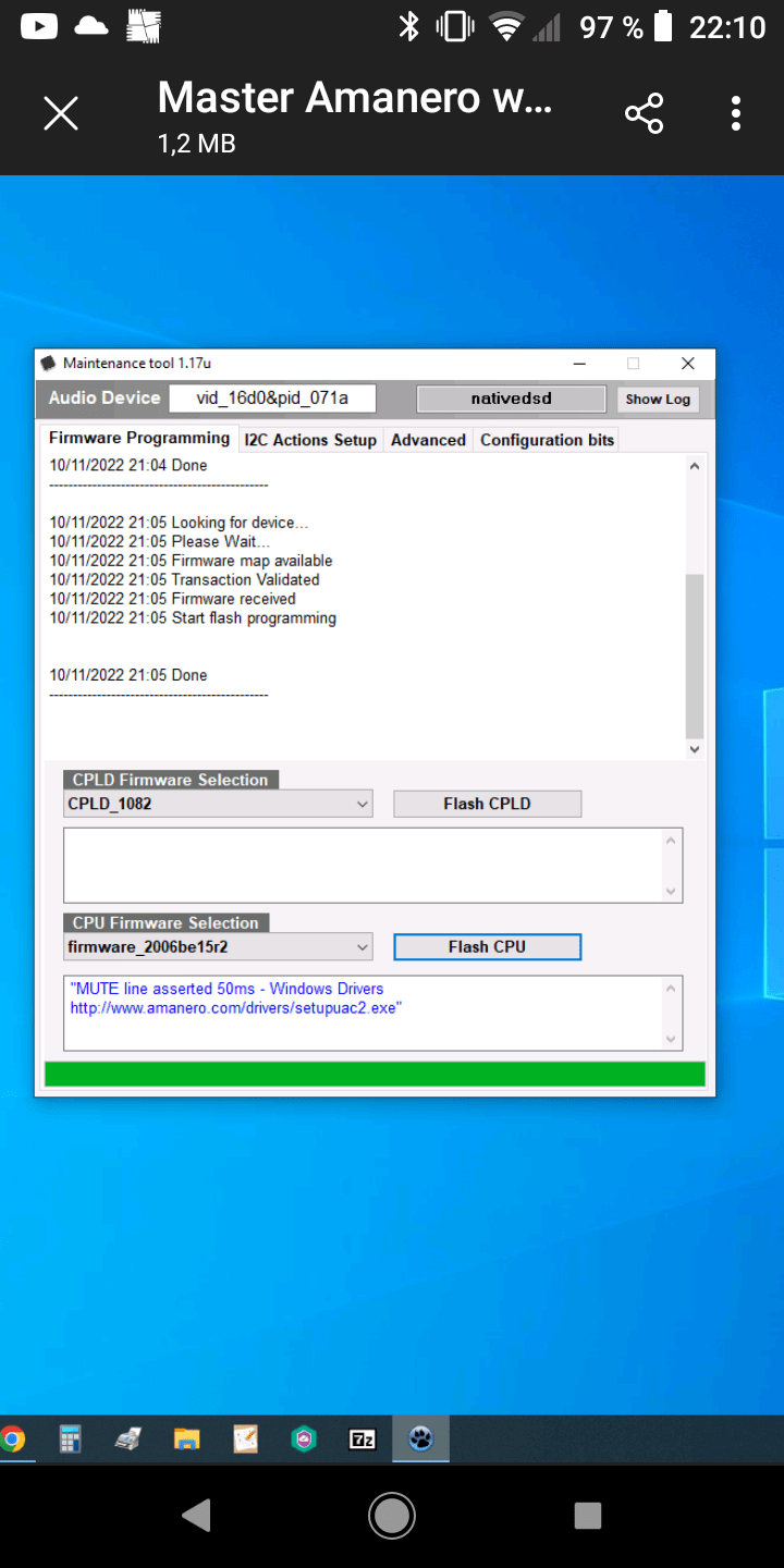

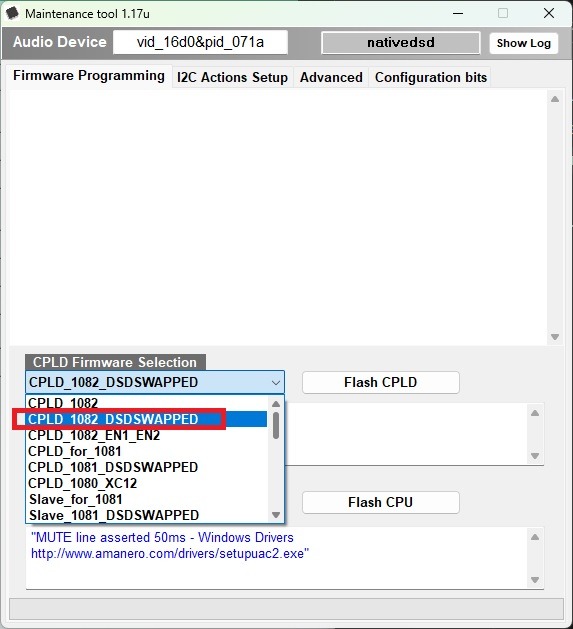

It should work, but maybe your board is different. As I can see, it has an oemid = "nativedsd", which is different than my board "combo384".
Even if you reinstall the firmware, you still have to modify "Configuration Bits" pressing Write Flash.
In this case, I would reccomend you to re-flash your firmware using DSDSWAP version for CPLD, so it will bring DSD channels in phase with PCM ones, and after that you can swap the wires inside - or outside - your DAC.
Joined 2009
Thanks Thorp
Just received advice from Dom (Amanero). "swappare i canali dsd usa cpld slave 1081 dsdswapped"
Doing that would swap DSD channels only if DSD was sent from your PC, such as if you were using HQ Player to software convert PCM to DSD.
Thorp was correct in advising you to swap PCM channels since in this case PCM will be converted to DSD by Simple DSD Modulator only after passing through Amanero as PCM. Does that make sense?
Joined 2009
No, Dom (Amanero) is right, I'm just listening PCM converted to DSD with the Simple DSD Modulator and LPF and now the channels are OK. For sure Amanero doesn't convert pcm to dsd.....

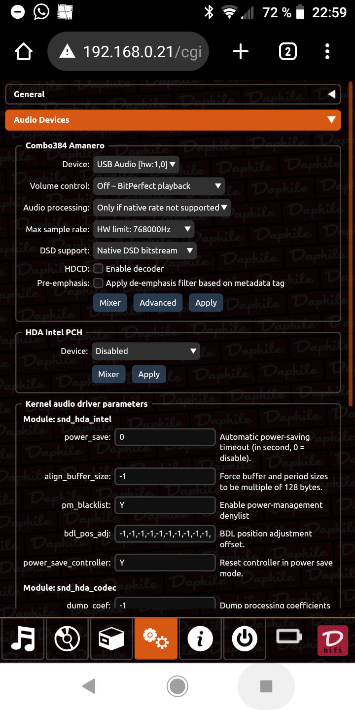

I'm using Daphile without PCM to DSD converter
