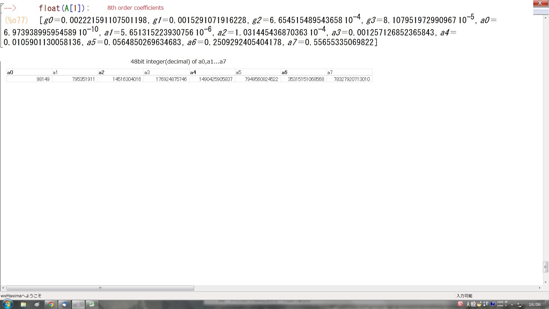

I can't believe 17th-order DSM exists in the real world. Even 8th order is huge enough to require 48-bit calculation. If 17th-order exists on the planet, it may be in the Jurassic world, IMO. 17th-order probably needs 112-bit calculation. What you can get from 17th-order is an enormous waste of resources and incredible out-of-band noise. A possible theoretical solution means something other than a cool one.

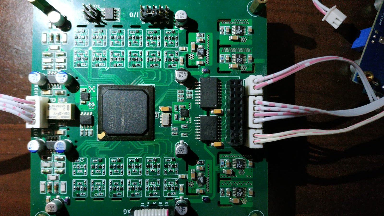

I have made 24 taps version of your discrete DSM DAc, using IntelAltera Cyclone IV chip, and the first results are very promising - no measurements yet, but a few hours of listening music. This is the first prototype, I already found some small PCB routing mistakes, but it still sounds good to me.

Your attached pic is fantastic. Each driving trace looks the same length. But is it possible to convert the code for xc6slx to Cyclone?

Thanks! Yes, they are the same length, all 48 taps differential traces (the other 24 taps are on the bottom side of PCB).Your attached pic is fantastic. Each driving trace looks the same length. But is it possible to convert the code for xc6slx to Cyclone?
I had no code for spartan to convert, I even don't know if it is possible, so I had to make it from scratch for cyclone.

Yes, it's challenging to install a 2-channel DSM into xc6slx9. My first attempt was xc6slx25. The most crucial one is not the number of multipliers but fast carry adders, IMO. The multipliers are easy to count, but fast carry adders are unpredictable. You can't know the result until Place & route finishes. 80% usage is the max, in my experience. My strategy is time-multiplexing to make the best of it. Two times multiplexing is easy to implement. Even four times is possible with a 100MHz clock.I am affraid that would be a big challange, as I am still a beginer in the FPGA field. EP4CE40 is "easy" to work with, because it is huge compared to XC6SLX9!
Another one is a fixed-coefficient multiplier; some of the multiplication for DSM is done between fixed coefficient and variable one. Minimizing resources is old-school technology because you have a large FPGA at a low cost. But for a DIYer, the lost technology is still interesting.
