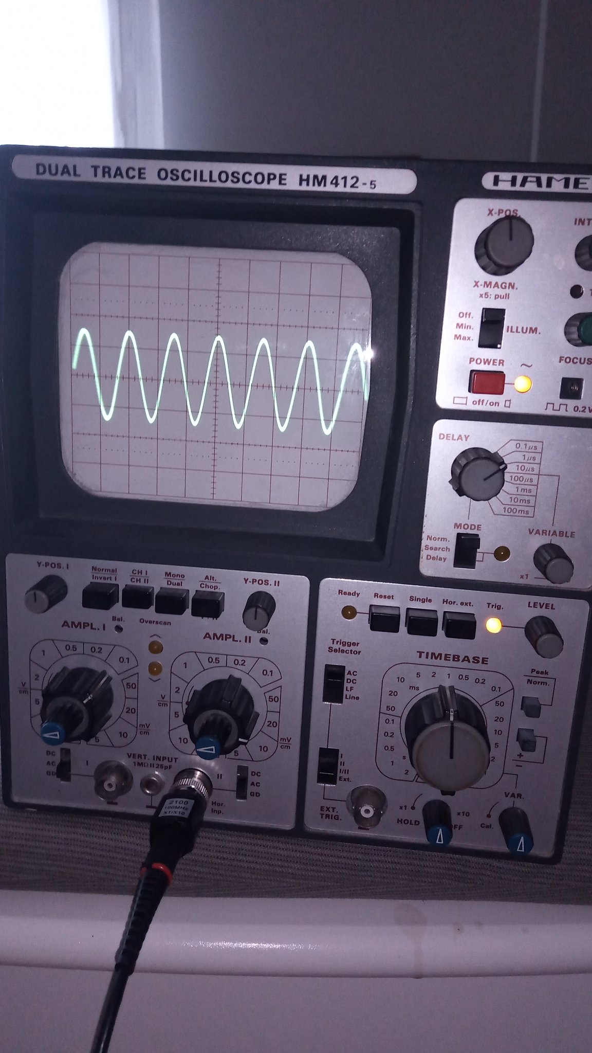

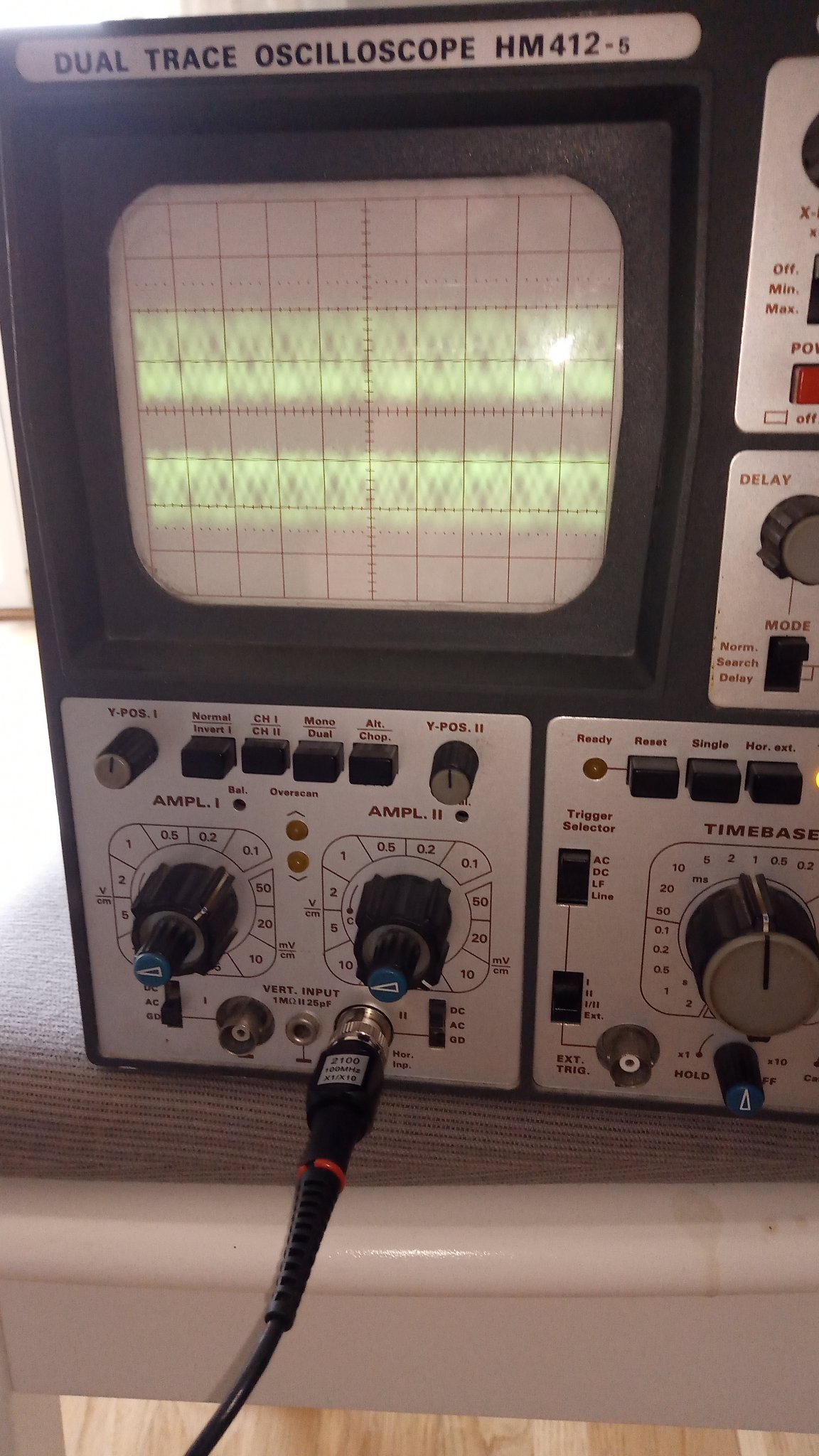

I made some measurements in order to know the real Vrms output of pcm2dsd, scope 1kHz 0dBfs 128DSD file, probe x10, scope set to 10mV/cm & 5mS.
That appears to be a 20MHz bandwidth scope, is that correct? If so, the DSD Converter is clocked at 22/24MHz. In order the the converter output signals to look approximately square, the scope and probe combined bandwidth should extend to at least 3 times the clock frequency. Better yet if it extends to 5 times the clock frequency. Also, probe capacitance and ground lead inductance can affect the actual signals being measured and or the waveform appearance on the scope. If you really mean you are trying to measure the Vrms output of the DSD Converter then you may have a problem.
OTOH if you are trying to measure the Vrms output of your DAC that's not quite the same thing. The scope might show the analog audio output signal level more or less correctly, particularly so if the DAC output is LP filtered to suppress RF and only leave audio band frequencies.

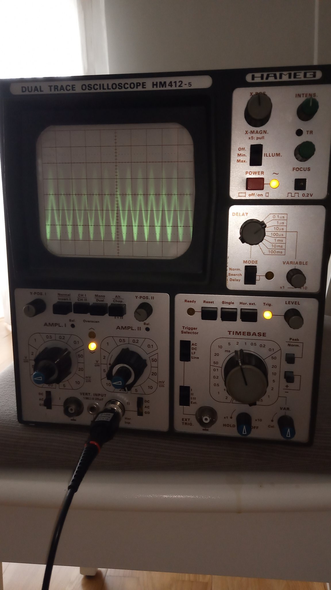

Measurement after the 4th order LPF (deleted the other post because the gain setting was DC position in place of AC), it seems 60mVpp x10 probe = 600mVpp / 2.828 = 0.212Vrms??? I'm not sure if I do well the maths it seems a very low value.
