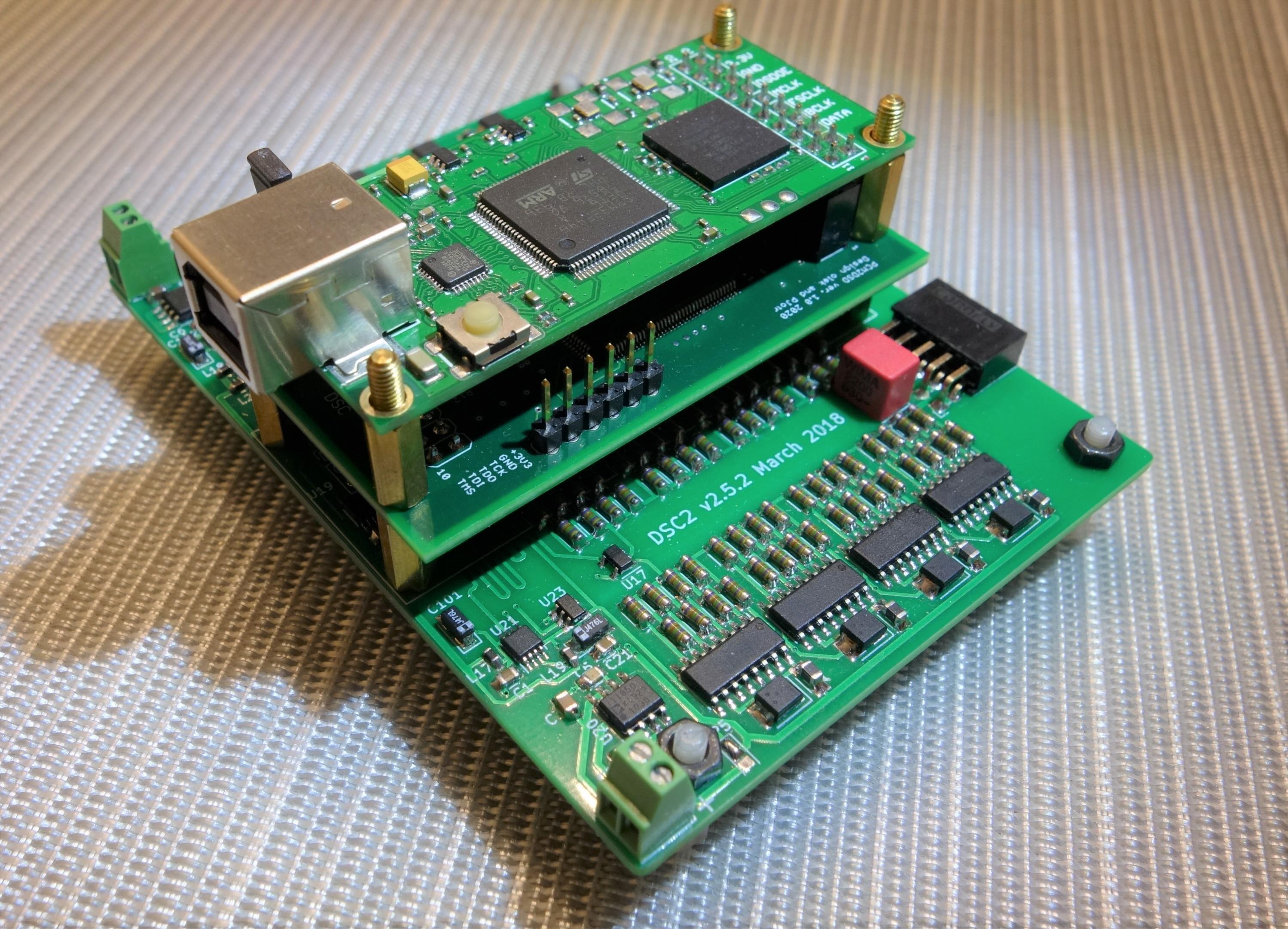

my current DSD chain is proven and tested for almost 2 years now.
hqp in DSD (SDM) works perfectly.
And McFIFO muting works great. The mute condition is detected correctly because the source stops the dataflow when music is stoppe/paused/changed.
i don't use an Amanero, but rather a network streamer from pavel (ppy here on diya). He called "PURE" streamer. (www.puredsd.ru) as said few posts ago).
The source is Based on a beaglebone black with custom kernel that is capable of outputs i2s/dsd from gpio.
The output pinout is the same as amanero (to maintain compatibility).
Still, i don't use the MUTE signal from it. I have always used the one from the Fifo.
Indeed the Botic driver on the beaglebone when the track is Stopped... it outputs nothing.
If is possible to implement a way to detect when mute is asserted and STOP the sigmadelta on the output I (and i guess, others) will appreciate that.

Sure it works... No doubt.
I was just asking about a possible adaptation/modification to the firmware to better suit a different use case scenario...
That's all...![]()

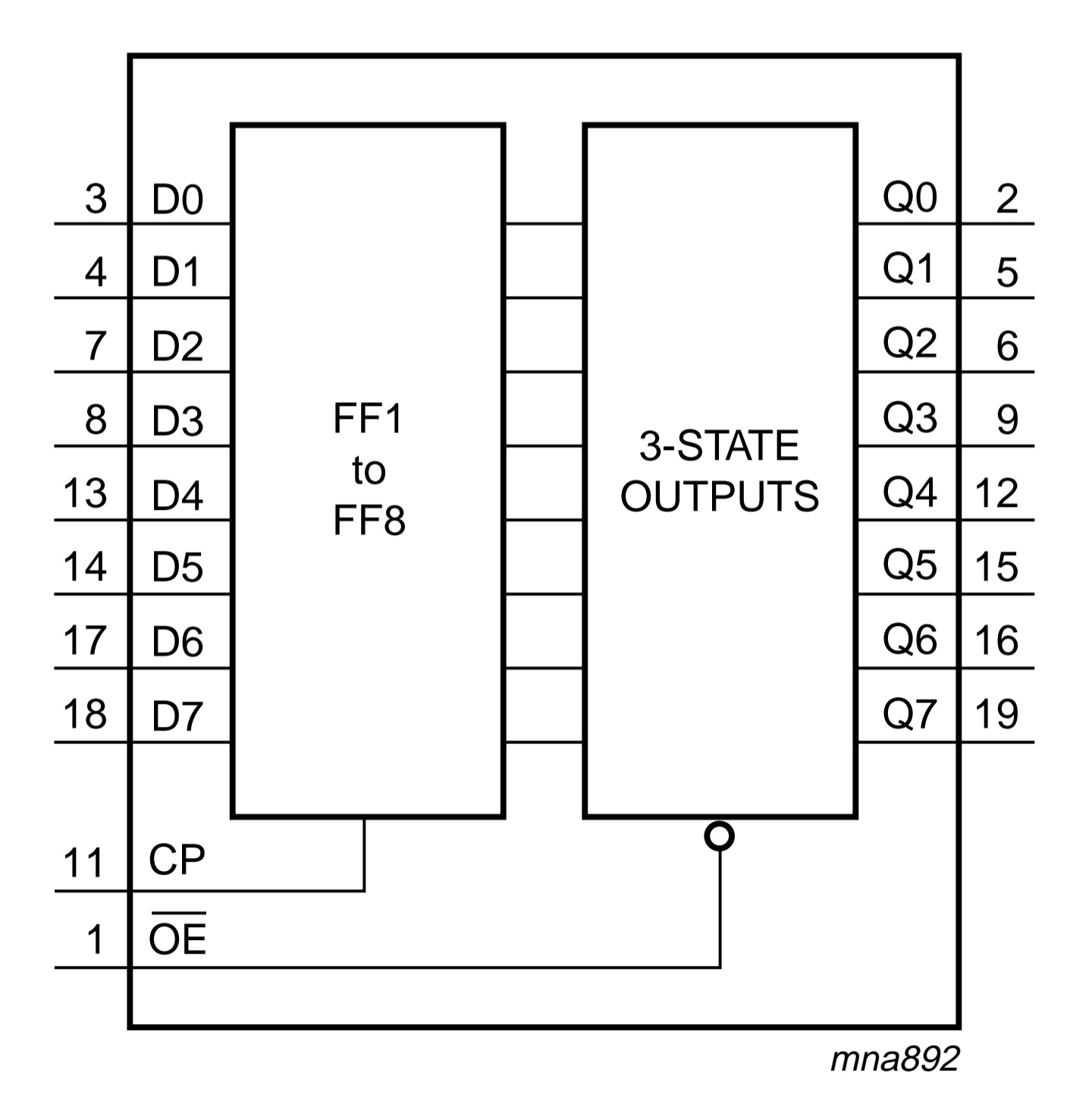

You can the try 74AHCT374 hardware at behind side of PCM2DSD with Pin11 for MCLK, and Pin-1 for Mute.

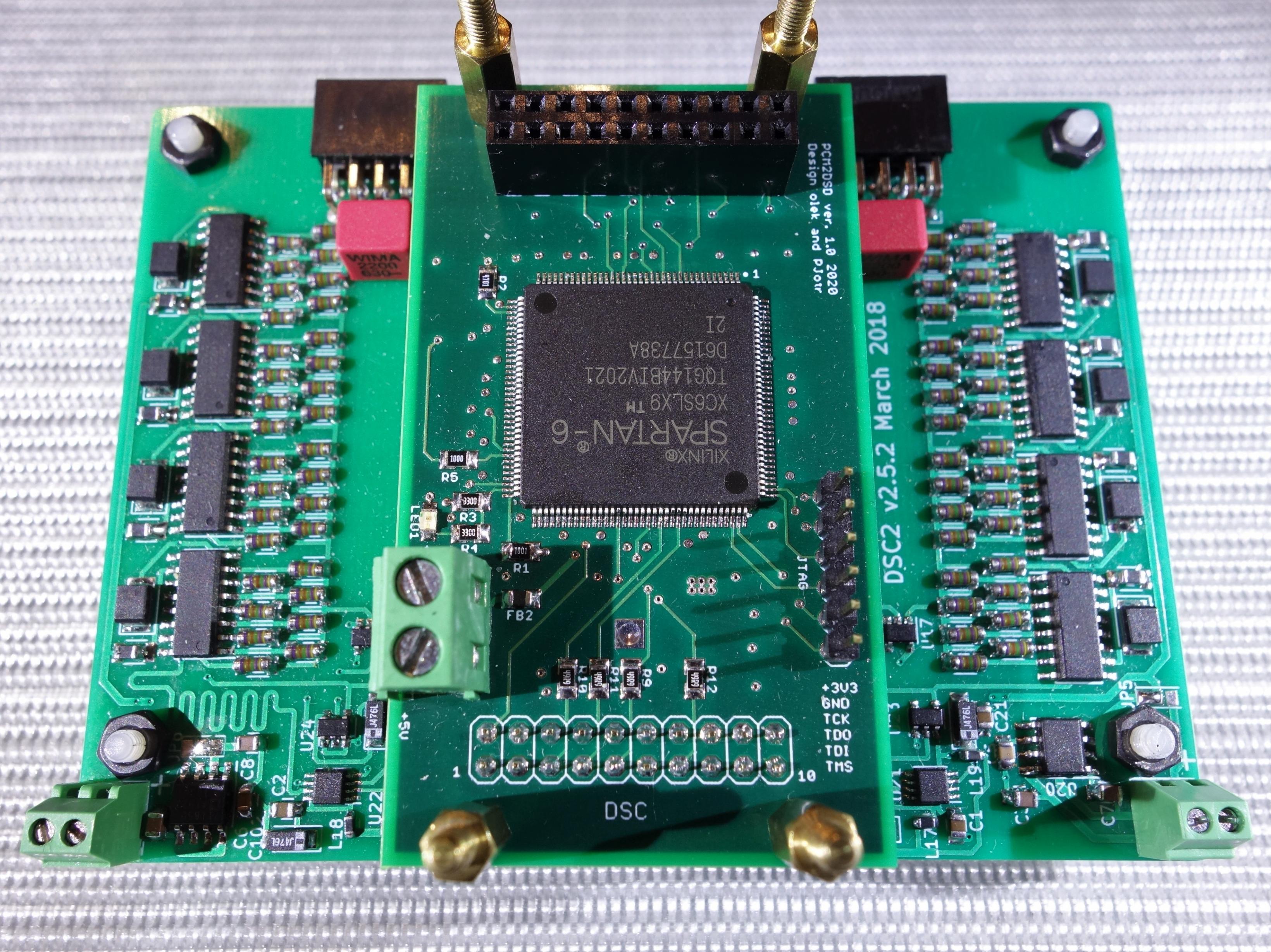

I don't have a complete understanding of what your mute system does. I guess the mute signal from FIFO detects the signal itself, not zero, because zero in DSM doesn't have a concrete value, which depends on the modulator(if PCM, zero is always 0). The absence of pulse train on the PCM2DSD output(clock,dalaL, and dataR) is probably the trigger of the mute. The best way is to connect the mute pin to eeprom5pin or 6pin with a jumper wire to signal the mute is on to FPGA. The second is to detect zero of PCM. It's easy to detect zero of PCM, but I don't know the delay between zero of PCM and the mute signal. A trial and error are necessary.
Reply to post 88: the outputs will float during mute, which you can fix with pull-down resistors. An inverter and two or three AND gates (and no '374) should also work, assuming a high level at MUTE means the signal has to be muted and assuming the mute signal doesn't need to be stretched.

DATA means Amanero-5pin. 7pin,9pin, and 11pin are always on. FPGA still has 10milisec delay memory even in 192kHz. No DSM pulse train(mute) when no data exists(zero), and regular operation when data exists are possible with some delay like Amanero's mute(4milisec delay). In other words, continuous 4milisec zero triggers no DSM pulse train(signaling mute to FIFO). This is my scenario. Is it OK?
